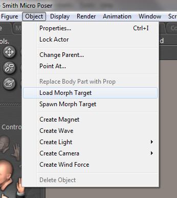

    They will only work in Poser because they were morphs spawned from Poser.  You import them back into Poser through the Load Morph Target dialogue.
    Edited to say,  I am told I am in error,  blush Morph loader Pro will load morph targets the way Poser does, but with more options.
