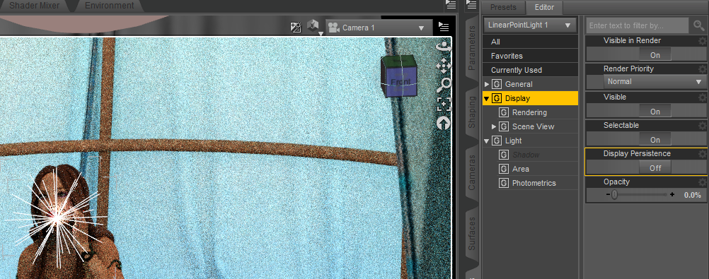

    The problem for me with photometric lights is in visualization. The little spiky thing used to represent a light in the preview bothers me.  (Bothered me in 3Delight, too, but there wasn't anything I could do about it there!) In Poser, you can make a light invisible without turning it off, which you can't do in DS.  I think that's why it bugs me so much.  Making an invisible mesh light produces the light I want without interfering with my view of the scene.  I don't doubt that you're correct in saying that a light renders faster than glowing mesh, but I've honestly never noticed a difference.  Maybe it's due to my rig or the simplicity of my scenes...?

    As I'm sure you know, the "spikey" things can be turned off by adusting Display/Opacity Scale. I don't mind that lights always show when they're on. To me that's a good thing. In shooting real-life, knowing where the lights are, and which ones are active, has always been important. I have long wished D|S had a Poser "world view" the of lights and their relative positions and colors.
    LOL, Nope -- I did not know that!!  Never even occurred to me to try that, duh. Ya learn something new every day!  Thanks for that tip!
