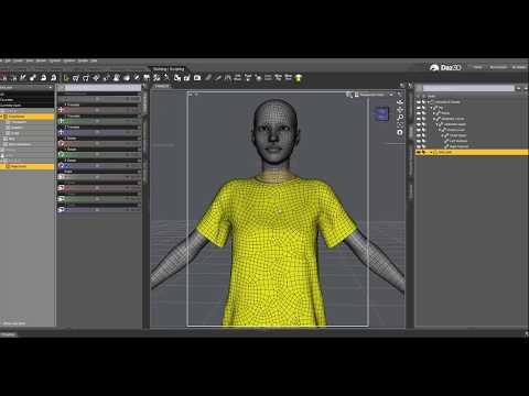

    Select the item in the scene tab, and then Create > New dForce Modifier Weight Node
    Then select the weightnode, enable weight brush, and in tool setting select the weight map. Then the clothing should become red-blue-grey and you can change the weights
    But personally I think your problem comes from the projected morph. If using timeline, try at start to dial the character out (at least till the deformation is gone) and then dial the character shape up along the timeline, e.g. at frame 15. You can do that together when posing.
    Eidt: reg. weightmaps, try to see this

    Such issue as the one described by the OP can be fixed with the Weight Brush Tool, by smoothing a bit the way vertices in the breast area are weighted to adjacent bones (Abdomen Upper, Chest Lower).
    If you're using Blender or ZBrush, this video gives another way (custom morph) to fix such issues. Could help too :
