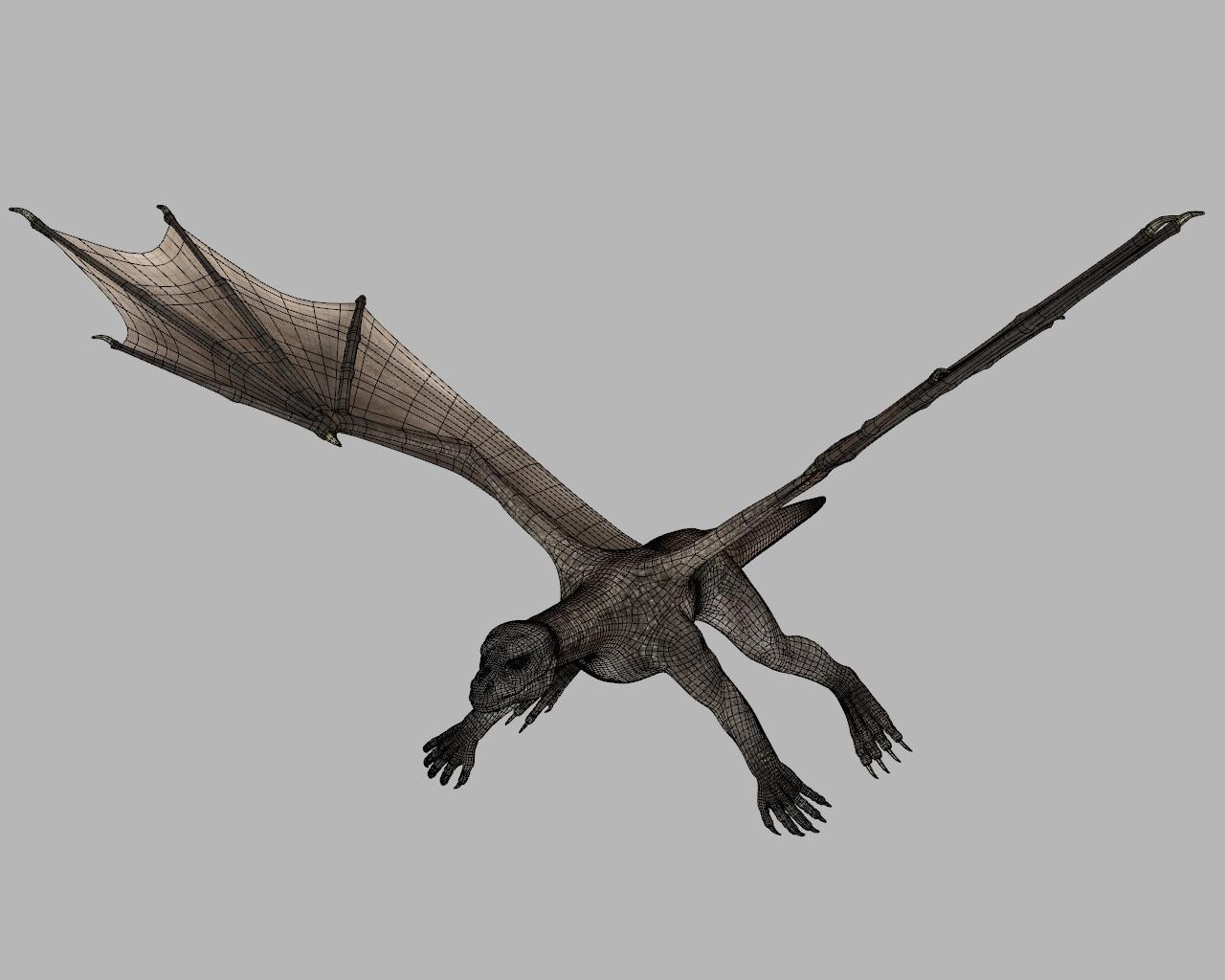

    edited February 2016
    Below is the original Daz Dragon 3. It has 50760 polygons.
    1280 x 1024 - 126K

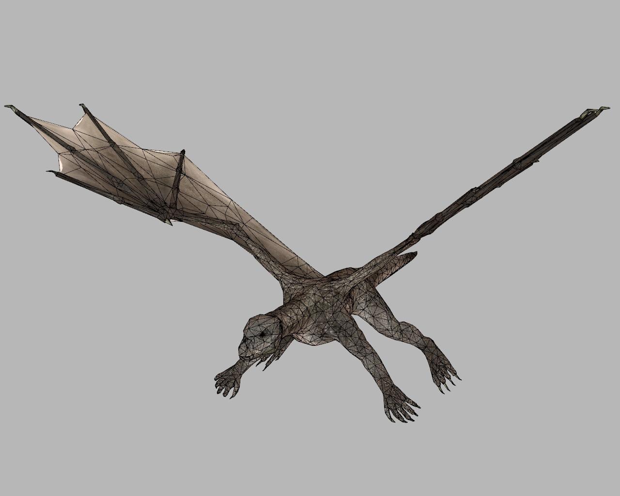

    As an example I have decimated it (in DS 4.9 beta) to 10377 polygons.
    1280 x 1024 - 127K

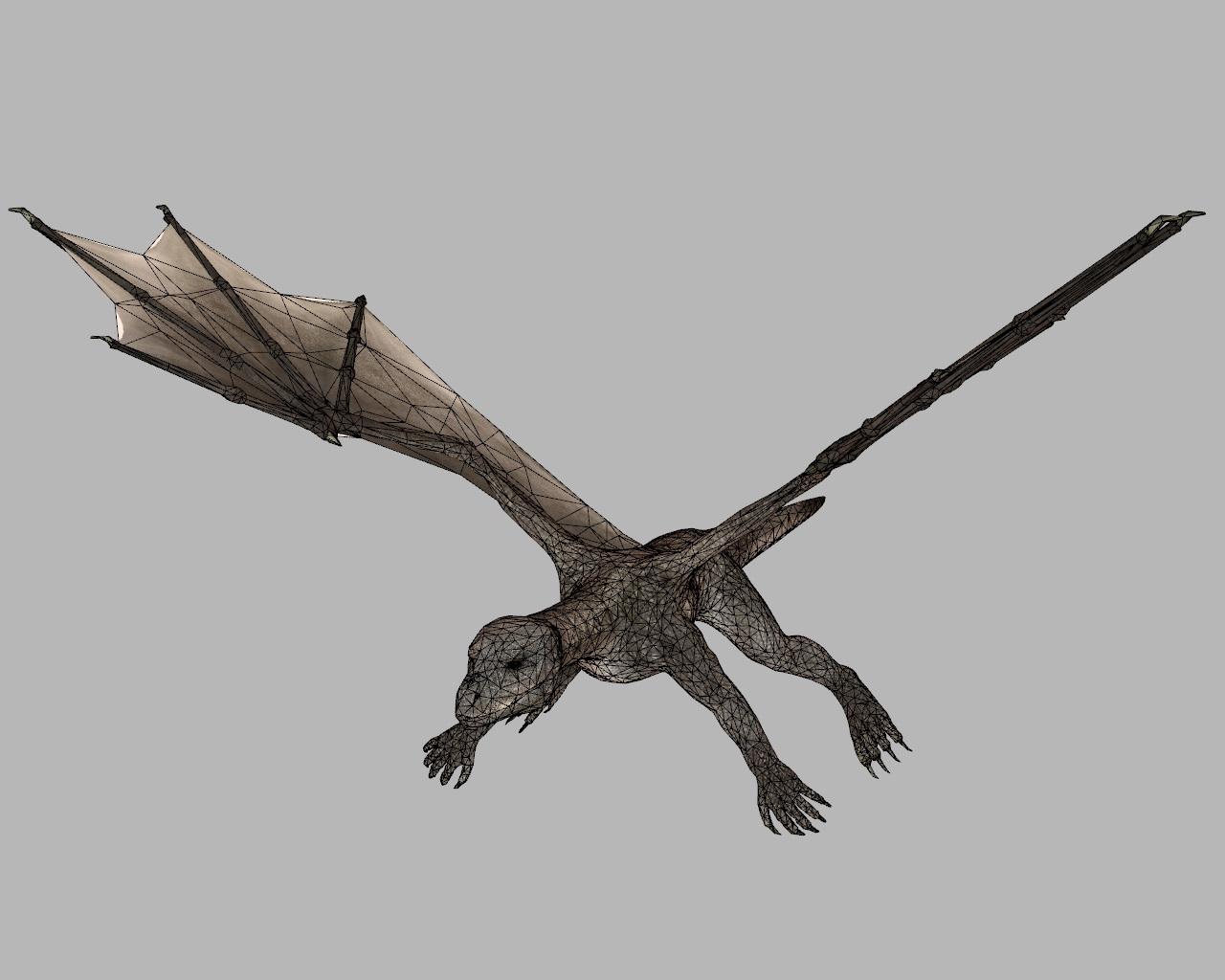

    More examples. Daz Dragon 3 decimated to 5525 polygons.
    1280 x 1024 - 125K
    Post edited by Artini on
