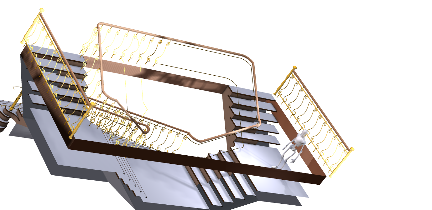

    Note:
    in the next version the exporter will be able to handle props with more than 100 child nodes
    presently you can get .obj files with names like
    myprop.cn1..cn1..cn1..cn1..cn1..cn1..cn1..cn1..cn1..cn1..cn1..cn1..cn1..cn1..cn1..cn1..cn1..cn1..cn1..cn1..cn1..cn1..cn1..cn1..cn1..cn1.cn125.obj
    when you exceed 100
    also
    the script exports the translation channels before the rotation channels, this creates disastrous results
    also
    Poser 9 and probably other versions dont allow negative scaling factors
    though in that case, all i'll do is add a warning to this effect
    in the image below the missing balustrades had non-zero Y-Rotation angles,
    since the rotation center of the prop did not follow the prop
    and the rotation was applied AFTER the translation,
    they were thrown quite far away in space
    also, there's a "doc" section at the end of the poser-prop file
    which was incomplete
    it contained an "addActor" statement for only 1 sub-prop
    instead of all the sub-props involved
    Daz Studio was happy with that situation but not Poser
    1379 x 672 - 469K
    Post edited by mCasual on
