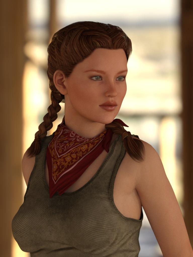

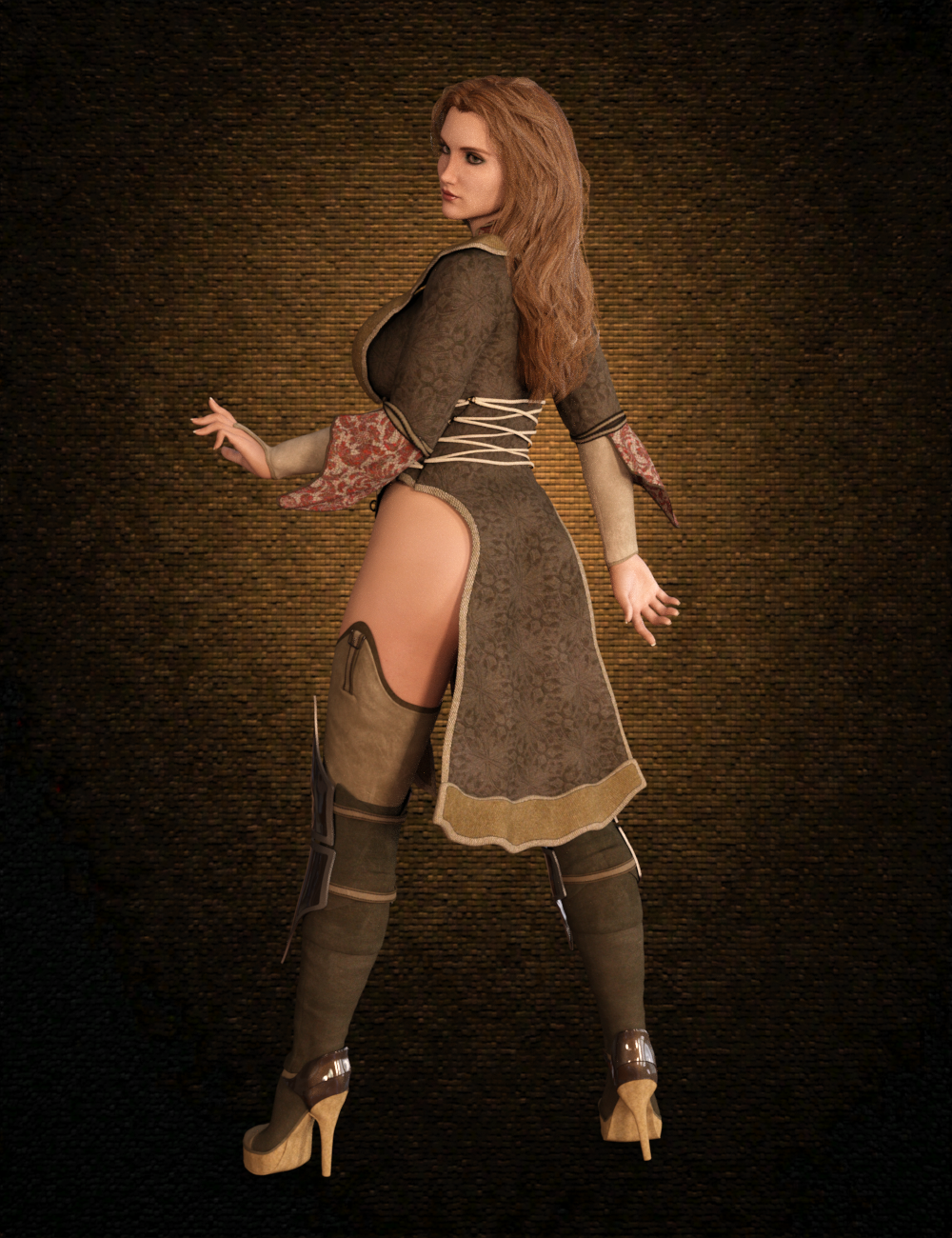

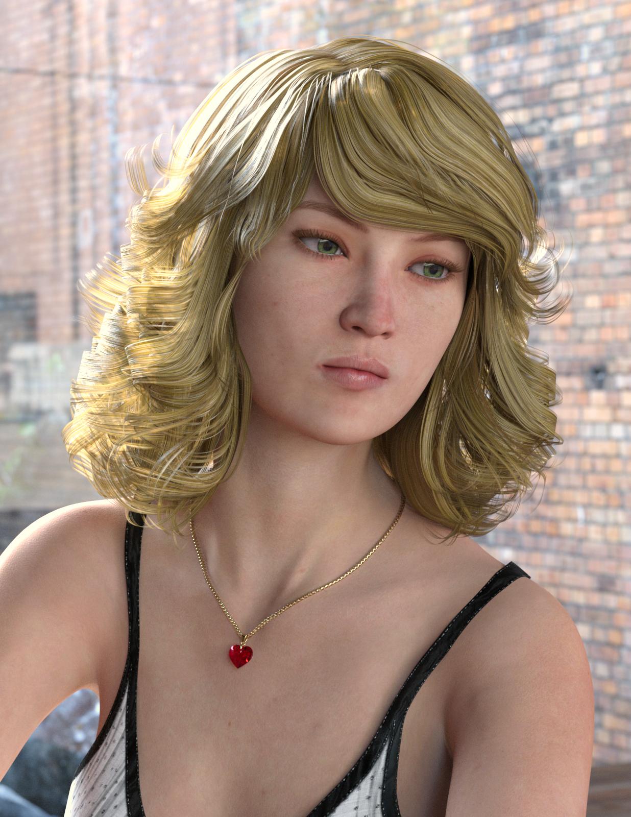

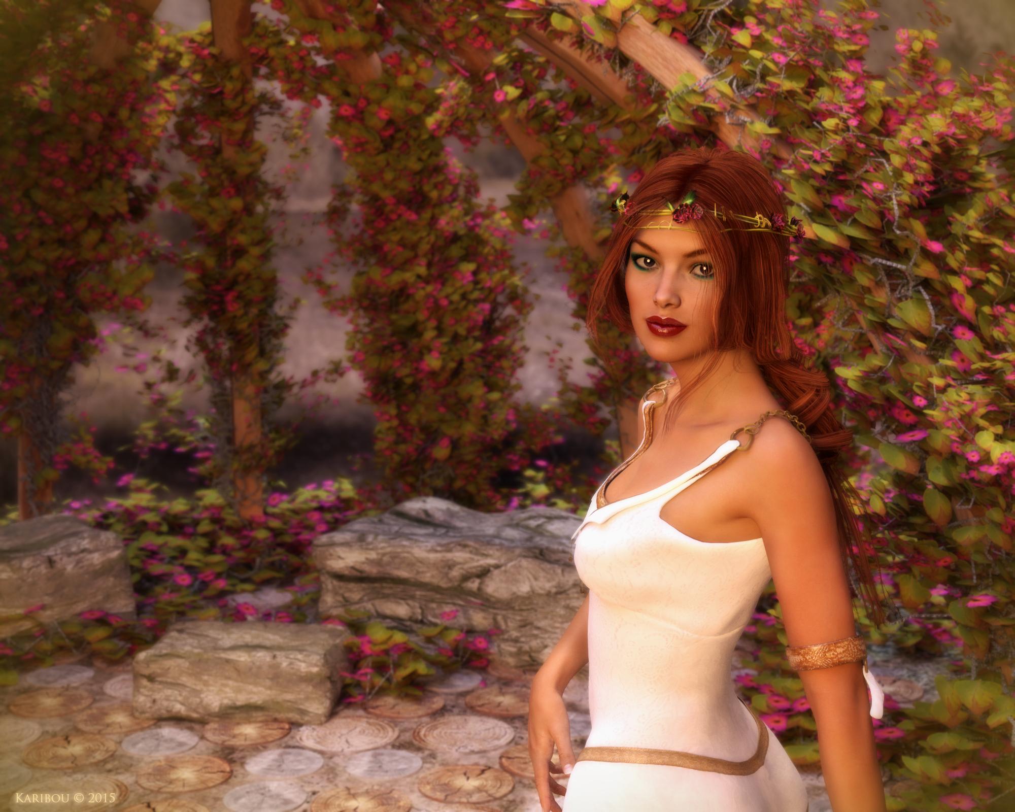

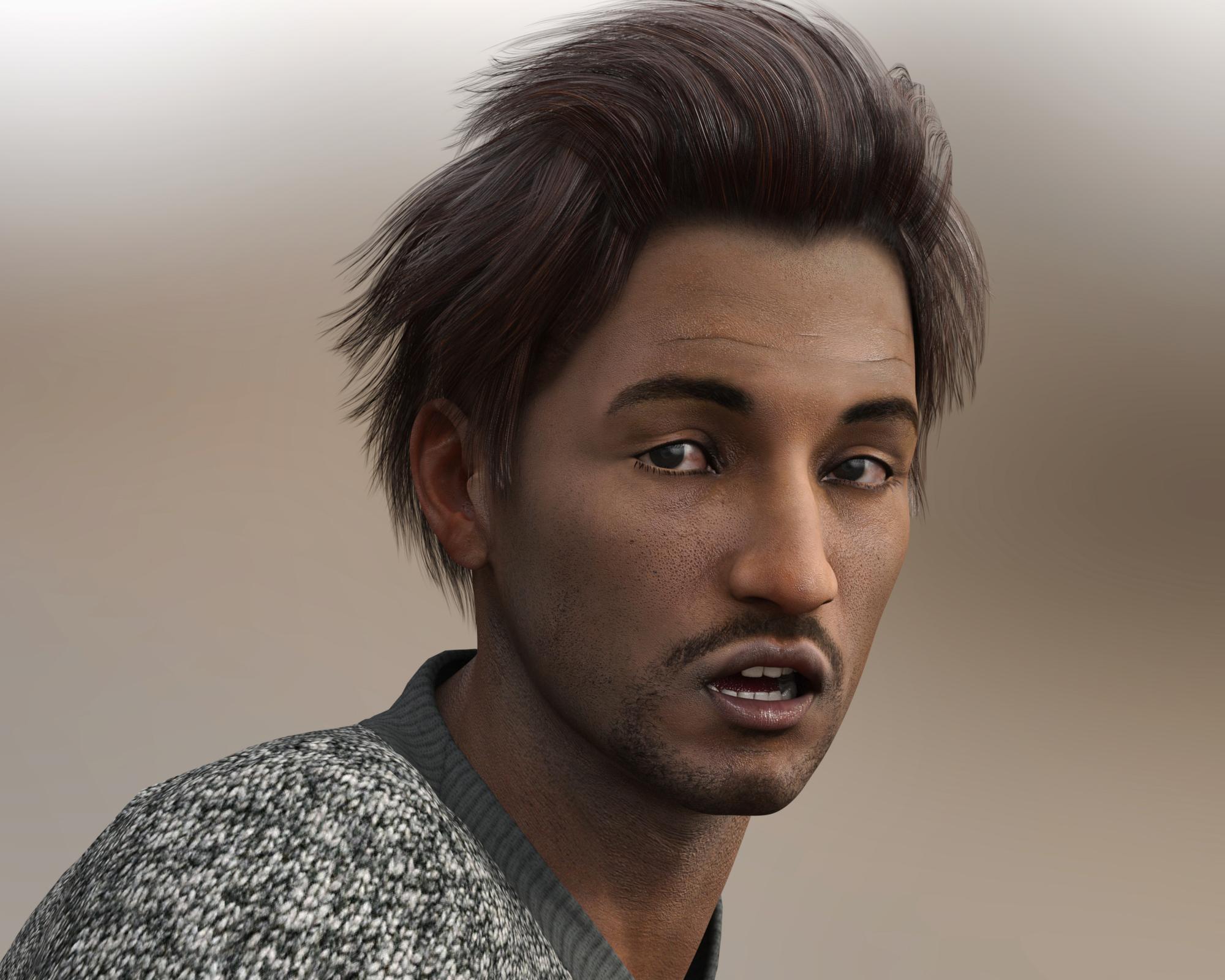

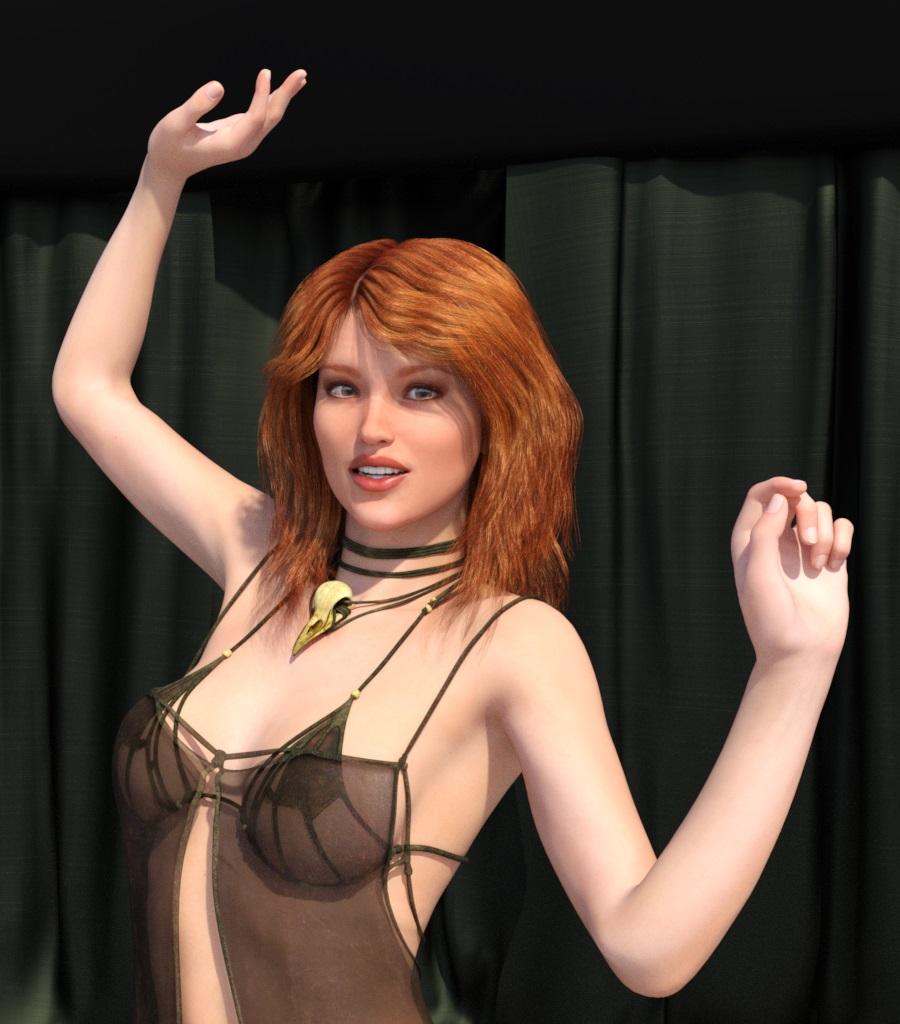

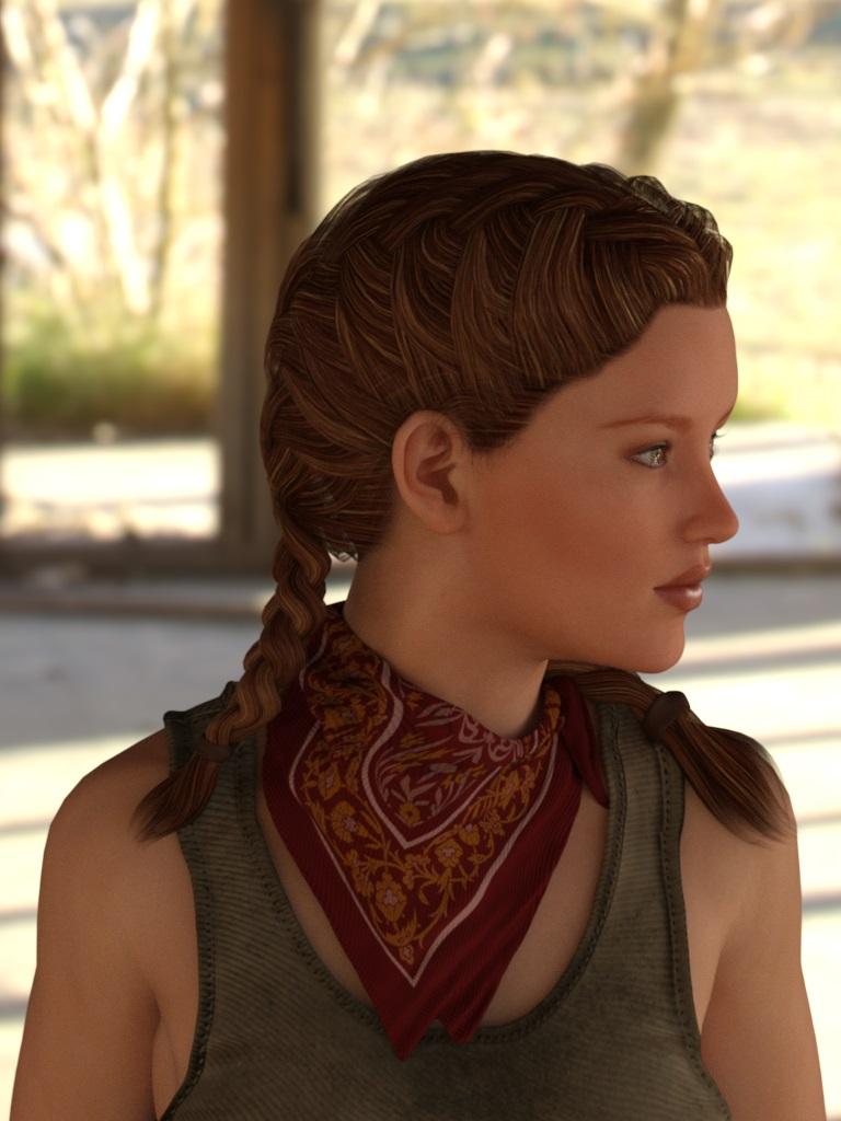

    I use this shader on EVERYTHING.  Used here on Liliane Hair for V4 (SWAM) and PixiePerfect Hair for Genesis 2 Female(s) (goldtassel).  Both of these were simple click-and-go applications.
    Seriously amongst the best products I've purchased for use in Iray.

  • SloshSlosh Posts: 2,391
    Wow, two really strong renders :)  I love them both.  That Pixie hair with all the curls is great.  I have to check my library and see if I have that one (I have most of goldtassel's hair)

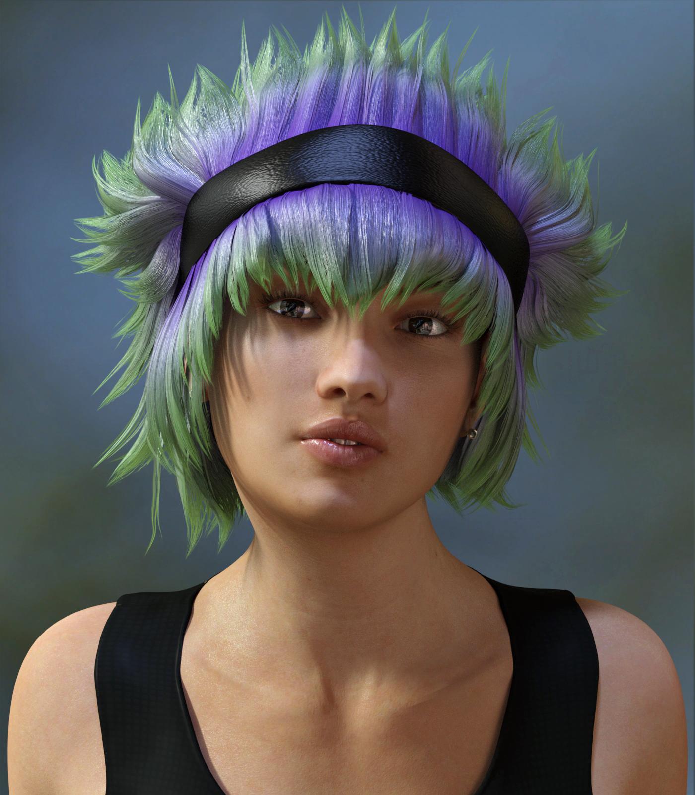

    I still love this product! UHT on Udane Hair on Genesis 3 Female.
    UHT Udane Hair G3F
