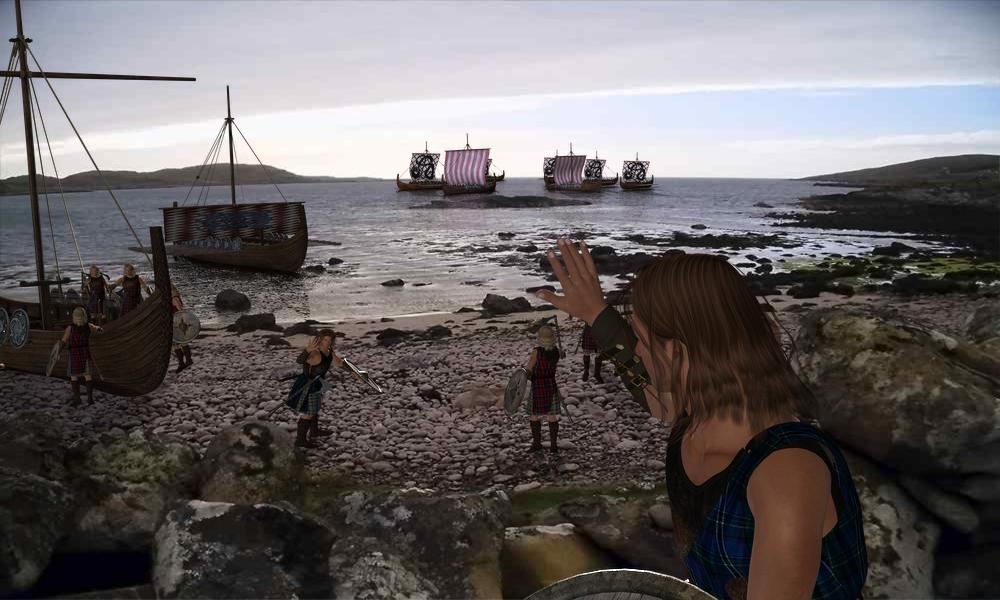

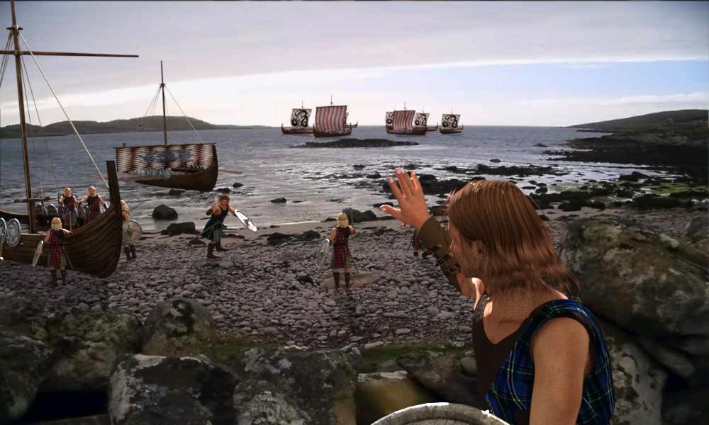

    Here is another of my scenes rendered in Iray.
    The first image is 3Delight.
    The second image is Iray.
    The image backdrop is a photograph of my own. In 3Delight I used two planes, one for the water and one for the land, to catch shadows; I had to turn these off in Iray. In Iray I had to plug the image into the Environment Map to get it to appear; set Dome and Scene with Dome set to off; ground set to manual, I had to move it the Z plane by 200 to get the shadows in the right place, shadow set to 0.50; I changed some of the lights to photometric because the originals were too strong and I changed the colour temperature trying to match the light from the picture.
    1000 x 600 - 361K
    1000 x 600 - 412K
