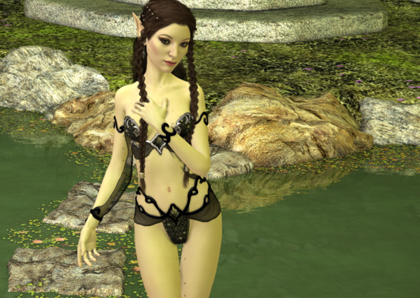

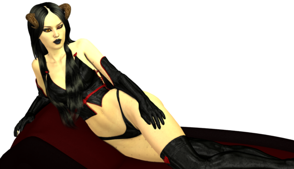

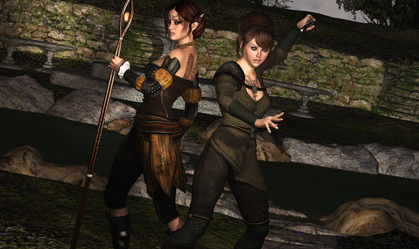

I'm just wondering what I'm doing wrong here.
I've done a few of my g2f characters but they don't look very good.
Especially the paler ones.
Do they need to be done in iRay? Is it the lighting?
These are just standard skins, not SSS.
These are Lilith and ...I can't remember the other one. It starts with an M. Looks like an elven character.
edit
With this new pic, I am certainly beginning to think it is a lighting issue.
But it only seems to work right with SSS...
1220 x 726 - 1M
1095 x 777 - 2M
1220 x 701 - 528K
Post edited by Upirium on

    You should check your lights and materials, poser and daz aren't the same in that aspect.

    What texture are you using, because on both characters I see darker spots all over the texture, which appears to be distinctly yellowish?

    Based on the render artifacts (that look like AO artifacts to me, but I could be mistaken), it looks like it's probably your lights (and maybe a combination of your lights and your render settings).
    Both textures render as they should for me in Poser, although I much prefer the way the SSS skins look over the normal MATs.
    Images below are Lilith 6 and Ninive 6 standard MATs in PP2014. My lights are white and one with a tiny bit blue-grey.

    The skin on that G2M looks yellowish to me too, so it may be a toned light you are using... the product you refer to appears to have toned lights as well.

    I own that light set and loaded it to have a look at the default lighting on load, and the default IBL has a very pronounced green-ish / yellow-ish cast to it. That's why your light skinned characters look like they do (and why it works with the darker toned / tanned skins). If you look at the IBL light in the material room, you will see what I mean.
    I would suggest you try a different light set or a different i13 Pro Studio preset as they may work better for the types of skin tones you're using.
