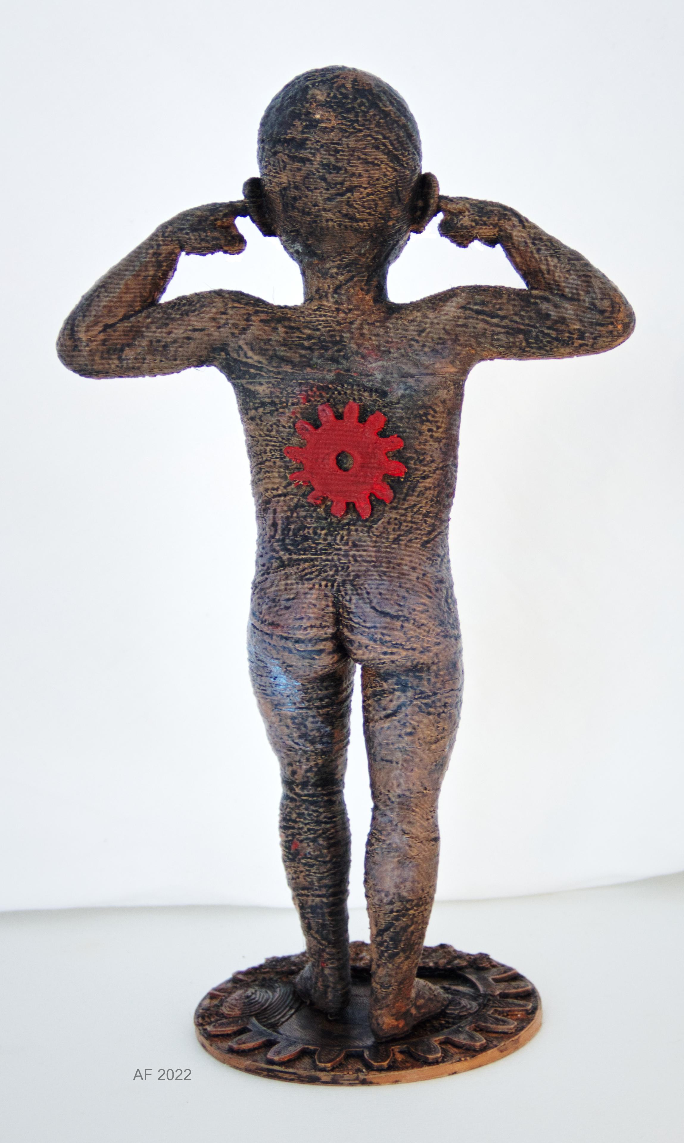

'Cog God Variation 1" PLA and acrylic paint. 23 x 8 cm. (maquette?) this is a Daz Model slightly altered. Exported with the displacment intact. Made manifold etc in 3dBuilder. Sliced in Cura 5.
Cog made in a free online cog generator.

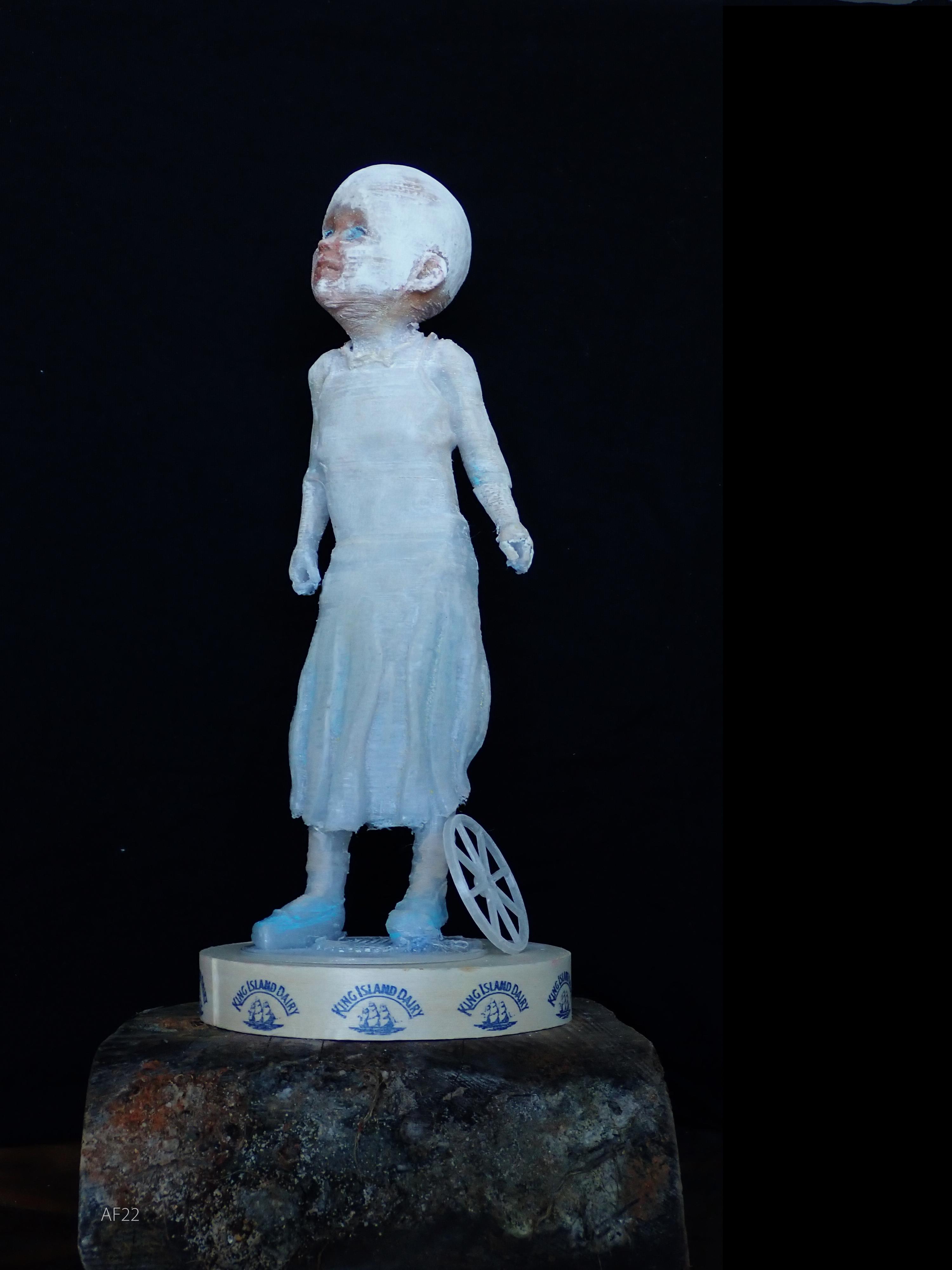

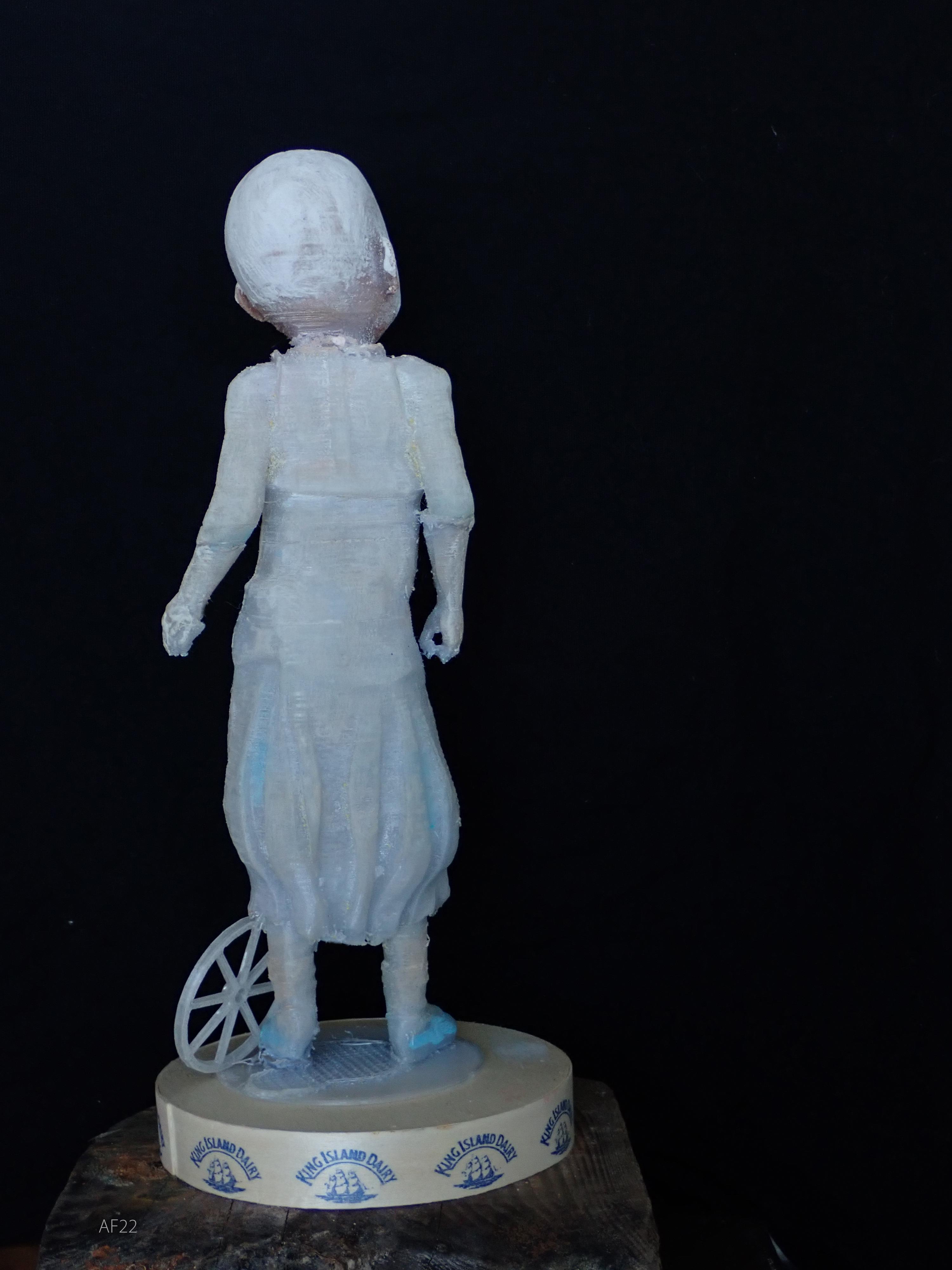

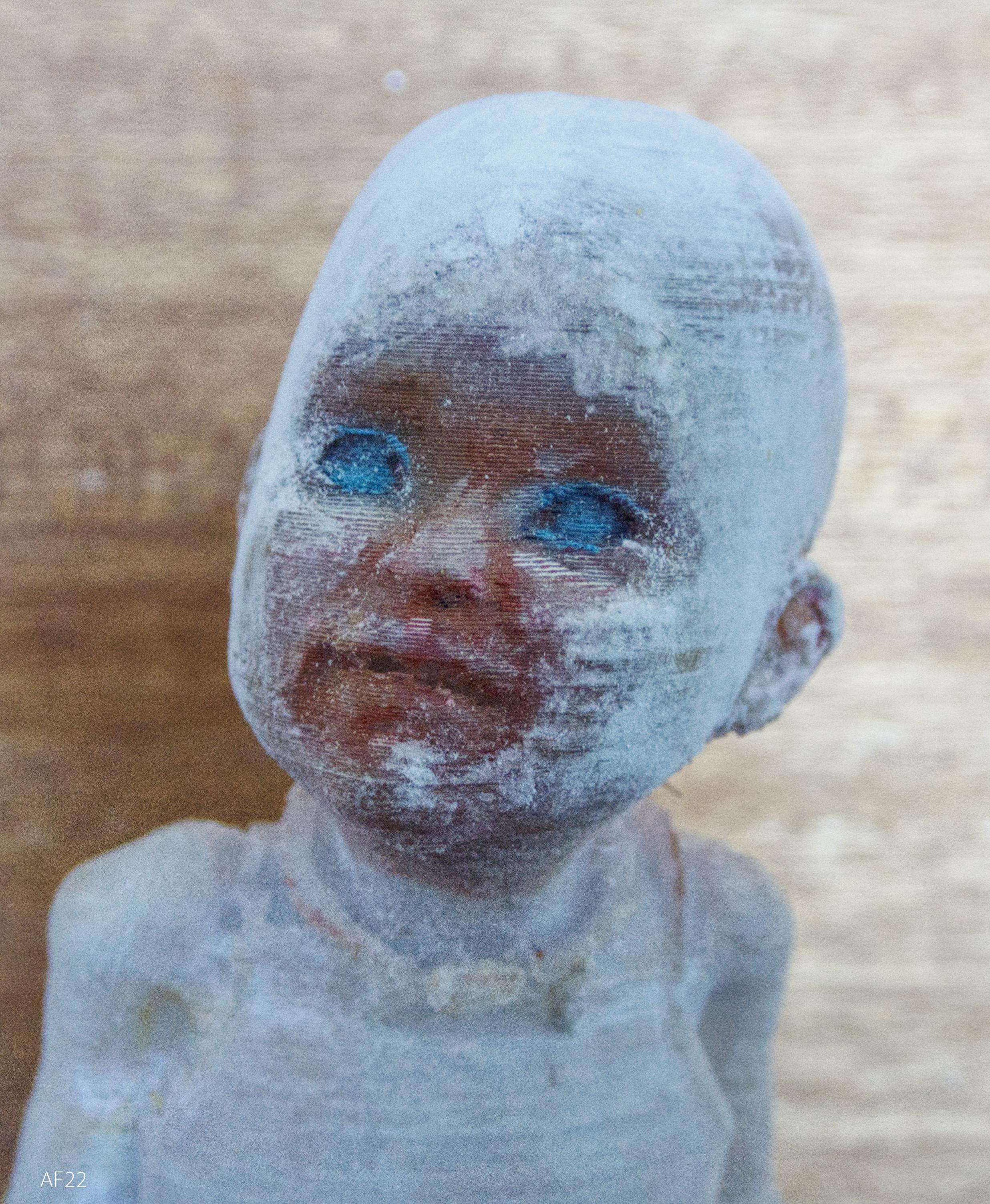

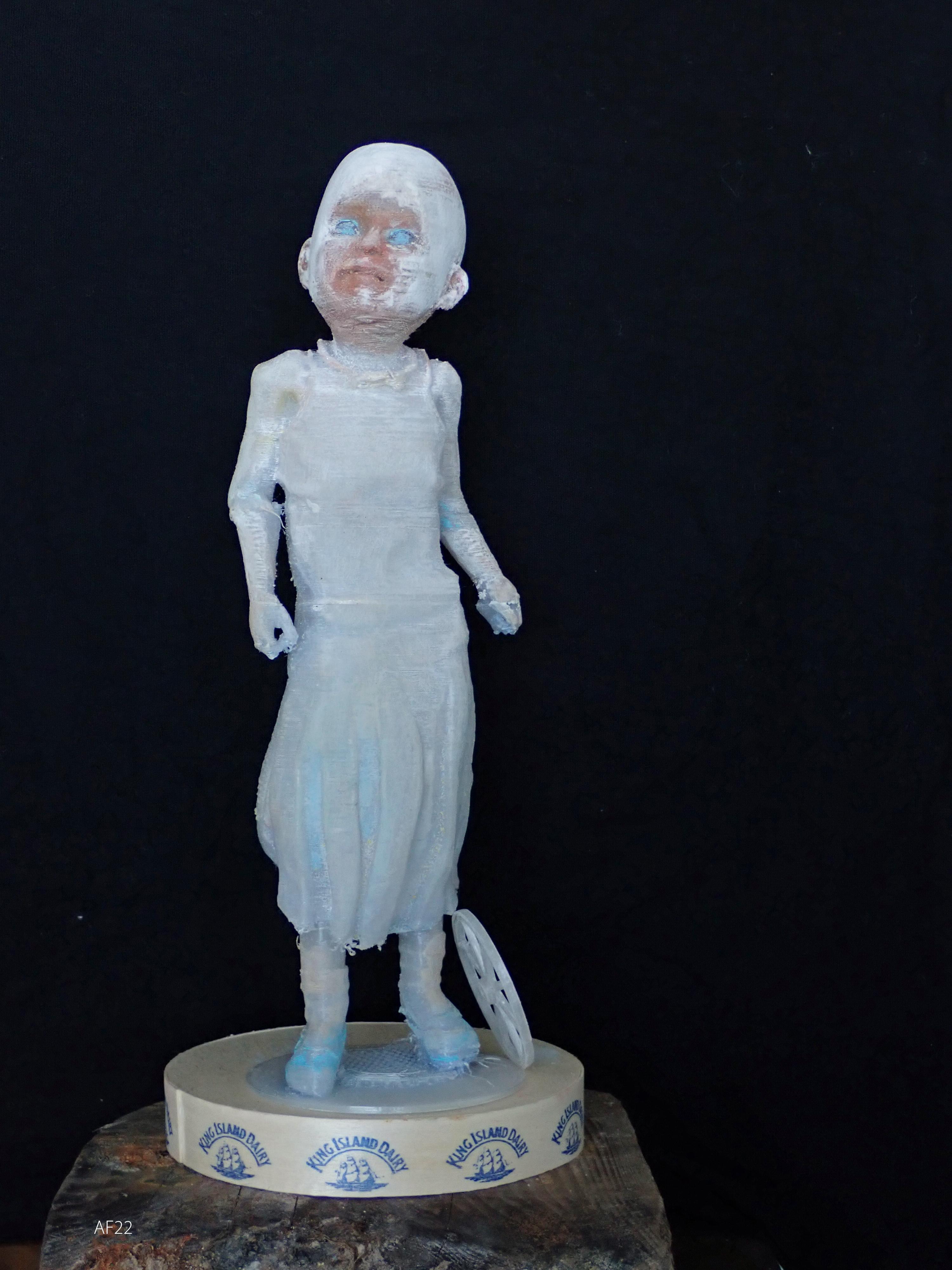

    Goddess of Coopers - wip  27 cm high with round wooden stand

  • Bunyip02Bunyip02 Posts: 9,345
    Looking great !!! Did you print out as one object or different pieces than glued together ?
  • DiomedeDiomede Posts: 15,468
    Same question.  Single print?

    this is one print apart from the wheel which hasnt been attached yet.
    i had a layer shift at the elbows because the nozzle ran into the supports (sinced removed) that were holding up the arms. A layer shift happens and the nozzle dumps plastic in mid air and makes a mess, so i repostioned the elbows as best i could with blue tack and elastic bands and almost saved the dat. Makes it eclectic rather than perfect...

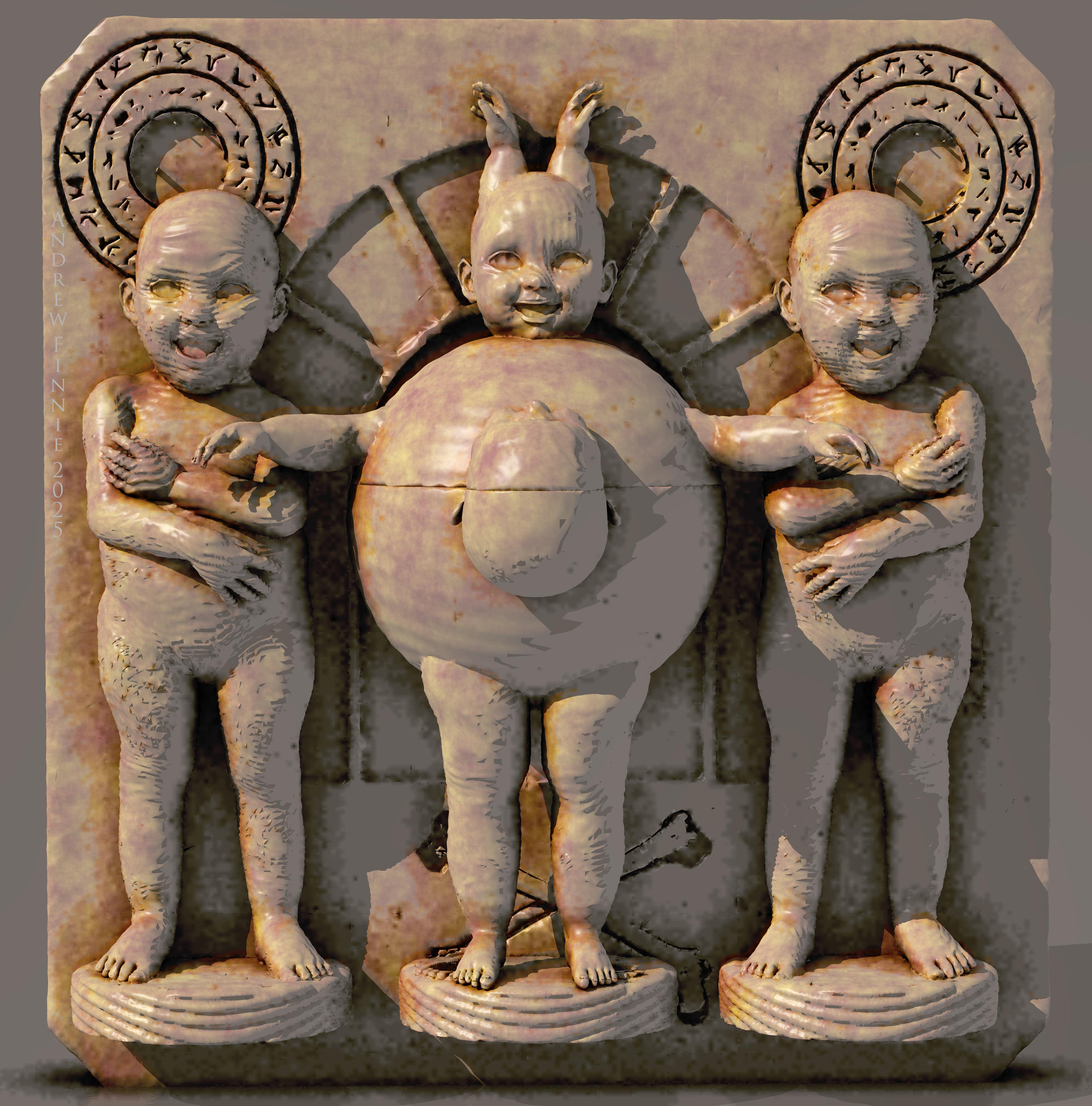

    I designed this 3d print a while ago - bunch of k4's with a wood displacement texture , but this arvo bought the obj back into carrara after converting it from 3mf file and rendered it out
    3 laughing house Gods

  • wsterdanwsterdan Posts: 3,635
    edited April 2025
    Looks kinda neat! Have you done any versions that are a little more obviously wood-textured?
