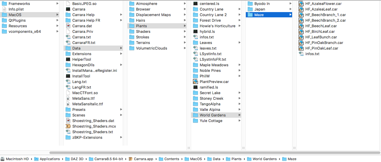

    All the files of the original Data-folder needs be placed in the /Data/Plants/World Gardens/Maze/ folder located within the application-folder.
    After you have done that open the original unchanged scene-file. If you have opened and saved the original scene file eariier Carrara will have replaced all the leave reference, that it can not find, with the default leave. A simple green one.
    1226 x 523 - 161K
    Post edited by RuudL on

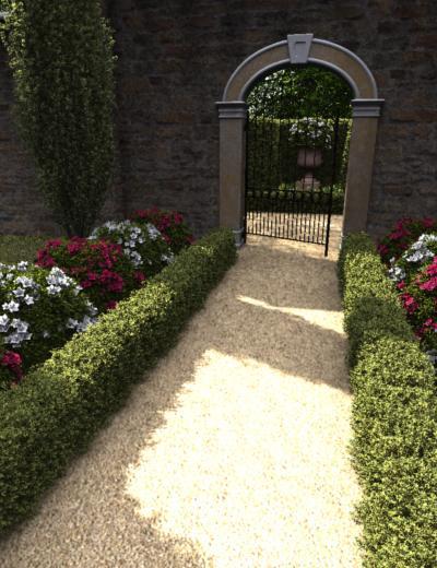

  • Ooo. Look at that! It's magic! Thanks RuudL and everybody.
    400 x 520 - 44K
