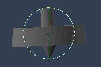

I have a problem with a turbine which must turn perfectly in the axis, but those are not well placed.
I rectify the position in the vertex modeller, but I do not manage to have a perfect position.
I see a function in of right side tab, but I don't really understand how that works.
Another question (not important) is in my head for a long time: why the axes of the manipulators of displacement and resizing are not in the same direction as the manipulator of rotation ?
Always in connection with this manipulator, which is the difference between “World”, “Camera” and “selection”?
Thank you for your help.

    I'm not clear on exactly what problem you're having, but from the image my first thought is maybe you have an "orientation" problem, where the orientation of the axes/manipulator isn't the way you want it.

    If you look at the image of the right side, could you tell me which difference there is between “world”, “camera” and “selection”, and for what that is used ?
    Another thing: the slider “Angle”, I don't understand either it's function, it make turn the objects and back to zero, strange…
    “Rotation constraint” and “Edge propagation”, what is that ?
    Thanks for your answer Joe !

    If you look at the image of the right side, could you tell me which difference there is between “world”, “camera” and “selection”, and for what that is used ?It sets the orientation of the manipulator. The 2 main ones you will probably use are "World" (the manipulator is aligned to world axis) or "Selection" (the manipulator will align to the average normal direction of the selection).
    The "View", is if you want to move objects based on the current view (The Z axis of the manipulator will always face the camera)
    Another thing: the slider “Angle”, I don't understand either it's function, it make turn the objects and back to zero, strange…The slider is for relative/incremental rotation. If rotating objects, it is (IMHO) better to type in the rotation, or use the rotation constraint.
    Used with the rotate manipulator. Set an angle, press(hold down) shift key, then LMB+drag on one of the rotate manipulator axis. The rotation will snap(incremental) rotate based on that set angle.
    “Edge propagation”
    Used for loop selection. For example. Create a default cylinder. Double LMB click of one of the horizontal edges. By default it will only select that one edge. Change the "Edge Propagation" value to 90, double LMB on that same edge and the full edge loop will be selected. It is a setting that decides if the adjoining edges should be selected or not based on the connected angle. (when double LMB used on edge selection)
    Another question (not important) is in my head for a long time: why the axes of the manipulators of displacement and resizing are not in the same direction as the manipulator of rotation ?By default, the rotation manipulator is set to "Gimbal mode"(rotation manipulator will rotate with object). You can change that in "File > Preferences > 3Dview > "Allow Gimbal Mode"
