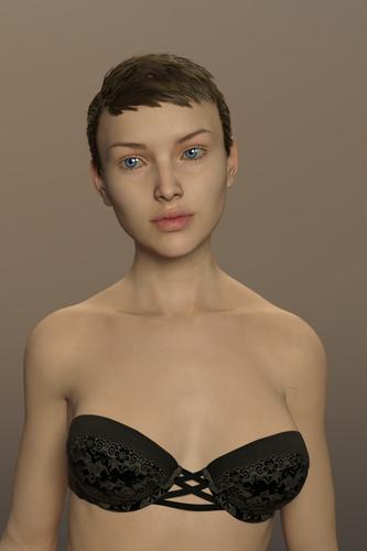

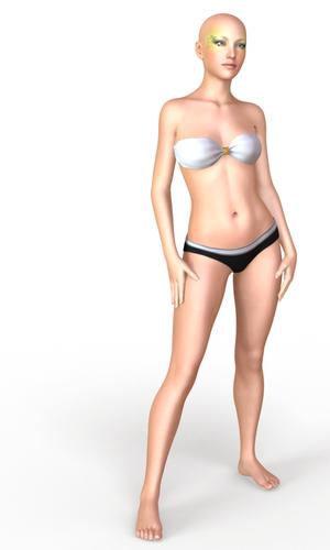

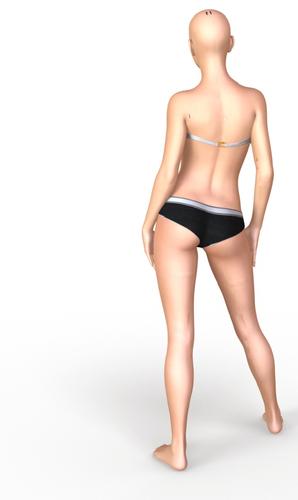

    Not V4, but G2F Tynwen texture on G3F. It was a very crude and automated process, which used Cinema 4D VAMP UV transfer. Resulting UVs are very messy at seams; I haven't done any manual UV editing, just reassigned some polygons on G3F to different zones – it gave a bit of smoothness at seams but clearly they still need a lot of work.
    UVs of this remap became stacked just as G2F had them (but I'm pretty sure it is fixable) and I had to assign all textures manually because surfaces remained of G3F. I had to leave the eyes on original G3F UVs but it seems that they take G2F eye textures pretty good anyway. Renders are very simple, basically diffuse only on default DS shader with minor ambiance and sheen because otherwise my DS wants to choke.
    But this is just about 30 minutes of work in total and I'm not a texture artist; in addition C4D isn't that powerful and/or texture-oriented software.
    I did those transfers as a proof of concept, and now I wonder if it proved anything at all.
    945 x 902 - 75K
    544 x 914 - 51K
    541 x 903 - 53K

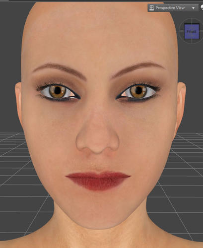

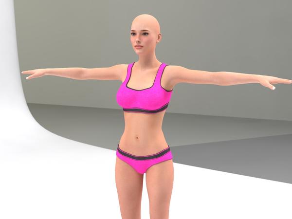

  • dizzy88dizzy88 Posts: 51
    Wow, interesting discussion here!

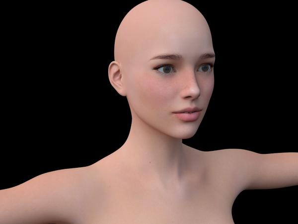

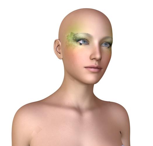

    I managed to apply a set of V4 skin maps ("Dolly" by Addy) to V7. This is probably similar to what Kattey did, just automatic with no manual work (Maya's transfer attributes/shading sets).
    I see what Richard is talking about, though: G3F's edge flow near some of the boundaries is almost at a 45-degree angle from V4, so it's going to have jagged UVs at the boundaries, which will probably create seams if you look closely. Unless you insert a bunch of messy edge loops at the boundaries, which would mess up G3F's topology and deformations (which I think are very good and shouldn't be messed with).
    I would guess that with a lot of manual work it could get to a 70-80% solution, which probably isn't good enough for some people.
    I suppose the only other option is to bake the textures to the G3F UV set...but that would also be a bit screwy, since G3F has separate maps for the arms and legs, while V4's limbs are all on the same map, so you could have some weird problems with downsampled resolutions. Plus, you'd have to re-bake every time you wanted to use a new V4 character.
    Anyone have other ideas?

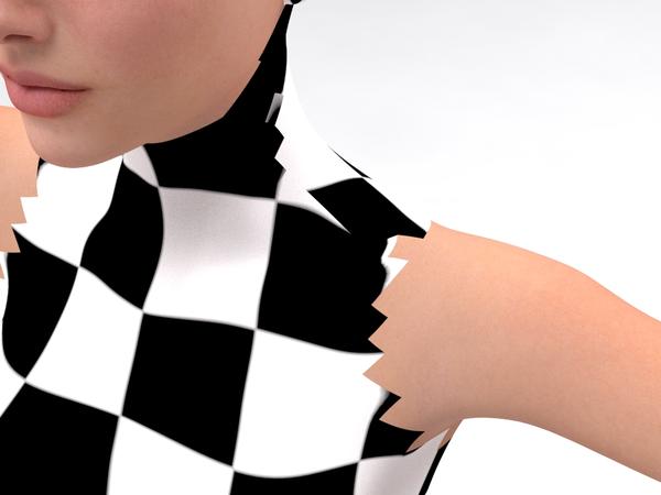

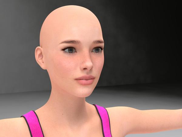

    Well, I only transferred the skin materials, so the eyes/mouth parts/nails etc. are still G3F.
    I exported a G2F with the V4 UVs, then exported a G3F with the "Genesis 2 Female" morph dialed in, so the two figures were pretty much the same shape. Then I extracted the skin meshes from each of them (i.e., separated the skin object from eyes/teeth/nails etc.), and used Mesh -> Transfer Attributes to get a rough UV transfer, then Mesh -> Transfer Shading Sets to get the shading groups matched because I was too lazy to re-assign faces by hand.
    It's kind of problematic, though - I applied a checker to the torso to show the "jagged edges" problem in the neck and shoulder areas. Depending on the texture, it might not be noticeable, from far away. But it's definitely not a "clean" transfer.
    Maybe just baking to G3F's UVs would be best. The new UVs are superior in a lot of ways to V4, in my opinion. Of course, distributing the new maps would be a definite no-no, unless the original vendors gave permission.
    1024 x 768 - 238K

  • ModernWizardModernWizard Posts: 904
    Heck, I'd just settle for something like a Face Paster that would move face/lips textures from G2F/V5. I did a quick 'n' dirty manual version of this with Bree V5 roughly matched to G3F base Jeane texture. Obviously the features need some more precise alignment, but I think that automating such a process is eminently more feasible than trying to convert whole texture sets.
    I bring this up only because I'm really attached to all the custom makeups I've created for one of my characters, and I really don't want to leave them behind. At the same time, the facial fig and much improved expressions of G3F call alluringly... :p
    --MW
    601 x 735 - 67K
    --MW
    Makeup would be easier if they were layers (PSD/pngs with transparent backgrounds), then you could layer and adjust in any image editor. Because ultimately, makeup isn't tied to the specific UV map, but rather the features of the diffuse map...or at least should be.
