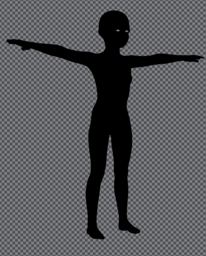

I have been experimenting with animations for a small project.
The quality doesn't need to be high so I don't need IRay or Luxrender or even 3Delight quality. I noticed that there is a mode called Intermediate OpenGL but when I try to render anything, either with the headlight or with added lights (I added AoA lights to the scene), I just get a black figure.
I can't find any documentation on how to use this render mode.

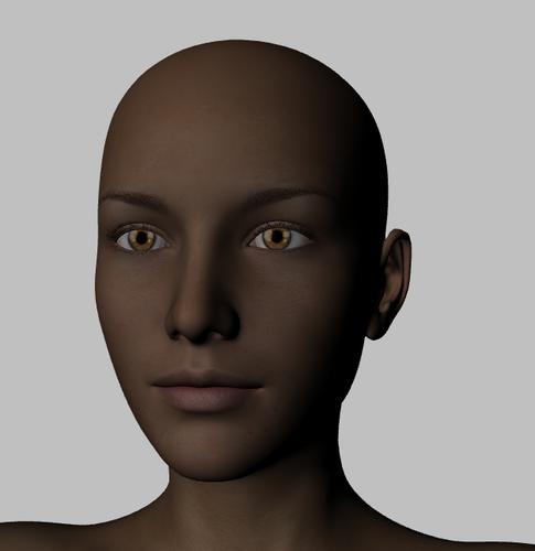

    I think it will depend on your Graphics Card what kind of result you get.
    It works for me, with the exception of transparencies in the eyes and eyelashes on G3F, and I have a fairly old NVidia card (4 years old) The lighting looks fine, but the eyes are opaque and the lashes are just black lines.
    You can look at Help > Troubleshooting > About Your Video card, and it may list something that helps.

    Well, the odd thing is that I switched to 3Delight, rendered a single frame and then switched back to Intermediate OpenGL. Hey presto, it works now.
    I have had issues with my GPU before. Even though it is NVidia, it doesn't work well with Iray either. I get screen artefacts which require a reboot to clear (this has been reported to support but no response yet). Nevertheless, I only have these problems in DAZ Studio. I don't have many games but the few I do have play fine as do movies and any 2D image processing.
    I'm not sure how Intermediate OpenGL is better than the basic version. I'm finding it difficult to see any difference.

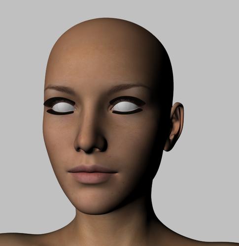

    edited June 2015
    In my system at least, Basic OpenGL is just a simple screen grab of the viewport, just as if I had done a Print Screen.
    The intermediate one looks a lot better, except for the eyes etc. but it does show better lighting.

    The eyes look ok on mine - certainly not like your image above. Except that the sclera is a bit too bright. I dare say I could adjust that in the surface settings (or are they effective for 3Delight only?).
    I switched off the 'Use OpenGl Shader (GLSL)' in the Advanced tab in Render Settings, and it fixed the eyes/lashes, but it is very bright, just with the Headlamp on.

    Ok - OpenGL shader was off already for some reason. I have a standard DAZ Spot and Distant light so that I can adjust the intensity.
    However, the shadows are either fully on or fully off, whether I use raytrace or deep shadow. On is too harsh so I have switched the shadows off (and set to zero).

    Turning down the ambient on the sclera did work but I can't get soft shadows. Shadowless will do for my purposes, however.
    I tried with the GLSL shaders on and got a completely black image except for the eyes which were white.

    Then for some reason, your system isn't finding any usable GLSL shaders...
  • marblemarble Posts: 7,501
    I have no idea where I (or the system) would look for them.
    Seems that both of us (above) have had problems with GLSL shaders - JimmyC with the eyes and me with the whole image.
    That's just it...the GLSL/OpenGL shaders are somewhere, but no idea where that some where is. Studio has some, included, but they seem to be pretty basic. Most modern games have a much better set. And that's where the problems lie...the set included doesn't have much in the way of features, including multiple transparency maps, the way transparency is handled...and so on.
    Not finding anything at all, is a bit odd..unless it wasn't finding something that Studio could 'translate' the 3DL shader to...because the all black is the 'no good/usable shader' indicator for the OpenGL, like the blinding white you get when the AoA shader goes 'off' in 3DL.
