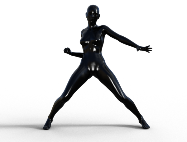

I bought a bodysuit and I want to render the reflections the way I want it to be. The problem is there are unwanted light even though every light in the scene is still off.
Apparently the light comes from the camera itself, which has it uses. But I want to turn it off for now to control the reflections with my own lights. I've tried every option I could think of.

    Select the Camera in the Parameters pane, look for 'Headlamp' and switch it off

    Much thanks, but I wasn't talking about the camera as a separate object, but rather the point of view itself.
    However, I figured I need a closed environment. Turns out it's the sun the iray is rendering. I'm gonna fetch myself an environment suitable for photography. I'll appreciate the help if you can lead me to one.

    in iRay..if you set enviroment to "scene only" it won't project a sun, and just use whatever you have in the scene.

    @Scavenger Now that's more like it. Finally I can take my time with the lights, thank you very much :)
