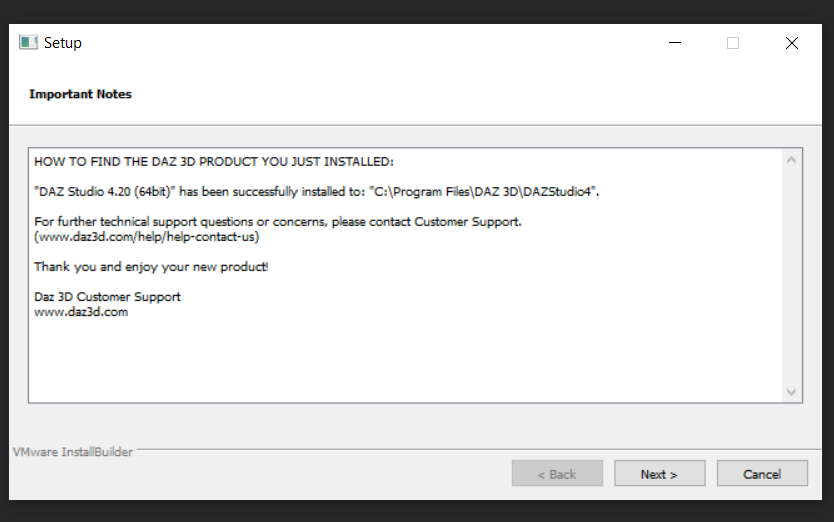

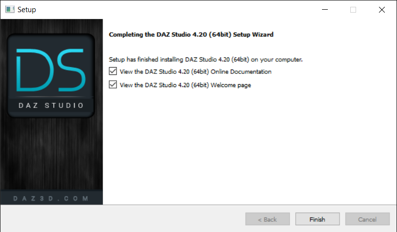

    Here is the fail sequence:
    So it says it failed but still finishes the install process and adds a shortcut that yields that last message when used.
    I don't know why the images show in post preview but not when posted. Attached is a combined screen shot.

    The batch file seemed to install the libraries fine. Then when I try to install Studio from the exe it fails at the VC library install. See attached.
    It then completes the set up, creates the desktop icon, gives the location information and help dialog boxes. Then fails to launch with the same error as previously posted.
