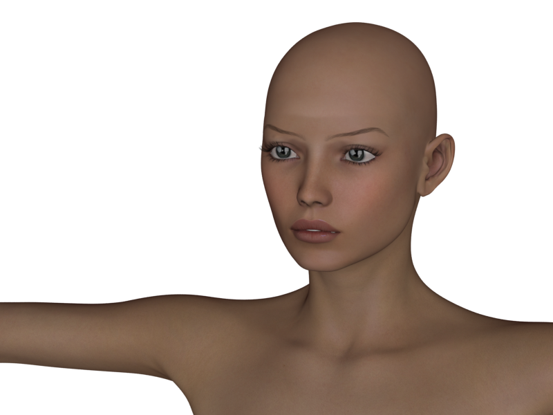

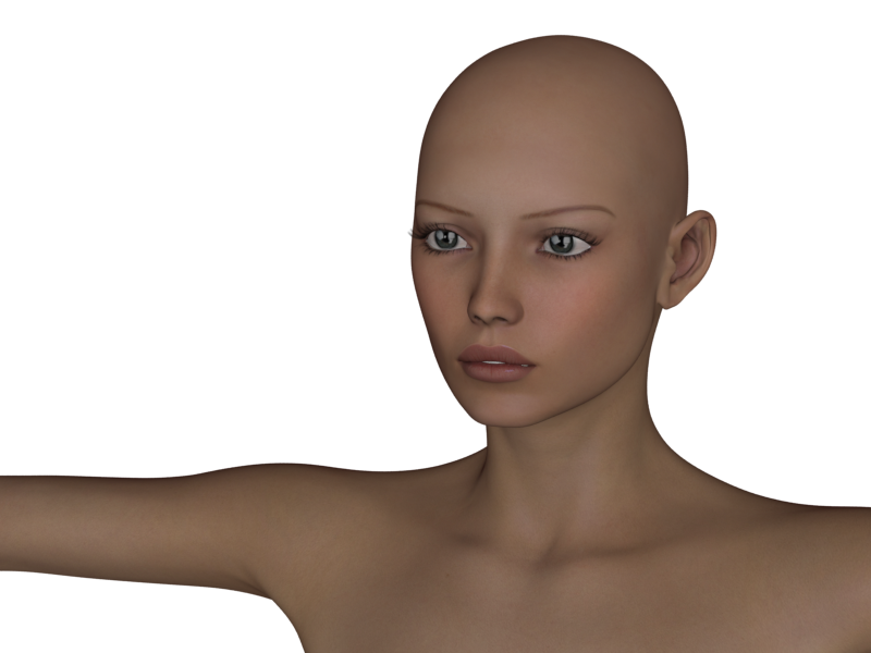

    I gave them a try in 3DL on Genesis1.
    1 Loaded G1 Caitlyn
    2 With G1 selected, loaded the Genesis eyebrows
    3 Selected the eyebrows base and loaded materials preset 04
    4 The brows have two materials, one face and one for the brows. Copied the face of Caitlyn and pasted onto SkinFace. Re-loaded the SkinFace alpha mask into opacity. The brows already loaded with their own opacitymap.
    What I used to do was simply hide (opacity=o) the SkinFace and just use the brows with their own opacity map. Otherwise I always got ugly looking seams despite the mask.
    Three renders, the original Caitlyn, Genesis brows with the SkinFace, and with only the brows surface:
    Of course getting the brow remover is a good idea. Someone else will have to explain how to best convert this to IRay...
    800 x 600 - 255K
    800 x 600 - 255K
    800 x 600 - 256K
    Post edited by Sven Dullah on
