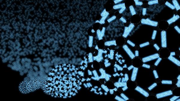

For the life of me I cant figure out how to model Carbon structures atom like this one from Turbosquid. Cant figure it out in Hexagon or carrara...

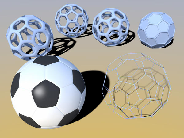

  • FifthElementFifthElement Posts: 569
    I took the stab at this in Silo modeler (soccer ball object was generated in TopMod).
    You can download it from my GoogleDrive (see my signature) 3D models section.
    Name of the file is "CarbonMolecule.zip"
    Hope it can help you :)

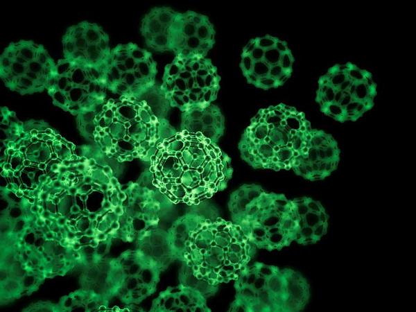

    garbanzolasvegas - thanks for introducing me to this shape - it's a fun one to play around with. :)
    640 x 480 - 63K
  • VarselVarsel Posts: 574
    Yeah ... more time wasted.... from me too.
    1920 x 1080 - 861K
  • garbanzolasvegasgarbanzolasvegas Posts: 53
    How did you get the outer green glow?
    Might be a shader plugin. Looks like Fake Fresnel. Forgot the name of the plugin.
    I used a color gradient controlled by Sparrowhawke3D's free Edge Falloff Shader. I set the color to black and the transparency to around 45 for mine - since the falloff shader is in the glow channel, higher transparency values lead to a brighter glow and lower ones effectively dim it.
    http://www.sparrowhawke3d.com/Sparrowhawke3DLaboratory.html
    You can just multiply the falloff shader by a color too but I find I have a little bit better control using the gradient.
    1387 x 679 - 113K

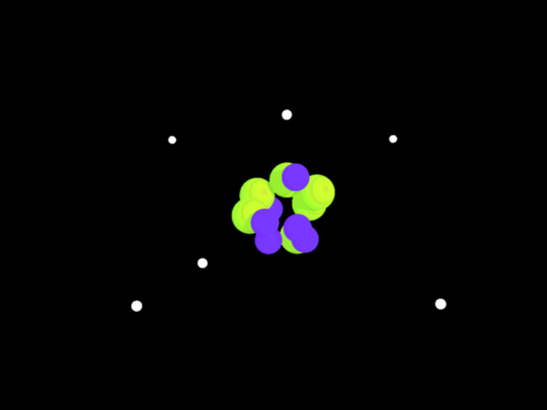

  • TerritanTerritan Posts: 76
    Meanwhile, for the sake of scientific accuracy, attached please find one possible carbon atom render.
    Six protons, six electrons, six neutrons.
    640 x 480 - 517K

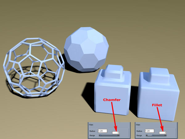

  • de3ande3an Posts: 915
    The base shape is a "Truncated icosahedron".
    So for the base shape, there is the "icosahedron" primitive in Hexagon, Create that, select all the vertex and use the surface chamfer tool with a range of zero to chamfer(truncate) the icosahedron.
    do we have a chamfer in carrara?
    any way:
    in the vertex room insert a 60 polygon polyhedron.
    select all edges and quick fillet.
    delete all triangles.
    select all polygons and add thickness.
    select all edges fillet.
    select all polygons and smooth edges.
    There is not a "Chamfer" tool, however the Fillet tool produces a chamfer when the "Range" is set to zero (see image).
    shlomi laszlo
    This is brilliant!!
    1024 x 768 - 116K

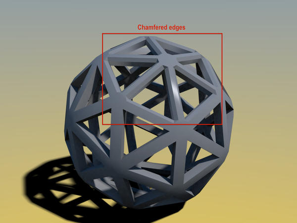

  • shlomi laszloshlomi laszlo Posts: 260
    any way:
    shlomi laszlo
    This is brilliant!!
    when the fillet range is set to 0 in carrara it does nothing.
    here is an image for you.
    1280 x 960 - 942K

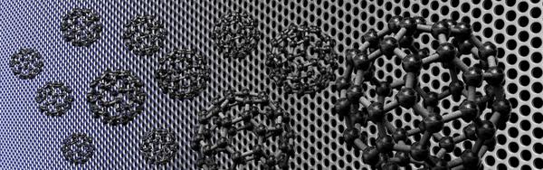

    Here's what I came up with. My carbon Molecule and a background of a sheet metal with holes in it...
    1280 x 400 - 533K

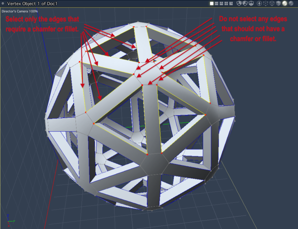

    edited June 2015
    Believe me, it does work.
    Chamfering a polyhedron shape made of spokes such as yours, requires special attention. You must select only the edges that require chamfering, leaving all other edges unselected. You cannot select the entire object and then choose fillet. That will not work in this case. The selection process is tedious, but it does work. (See image below with arrows)
    After carefully selecting your edges, use the Fillet tool with a range of zero and a radius of whatever is appropriate for the particular object.
    After the chamfer is performed, the edges of the chamfered areas must be "creased" or else Carrara will try to optically smooth them. (Menu item: Model/Crease Edges) See image below. (EDIT: I see that the animated image does not appear correctly in the forum, but if you click on it, it will appear in a separate window and display correctly.)
    1024 x 768 - 111K
    990 x 759 - 233K
    986 x 757 - 294K
    Post edited by de3an on

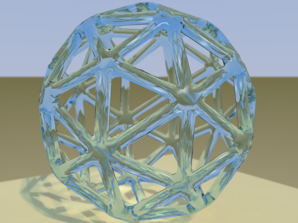

    Add some SMOOTHING to that and would like to see what you get...
    Depending on which edges you crease and which you smooth, the result will vary.
    The combinations are almost endless.
    1024 x 768 - 160K
