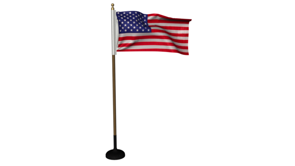

    I also have the flag, and the full control panel, I have had more success than you with this, but it is a tempermental item to work with.
    See below the two screen shots, one with the flag at rest, the second when it is flapping in the wind, the first was relatively painless, the second less so.
    For the first scene I just double clicked to load the flag pole (this loads a flag aswell), and then selected all cloth in scene in the panel. I could see the flag in the Garment panel. Single frame drapping just gave an error, but animated drapping did work. I had to run a 120 frame animated drape or the flag did not come to a complete rest.
    For the second scene I also ran an animated drape, but this time one of 30 frames (however the render was taken at frame 19 as it looked best at this position). I placed a wind object blowing roughly left to right angled up towards the flag. The wind strength was set to 12. I also changed the X Times Earth Gravity to 0.2.
    The main issue I had with the second animation was that I could only run it once. A second animation always did nothing. So I had to save the scene just before drapping, and if I was unhappy with the drape I had to reload the scene, tweak some settings, save it again and then re-run the drape. If I saved after doing the drape, then even loading the scene again did not help, it seemed whatever it was that blocked a second drape was saved into the scene as well.
    The flag stayed on the pole as long as I had it colliding with everything in the pole and the flag. However in some simulations, when the wind was too strong, then the flag would detach from the lower pin.
    I hope this help some what.
    1920 x 1080 - 270K
    1920 x 1080 - 119K
