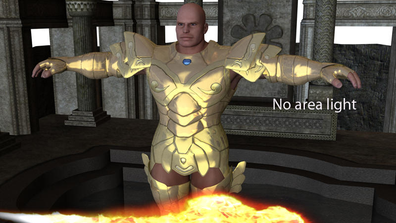

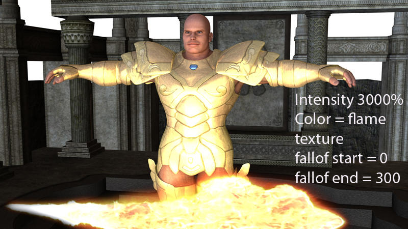

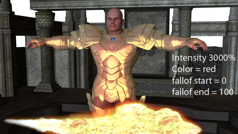

  • Takeo.KenseiTakeo.Kensei Posts: 1,303
    What do u guys think?
    Like what Kendall says there is too much light and I'm not sure you turned the flame prop into an area light because you don't see the lightning of the flame on the dragon and the environnement but that is not easy to set up
    What I told you before for the settings apply here too. You just dont't have specular parameter with the area light
    Diffuse -> 0-50% depending on your lighting and your liking
    Ambiant -> white 100% with the flame texture
    Opacity white 100% with the transmap
    Color white 100% with the flame texture or you could use a color like red or yellow. Be carefull putting the texture increased the render time
    Samples -> at least 128 at shading rate 1 from my test. The more samples the better quality and the longer rendertime
    Accept shadow->off (not sure it's usefull but it's in case of)
    You then have to tweak the light intensity and the falloff to get something correct
    I rendered some examples below. I have some artifact due to my shading rate which was at 4 but the idea is there.
