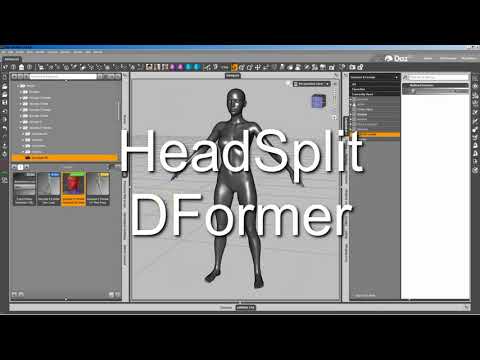

    Your best option I guess is to follow tutorials about DFormer. Which will enable you to load morphs and partially assign their influence to only parts of the mesh. Idea in a nutshell is to export Genesis 8 as obj with only 1 expression loaded. Then on a base Genesis 8 in DAZ, create a DFormer that will influence only the upper head. Load the export Genesis 8 obj (morph loader pro) with the expression you want, and use the DFormer influence at 1 or -1 to influence upper or lower face (tutorials thereafter so that you understand what that means)
    Good tutorials on the subject are ultra rare and focus mostly on how to import head and body separately (FHM, FBM). Meaning that they use the default DFormer already set-up in DAZ for content creators (My DAZ 3D Library>People>Genesis8>Developer Kit>Genesis 8 HeadSplit DFormer). But by making your own DFormer you can for the morphs to apply to any given part of the body.
    I'd advise you to follow those tutorials and take notes. It might sound a bit complex at first if you've never dont that. But it's extremely necessary DAZ knowledge to acquire ;) Those expression bundles you talk about have been very probaby made this way. Once you made a DFormer that influence half the head, you can save it and easily re-use it to split upper/lower face the influence of all expressions you want.
    1/ First option, good tutorial (except for head/body morphs it doesn't talk about characters taller or smaller than the default G8) :
    2/ Second option, in my opinion a more in depth and definitely more advanced tutorial on head/body morphs :
    Again, both those tutorials are about head/body, but you can make what you need UpperHead / Lower Head, using the same exact technique except you'll have to create your own DFormer (which is pretty simple really).

    hansolocambo :  I did watch the video trutorials and I was able to complete the seperation of head from body using the provided deformer.  No I need to create my own deformer to spleet the top and bottom of the head.  I will leave this for a weekend project.  the key here will be matching height of the source and destination characters when applying a split morp and then resetting the destination character's height to the desired. I look forward to giving this a try.
