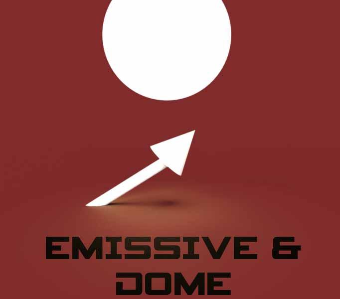

    Old thread, but new problem:
    I tried Rob's instructions....I'm having a weird problem where my shadows are not darker than the surrounding space. Also the plane is catching the light from the spotlight... Odd.
    Has something changed in Iray maybe?
    -P
    3440 x 1440 - 1M
    Post edited by PA_ThePhilosopher on
  • Did more testing... It appears the only light source that cast shadows onto a background is "Distant Light." But it produces a hard shadow which is not very realistic, nor modifiable... Hmmmm....
    -P
    3440 x 1440 - 1M

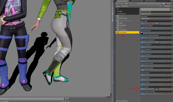

  • Fishtales said:
    There are two ways to test this.
    In the first experiment try turning the Environment Map or Environment Intensity down, it might be overriding the shadow and causing it to be pale, like a fill light. The second way would be to increase the Ground Shadow Intensity which will make the shadows on the ground darker.
    In your second experiment I would turn down the Distant Light Luminous Flux or decrease the Ground Shadow Intensity until I got the shadow intensity I wanted.
    No go. Turning the Env Intensity down does nothing. I even tried turning it off (switching Scene Only), as shown in the image below.
    Increasing Ground Shadow intensity also does nothing to casted shadows.
    -P
    3440 x 1440 - 582K

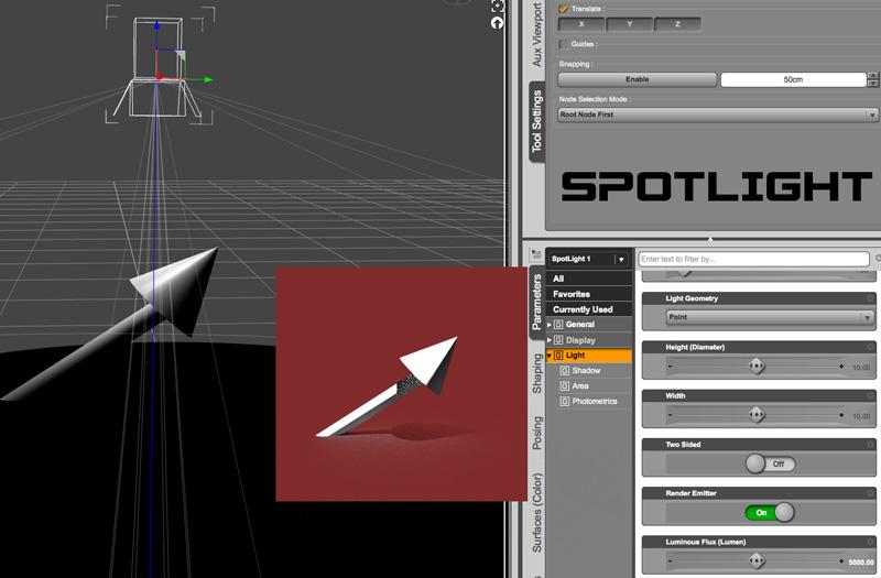

    No, there is definitely something not right here. If the spotlight was working correctly, it would cast a dark shadow. But in this case, its just a negation of the reflection.
    To help better illustrate this, here is what happens when I turn the lumens all the way up;
    (notice Ground Shadow Intensity is also jacked up to 5)
    3440 x 1440 - 1M

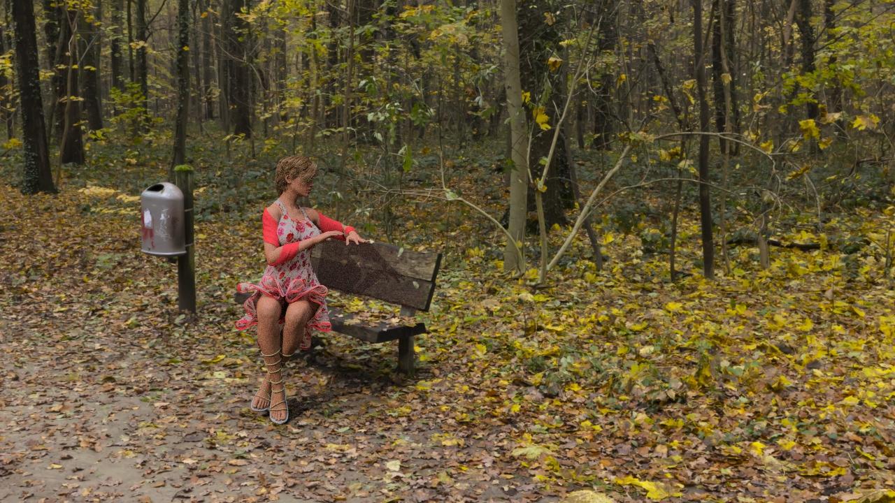

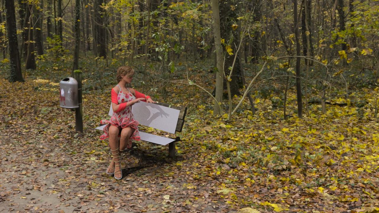

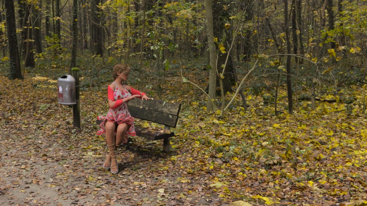

    Here are a couple of images using the Iray Matte feature using a plane.
    The first one has the two planes turned off. One for the back of the bench and one for the seat. The background is an HDRI. The second image has the planes turned on and the third the Iray Matte feature turned off to show the planes.
    Click on image for full size.
    1280 x 720 - 986K
    1280 x 720 - 990K
    1280 x 720 - 984K
