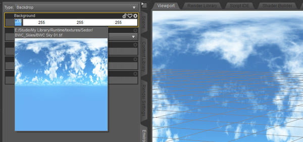

    Use the Skydome texture (the image on the dome's diffuse and/or ambient node in the dome's shader) as your environment map in Iray, or use it as a background image in the DS environment tab. You'll be able to see your sky that way.
    459 x 792 - 195K
    837 x 393 - 243K
    Oh, thank you! I was going nuts trying to figure this out! I now have beautiful skies again!
