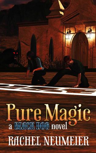

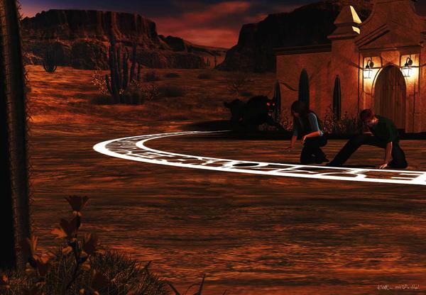

    Just in case anyone is curious, when I rendered at 5000 pixels, the displacement showed up. I don't know why it didn't at 700.
    Here is the final work:
    2000 x 1385 - 268K
    1250 x 2000 - 255K
