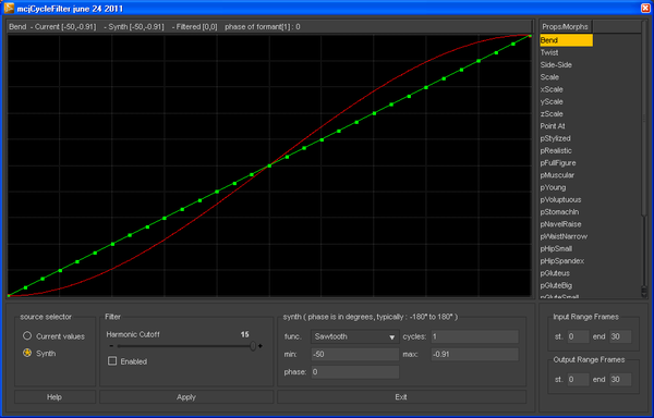

    for DS3 there was my plugin named SceneGraf ( which i still use a lot ) which lets you view the animation curves
    for short animation ranges, there's my mcjCycleFilter script
    https://sites.google.com/site/mcasualsdazscripts/mcjcyclefilter
    , which is compatible wuth DS4 (i'm almost certain) and lets you view the animation curves,
    tweak them a bit, or apply functions, like "ramp/sawtooth" for instance
    here you can see a 2-keyframe curve in red for a figure's "Bend" channel
    and in green, what it would become with a synthesized 'sawtooth'
    oops i just saw after posting this that you did end up using setInterpolation :)
    note that it's possible that setInterpolation's less used "TCB" and "Hermite" buttons are interchanged
    960 x 614 - 27K
