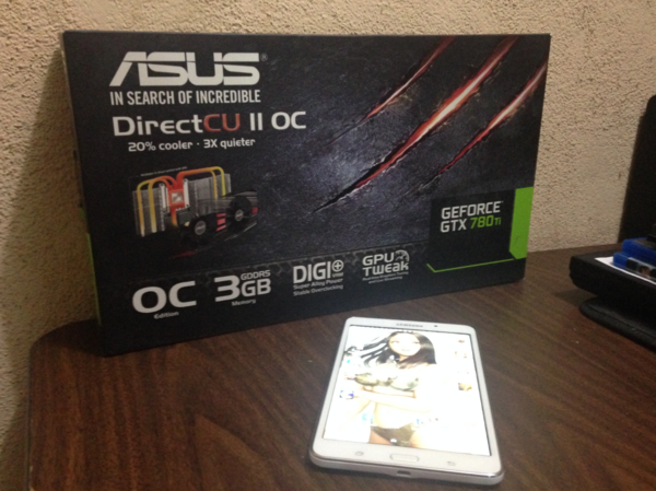

    Thanks for the research, thricegift, I'm a proud owner of a 780Ti now.

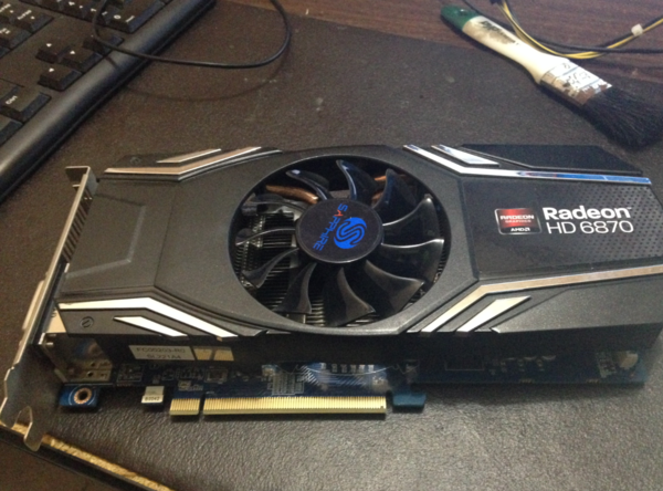

    in a less than 8 hours I will buy my new PSU for the GTX 780Ti, cross fingers, when installed I will post the render speeds.
    2880 Cuda cores...almost porn.
  • ZilvergrafixZilvergrafix Posts: 1,385

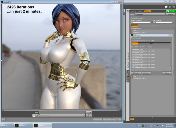

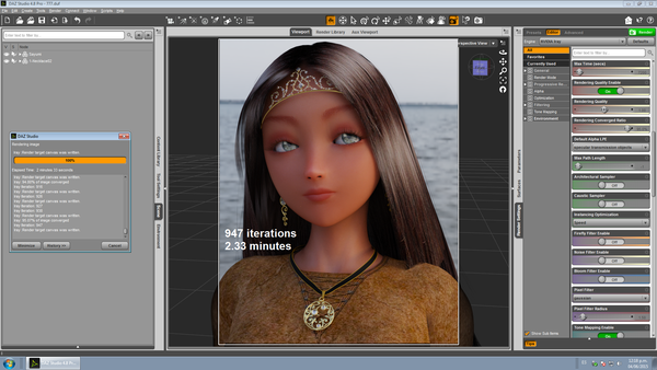

    Ok, after installation with a new PSU and a lot of scary setup (a jumper not in place got me creeps for a while), there you go, very good numbers for my workflow, iray sun is very demanding, hdri is faster.
    1920 x 1080 - 3M
    1920 x 1080 - 3M
    1920 x 1080 - 1M
    1920 x 1080 - 2M

    @zilvergrafix: You got that scene to do 2000 iterations in 8 minutes!? Oh man. That's awesome. I just bought a Titan X. Expensive, but I know I'll make use of it. Can't wait for it to get here. I like scenes with many lights and subtle shadows, etc. Looking forward to seeing the results. Your post makes me very optimistic.
    Titan X, whoa!, well I had that like an option, but it was 100 USD more expensive than the GTX780Ti.
    the negative side of this is...the credit card debt...*sigh :shut:
    Below, a new record??, single figure, just HDRI lights, Quality turn off, firefly ON.
