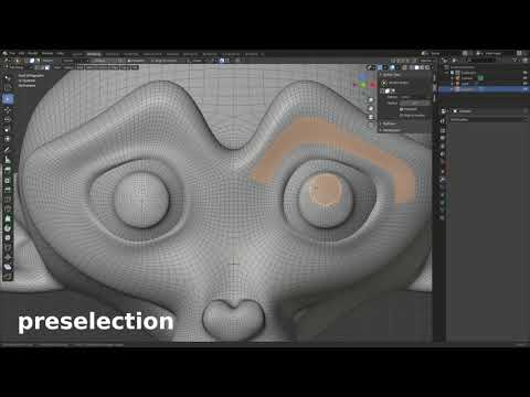

    Hmm, this might help ... link to github and bm is shown below the vid:
    Another one which I'm using frequently when editing my characters in Blender:
    ring select, then double click an inner part to select everything to the boundaries.
    HTH!

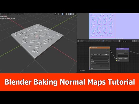

    PS: I would keep the low poly as a copy, then do the multires stuff, apply the modifier, bake a displacement and use it for the low poly mode. Texturing maybe via substance/quixel or via pbr painter directly inside blender... Jaynam has a very simple way to bake the displacement map...
    (or you can use his free jbake tools and do it by some clicks^^)
    https://github.com/jayanam/jbake-tools

  • Write IdeaWrite Idea Posts: 493
    April 2022
    Perfect Select and Power Select look like great tools to look into!  Thank you for suggesting them!
