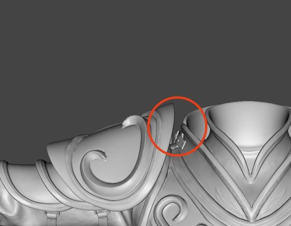

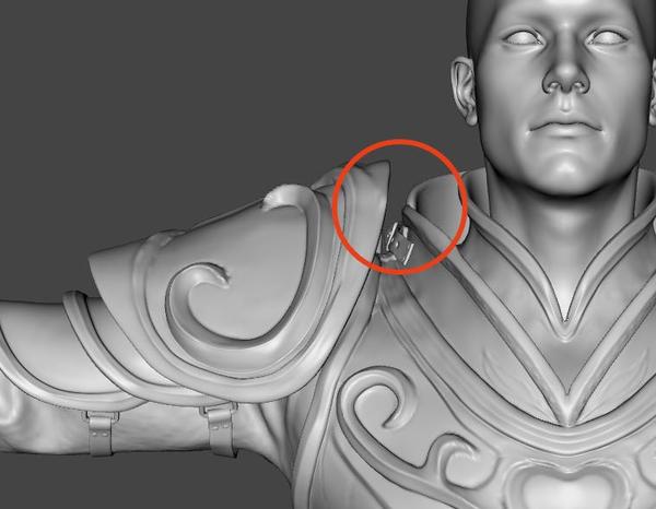

Okay, so I'm trying to figure out how to fix this. Maybe it's just because I'm tired, but when I initially load Luthbel's Paladin HD MMXV top into a blank scene, it looks perfect on and around the shoulder plates. However, as soon as I have it "Fit to" a G2M character, there is distortion. I realize it's an issue with weight mapping, but is there a way to stop this from happening without having to edit the weight map? One image is the armor top, not fitted to anything, while the second is fitted to Michael 6. In the areas circled, there is distortion in the mesh after fitting. Surely it can't be so bad as I have to edit the weight mapping just to make this armor look decent on anything but the base G2M?

    That isn't a weight map issue, since the figure isn't posed. The armour does have custom morphs for M6 so it may be worth reporting this as a possible bug needing tweaking if you see it with just the M6 shape applied to an unposed figure - and if it renders that way (if not it may be connected to the way HD morphs preview).

    Blast, still works the same, using the default M6 character. The only one this doesn't happen with, is default G2M. The problem seems centered around morphs of the head, which is why I mentioned weight mapping.

    It's both sides. It always appears when a head morph is applied, but can also appear when an HD body morph is applied. For the HD body, I can ignore for the most part, since it will almost always be hidden (except that one or two times I want to do something without gloves). However, the moment any head morph is applied for anything from the base G2M figure, instant distortion like seen above. While it is most noticeable in the shoulder plate, it does extend to areas like the collar.
    Select the armor/part in the Scene and then switch to the Parameters tab....click on the little icon that looks like a piece of notebook paper in the corner of the Parameters and choose Show Hidden. Then select Currently Used and see if the head morph is showing up in the Armor...if so, try dialing it back to 0.

    MJC: Yes, the head morph was appearing on the armor, and dialing it back to 0 certainly removed the distortion. The only downside is the traps then poke through. That is a bit more livable than absolute distortion.
