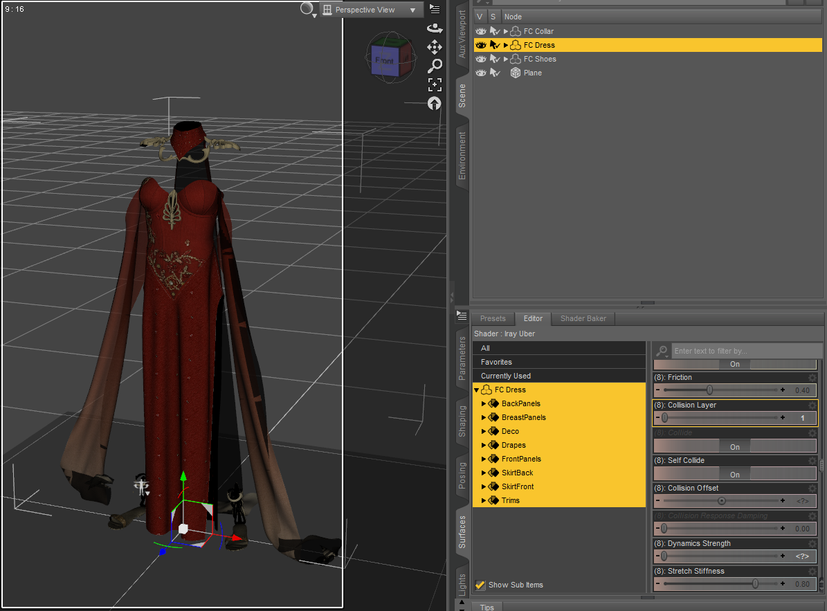

    If you simulate the dress and it mostly just hangs in the air, that's a separate issue from whether it's falling on the ground plane. It could be weight-mapped, so that certain parts of it don't respond fully or at all to simulation. It could also have dynamics strength set to different levels on the different surfaces, which is an easier fix. Go into the surfaces pane, select all the surfaces of the outfit, and set Dynamics Strength to 1.

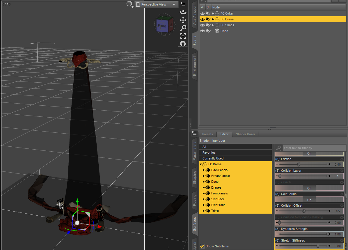

  • GordigGordig Posts: 10,798
    edited February 2022
    I just loaded the outfit into a scene and simulated, and it hung in the air, as you said.
    So I turned the dynamics strength on all parts of the dress to 1, and it fell to the ground.
