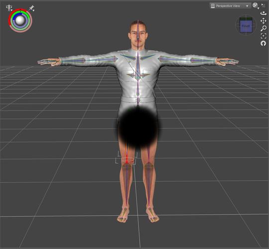

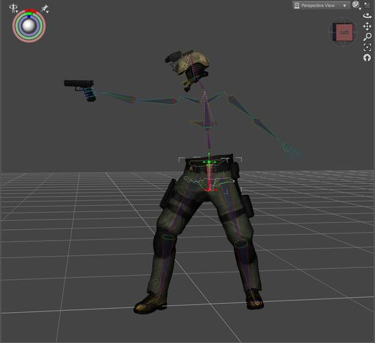

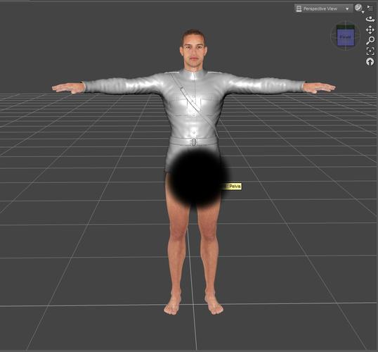

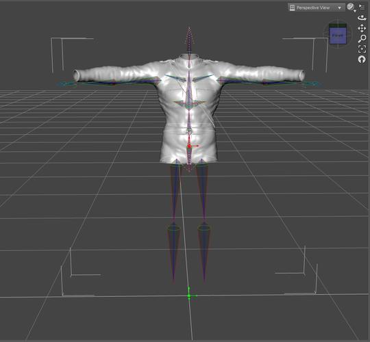

I have a problem with rigging clothing , after the program has done the transfer the clothing moves either up for a shirt or the legs spread for pants, i have tried doing it in 4.7 and 4.8 with different figures with the same result, can somebody please help me out, i am going crazy trying different options, here are 3 photos of the result, first one with prop in place to be rigged, second is showing figure with its bones and third is the transformed prop with its bones........
The problem with pants is much the same, the pants stay at the right height but the leg spread outwards....

    Make sure there is no scaling applied to the figure you model the clothes on. If you are modeling on a morphed figure, make sure you have "Reverse Deformations" checked.

  • fixmypcmikefixmypcmike Posts: 19,743
    Check if M6 uses scaling -- you need to model on a figure at 100% scale, otherwise the scaling gets doubly applied.

    no scaling. the new bones are in the same place as the figures, its just that the clothing is moved up and the bones in the arms sit below the cloths arms as in the photo, is there a way of moving the prop back down manually over the bones ?

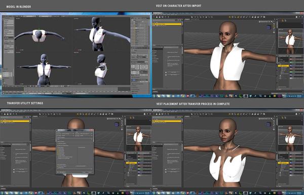

    1. load your character . (about this case , I load Gianni6 then it actually change scale108% too)
    2. load your clothing (which shape should fit to character) obj, (or prop)
    3 set transfer utility
    source = current , target = current
    4 check "reverse defomation" on.
    Picture 1
    5 it seems work about daz studio 4.7
    (I think,, it have not worked what I expected before,, eg ds 4.5 etc,) but do not remember old days.
    now it seems work for me ^^;)
    Picture 2
    Ad you see pic2, when ds auto circulate reverse defomation, there should be some un-desireble defomation for clothing.:ohh:
    because ds need to adjust clothing shape fit to default genesis2male shape first. (reverse defomation)
    then re-apply auto generated morphs shape again.
    in these two step, your modeling clothing shape have been deformed somewhat.
    then you may better to make clothing shape fit to default genesis2male (or genesis1, genesis2female) first.
