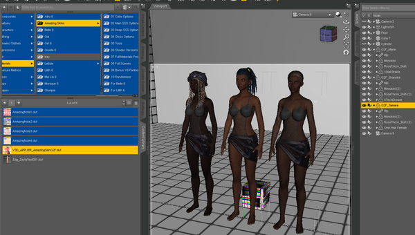

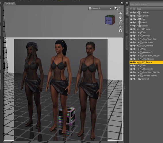

    http://www.daz3d.com/fwsi-marie-hd-for-monique-6
    http://www.daz3d.com/fw-shaneka-hd-for-monique-6
    http://www.daz3d.com/fwsa-tamara-for-monique-6
    I chose them to show the variation in the skin tones, stock.

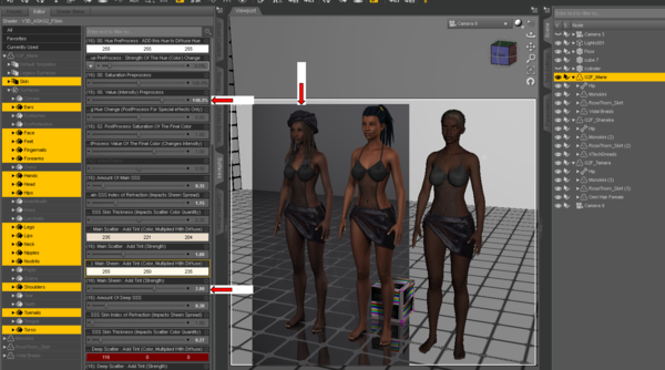

    "O" yea, faceplant time droped from over 2 minutes, to under 7 seconds :cheese:
    Marie, has lost some of that sheen in the transfer. Remember what I said about sometimes the 'backing color' doesn't get transferred over. Doesn't matter, were changing her skin tone any way.
    "O" in promos, they love having 'Specular' lights blowing out the sheen, to get that side effect of halo. My test chamber is NOT doing that deception trick. Bringing up the gloss intensity would also do it, and coloring the lights as well. With Amazing Skins, we can make her look like the promos, next to other figures under uniform lighting (No special lights for each figure).
    (EDIT)
    And with a single dial "00. Value (Intensity) Process" near the top, she is now slightingly brighter toned.
    I held the Ctrl key after selecting 'Skin' to add by clicking on Fingernails, Lips, and Toenails to the list.

    And adjusting the sheen a tad, to get some of the 'details' back. I could probably back off on the brightness (top labeled dial) a tad, with the increased sheen (lower labeled dial). I trust tho, the idea is shown quite well?

    And adjusting the sheen a tad, to get some of the ‘details’ back. I could probably back off on the brightness (top labeled dial) a tad, with the increased sheen (lower labeled dial). I trust tho, the idea is shown quite well?
    Much better! The idea is well shown. You can do it the way you do it or you 2 have other parameters to play with the sheen :
    1. Increase the total amount of main SSS (will increase your sheen and Main [edit] Scatter)
    2. Increase the main index of refraction (will "spread" a little bit more the Sheen)
    Don't increase the deep SSS things, it is really not useful for dark figures!
