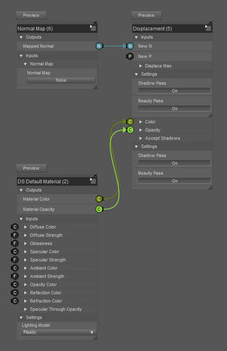

I'm trying to write a script that, among other things:
1. stores the image used as a normal map for each surface
2. loads a new shader preset (that was created in shader mixer)
3. applies the stored normal map
Attached is a screencap of a simplified shader preset (algo-01.duf) that illustrates the problem, and below is a small snippet of the relevant code, followed by the log.
A sphere is created with the DAZ Default Material applied and the file "normal.jpg" is assigned as the normal map before running the script. The call to getNormalMap() is working and the shader preset gets loaded, but the normal map does not get set.
normalMap[arrayIndex] = mat.getNormalValueMap();
oContentMgr.openFile(thePath + "algo-01.duf", true);
mat.setNormalValueMap(normalMap[arrayIndex]);

  • Richard HaseltineRichard Haseltine Posts: 112,156
    edited March 2015
    The NormalValueMap functions are part of dzDefaultMaterial but not DzShaderMaterial. Shader Mixer shaders are either DzShaderMaterial or a special case (DzBrickShader?), I can't recall, but they certainly aren't DzDefault Material. Instead you need to make sure you use a sensible name for the property, then use findProperty() to get it for the Shader Mixer shader. I would strongly advise checking that you have received what you asked for at every stage - it's true that the nested if ( check property ) {} blocks can get a bit intense as you scroll right to read the actual code, but it does make it easier to find problems.

    Actually, I think even aside from how you get the normal map property you should probably be getting the material afresh after applying the .duf.
  • algovincianalgovincian Posts: 2,715
    Thanks for your prompt response, Richard. I appreciate you taking the time.
    I decided to take a different approach and use copyFrom() in order to transfer the normal map and it appears as though that will do the trick. Your reminder that I needed to get the mat again after loading the duf pointed me in the right direction.
