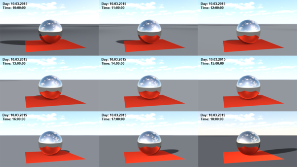

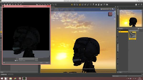

    Somehow I am doing something wrong. When I appy by example a nice deep blue sky with Clouds and sun, in Iray the dome appears very pale. When I pull down the Environment intensity, the Scene gets to dark. Basically no matter what Image I load, it always brightens up and looses all its natural Color. Is that normal?
    Post edited by Ralf1958 on
  • Ralf1958Ralf1958 Posts: 688
    Here is what I mean.
    1262 x 631 - 172K
  • thd777thd777 Posts: 946
    edited March 2015
    In my experience it is best to leave the sky dome intensity near its default value and instead adjust the tone mapping. So if the scene is too bright, reduce the exposure by shortening the exposure time or lowering the aperture (in the tone mapping tab). I am not at my work station right now, but I can show you an example in an hour or so.
    Ciao
    TD
    Post edited by thd777 on

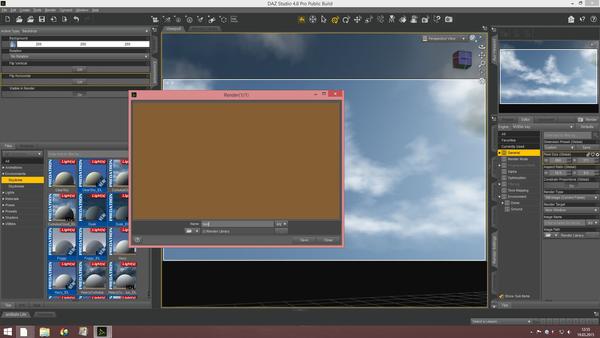

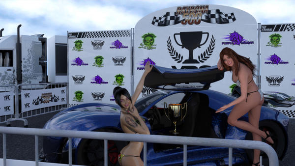

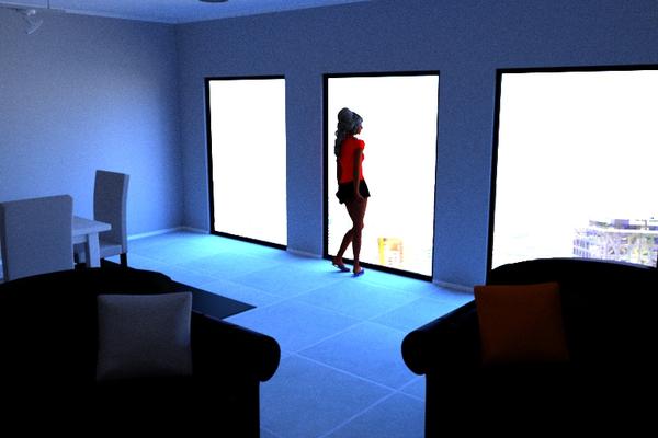

  • SpitSpit Posts: 2,342
    I'm not absolutely sure what you're going for here but I made some assumptions. In any case, what I did is for someone who has a background image they want to have behind the scene and also get their light from it.
    Starting from a blank slate...meaning no prior changes in settings to mess me up...I opened Studio and
    (1)Called up the render settings and only dealt will the environment category in the editor tab.
    (2)Environment = Dome and Scene (including Scene means if you add Photometric point or spot lights they will function)
    (3)Dome Mode = Finite Sphere (because the image I'm using is relatively small)
    (4)Draw Dome = On
    (5)Visualize Finite Dome = Off (The background I'm loading doesn't really fit a sphere so this would look bad. I basically just want the colors and am using the actual image as the background.)
    (6)Environment Intensity = 1.00 (default)
    (7)Environment Map = I loaded a painted sky from my backgrounds folder. The default setting is 2.00. I'll change that later.
    (didn't touch anything else in this panel until the final entry where I told it not to Draw a Ground. But you probably want to because you'll put something in the scene and want ground shadows. In my case I want no ground so I turned this off.)
    (8)Now I went to the Environment Tab and loaded the same background image -- it was already in the list so I just selected that. Be sure Visible in Render is ON.
    A problem might arise, however, if the aspect ratio of the image doesn't match yours. In my case it doesn't but I don't care. You can change the aspect of your scene to match the image if you wish. I did that the other night. But for the life of me I can't remember how. :(
    Okay for a test render. And I think HERE is your problem. If your environment is Dome and Scene (or Scene Only) the headlamp will be on in the camera.
    If your camera isn't in the scene list, create a new camera and when the dialog comes up, choose to reveal the advanced settings, and then select the 2nd option which is 'Copy Active View'.
    Now select this camera in the scene pane and also choose this camera to view through. In parameters the 'headlamp' entry is at the bottom of the list. Turn it off.
    If you have anything in the scene it will turn black. Don't panic and just hit render.
    If the light level is not right (mine was a little too bright) you can go back to the render settings/editor environment. I left 'intensity' the same, and reduced the setting with the environment map from 2.00 to about 1.4.
    Test render again. Then do whatever else you were planning to do. (I tried making the tiny windows and lamps light emitters and no success yet.
    Oh, you can go back and turn the headlamp back on so you can see what you're doing. Just be sure to turn it off before doing a render.
    424 x 600 - 283K
    473 x 469 - 43K

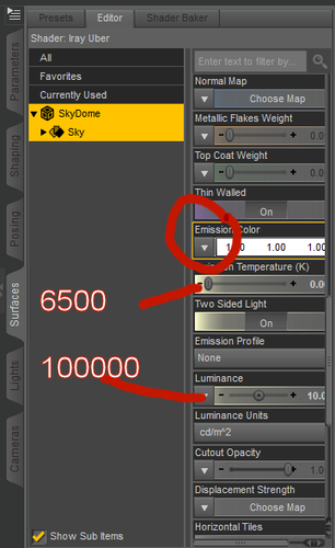

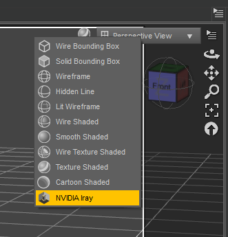

  • barbultbarbult Posts: 27,475
    When your viewport turns black because of your lighting/environment settings, just hit CNTRL+L to toggle preview lighting off. It will let you see and manipulate your items in the viewport, but won't affect the render at all.

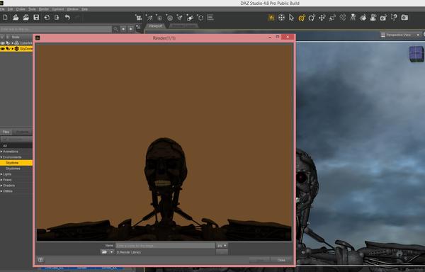

  • R25SR25S Posts: 595
    I also get stuck with Skydomes and iray.
    Whatever I try (Emission Shader, Maps, change of intensity, and so on) nothing works. The final Render always is completly black or brown or some other Color (see Sample Pictures) or it is nearly white like the whole Scene is watched trough thick fog.
    1502 x 961 - 112K
    1920 x 1080 - 171K

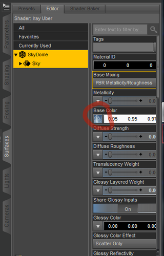

    @ R25S - Normal Skydomes are not working. They wont let the light get through. So far I understood, you Need to set a Background Image instead of a skydome. That's it.
    If you wanto to have the Iray dome to light the Scene through a map, then you Need to set also an Environment map for that.
    Correct me please if I am wrong. :-)
    402 x 274 - 14K
    Lots of questions....
    You can still use skydomes and have them visible. You need to apply the emissive preset and set it as double sided otherwise the light only radiates from the outside of the dome out to nowhere. Not doing that will give no light on your scene. You can determine the dimensions of the skydome as well.
    What I was doing in my little tute was showing how to have a map light the scene and have it as a background without the use of a visible skydome. The specific background I used is not an environment map and would look horrid wrapped around a sphere so I didn't have a visible sphere in the scene though still lighting the scene. In that case I put the image in both the environment slot in render settings AND the backdrop slot in environment pane.
    I'm sorry you came to a specific conclusion that you can't use a skydome unless you also have a background picture from my tute. I thought you had loaded a background and wanted to use it to light the scene (which I showed you how to do). I probably misunderstood you.

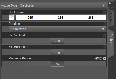

    unfortunately it doesn`t work for me...
    when I follow the steps it turns out (completly brown) like this...
    1920 x 1080 - 223K
    You mean the steps from the previous page? I did not add a skydome to the scene. It looks like the color is from a light from the skydome that's selected, which doesn't make sense because that would be a light for 3delight not for iray.
