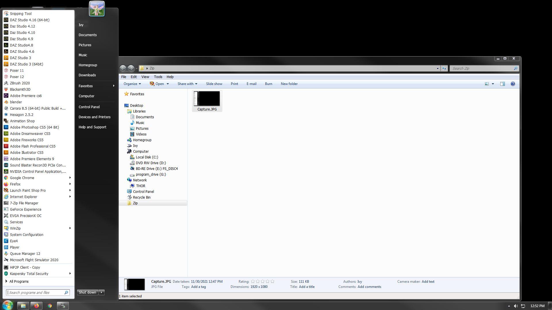

    I bought this tool a couple of days ago and have been playing around with it. & I have a few words on this product for what it worth . I have not posted any demos videos of it
    First in case anyone is wondering . This worked for me in daz studio version 4.12.0.86 so I figure it must be based on the 4.5 SDK code for those using older daz studio versions.  like I said it worked for me but i won't guarantee it will for others I have a pretty complex computer set up for animations.
    If your looking for a FK/IK solution this is not it . you still have to make primitives just like before when setting up your Ik-chains. and it does not work using Null's like a Ik-chain will
    its does calculate all keyframe & sub keyframes required movements in the animation automatically which I found amazing because is very useful in not having to do all the movements by hand.  someone above mentioned  that this was similar to mcjAutolimbj-script  . I find limbstick to actually easier to set up. and you can customize the timeline movements & timeing.with limbstick.   I found moving the limbstick scripts properties panel tab down to the to timeline level makes it easier for me to use in the animation work flow using dual monitors
     I found the set up is super easy.  this is great for when you need your character to keep their certain body parts pinned to a prop or another characters.  I bought this because I hope it will be very handy for making adult animations to pin genitals together. because it very time consuming calculating the movements by hand as of now. & I am hoping this will be great for things like using Num-chuks & fighting staffs in animation as well. because without a script calculating all the movements it has just been impossible to accomplish.
    The negatives & draw back I found right off is it does not work as a 1 click hard surface pinning solution. if you plan on using it for seamless interactions . you will still have to make a stop/ cut scene or stop in the animation to make your parent attachment run script and then resume your animation cycle so the script can calculate the movements. it does not automatically parent the props .  example would be if your picking a sword off the ground you.  you can not just walk over and pick the sword up.  you will have to stop the animation cycle just as the characters grabs the sword . . then attach/parent the sword prop and resume the animation the script will then calculate the proper hand, wrist and arm movements of the sword when its being picked up. But you will have to still manually parent the sword unless I am missing something in the instructions
    Its the same as if you were making 2 guys greeting each other and shaking hands.   when the guys greet each other before the hand connect together, you will need to still stop the animation on that keyframe on the timeline then apply the limbstick to the sphere primitives for each hand, then run limbstick script  to calculate the hand shake movements which will resume your animation on the timeline. so to me that is the same set up as it is working with the ik-chains as well.  to make the body part to attach/parent and unattached/unparent it does not do the parenting on the fly so to speak sad   So foot pinning during walk cycles such as if you are trying to make a characters climb stairs, or uneven terrain. you will still have to set up the limbstick the same way you would for a Ik-chain. by creating a primitive for each place the feet will step along the path so they have a place to attach to & limbstick will calculate the proper body movements for climbing the stairs. . i could not get the hand to pin to the hand railing on the stairs at the same time as the feet were pinned to the steps. and like I had mentioned it does not work or recognize Nulls which I use a lot of Ik-chains because I can attach multiple ik-chains to a null where i can't using primitives.
    I am sure that I will have to work with this a little more to work around these issues to make this product work better for me. . i just got this product and I am still figuring  out how to use it .
    My conclusion is this will be very useful for me in animation use because once a prop or character is parented the script does all the movement calculation automatically on the timeline .where before when i used Ik chains I had to do it all by hand manually so I am hoping this will speed my work flow up. when hand keyframing animation.
    Good Job 3DU . this is 100x better than your glue to the floor script.  thank you for keeping us animators in mind.
     screen grab of all my Daz programs on my start menu so maybe thats why this script works in daz 4.12  click to enlarge
    1920 x 1080 - 175K
    Post edited by Ivy on

    Glad it works for you!  Means might work for others too?  Would be nice to hear from others.
    I checked my net framework win10 version as I never checked this yet with so much else to do on new PC.
    Supposedly since net4.0 everything overwrites etc in same dir C:\Windows\Microsoft.NET\Framework\v4.0.30319.
    Right-click accessibility.dll and see details>product version.  Mine shows latest 4.8.* net framework and MS won't let me install older 4.5 sdks cause it says all is up to date.
    So not sure why i got error in 4.12.0.86 whereas in beta 4.16.1.2the script works well.
