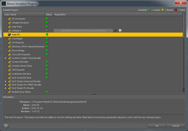

Can't Register or Use Auto Fit
geoffmccabegeoffmccabe Posts: 39
I just purchased Auto Fit but I can't figure out how to enter my serial number.
The instructions are simple and clear, but no "Register" button is appearing. So how do I register this? Of course I've tried shutting it down and restarting.
I've also tried just doing it, but Auto Fit doesn't seem to come up as an option when I need it. I've tried dragging and dropping clothing made for V4 onto my V6 figure but there's no Auto-Fit in the menu of options. I've tried all the available options, but nothing happens with any of them.
I hope you have a suggestion to make this work.
Thanks.

  • fixmypcmikefixmypcmike Posts: 19,742
    You don't need a separate serial number for Autofit, just the free DS4 Pro serial number.
    And to Autofit from V4 to V6 you need http://www.daz3d.com/victoria-4-for-genesis-2-female
    The autofit clones that come with the free Starter Essentials are only for one generation back (e.g. V4 to V5 or V5 to V6), to go 2 generations back you need add-ons.
