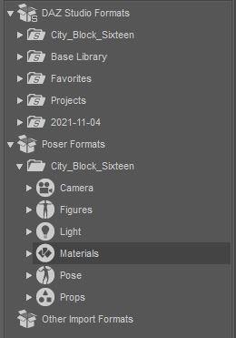

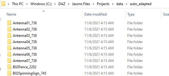

    I unzipped one of Dreamland's city blocks, because I know that used to create a ton of auto adapted files. Set up a simple scene and then poked around and couldn't find the files. I was a bit perplexed at first, then I figured out what was happening...
    If I recall correctly, DS used to create the auto_adapted files when the model was loaded into a DS scene.
    Now it seems that DS creates the auto_adapted files when the scene is saved. Which was why I couldn't find them until I went back in and created a new scene, then saved this time.
    DS also now creates the files under a different runtime directory:
    I don't have any logical reason for why DS picked this directory to save under. It seems quite random since "Projects" isn't my first content runtime, it's not in my Poser format runtime list, and its not the directory where I saved the scene file I just created.
    Lastly, this is why I extol the virtues of Content Gatherer:
    It opens the scene file, shows you all of the assests you are using, then shows you where you can find them all. Regardless of how many runetime directories you span. It will then produce a list of those files or zip them up into a nice little archive with all the files in the right directories. And, in the case of projects that span multiple runtimes, reduces them to a single runtime.
