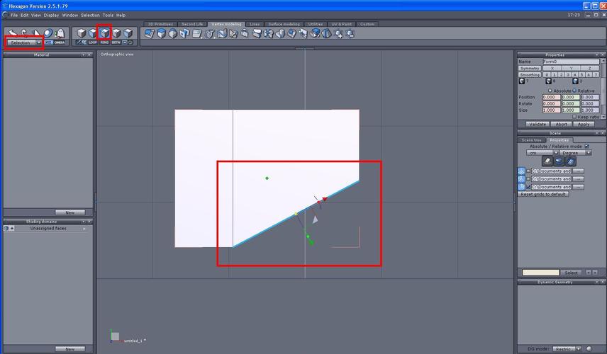

  • edited August 2012
    m_m_italy said:
    But I can not find a way to move the point as I have shown.
    In summary move a point along a line inclined .....
    I think what you want is called a "near" function in other modeling programs. In Rhino, for instance, you can highlight a point and drag it up and down the line. Since your cursor is "near" where you want the point to go, the actual target location will be ON the line.
    Unfortunately, I don't know of any such equivalent function in hexagon. You can "snap" selected points to edge midpoints or other points perfectly, but you can't drag them along a line with any great precision.
    Roygee and Patience have both given viable examples, but I'll toss another procedure on the pile.
    First it appears that you're working with a 6 sided n-gon defined by points 3-4-5-6-1-2 as I've illustrated on your image. It may (or may not) be helpful to turn it into 2 quads 3-4-1-2 and 4-5-6-1, but that's a different issue. (ADDED NOTE: see my NEXT post to see what the numbers mean)
    If you don't want to tesselate or and/remove points, the following sequence may be of use to you:
    720 x 423 - 86K
    720 x 423 - 127K
    720 x 423 - 125K
    720 x 423 - 131K
    720 x 423 - 115K
    Post edited by emfederin_9bc0c524c8 on

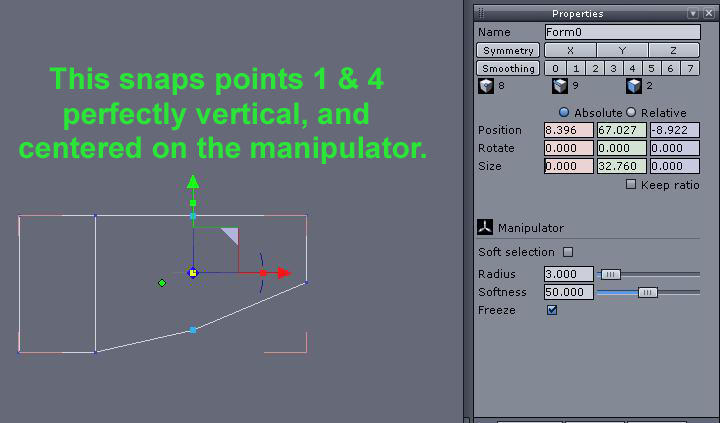

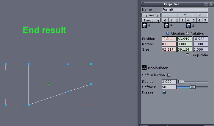

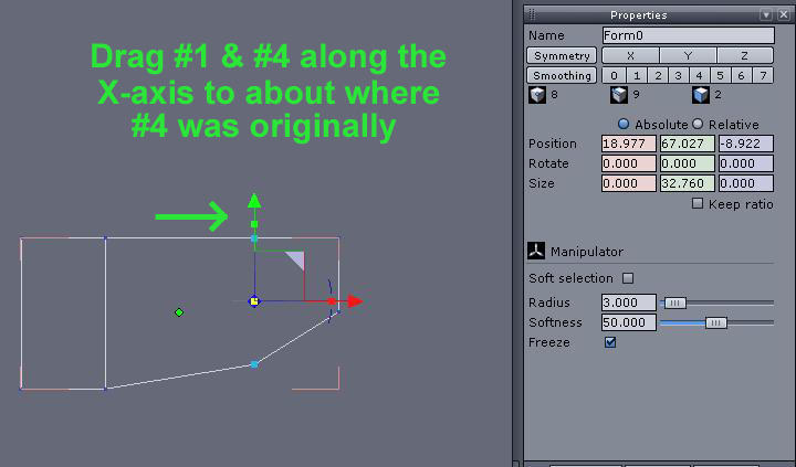

  • edited December 1969
    BTW, DAZ makes you go through hell posting images, and limits the number to 5.
    If they permitted 6, then the following image should have been posted up top, since it serves as a key to what I'm talking about when I mention points by number.
    Thanks DAZ, for this really slick new web design. It's SO helpful to everyone... :P
    720 x 423 - 107K

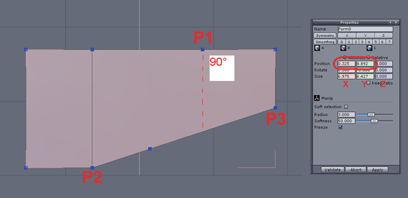

    Anyway MM, let's go straight for the throat, and do some magic.... :)
    In the following image, I have 3 points marked P1-P3. To the right is the "properties box", and I have 2 positions circled.
    Select EACH POINT separately, and write down the X and Y values for each one that appears in the circled boxes.
    Post these 3 sets of XY coordinates, and I'll come back and tell you where your other point goes.
    ADD:
    Just had another thought...with my above proposition I'm assuming that all the Z values are the same on your shape (IOW, the Z value in the "size" row is "0.000"). The other Z values can be non-zero as long as they're all the same value, so let me know if they aren't.
    800 x 388 - 74K
    m_m_italy said:
    To summarize my question was:
    [can you] slide a point along a line inclined?
    I think my answer is: no
    In hexagon yes, the answer is "no". :-)
    But in life there are far more serious problems
    And here the answer is "yes". :)
    But that doesn't keep geeks like me from trying to have fun with the lesser ones like this, and by using slope intercept, you can CALCULATE where the point should be moved to, and you'll end up with exactly what you wanted to do by sliding it there.
    But instead of sliding it to where it should be, you just enter the calculated XY coordinates and it pops to where it should be.
    This is no problem for a single point such as you have here, though admittedly it would be far too much trouble if you had to do it repeatedly.
    If you want to try it yourself, the equation for the slope of a line ("m") is:
    m = (y1-y2) / (x1-x2)
    Where x1,y1 are the XY coordinates for P2 and x2,y2 are the XY coordinates for P3.
    Once the slope is found, then you can find the Y-intercept ("b") with:
    -b=mx-y
    Where "x" and "y" are the XY coordinates of either P2 or P3. Note that "-b" is the negative value, so for "b" you need to flip the sign.
    And finally you can find the Y coordinate for the point you want to move by using the slope intercept equation:
    y=mx+b
    Where "x" is the X coordinate of P1, and "b" is the Y-intercept from the last calculation
    So finally, the coordinates you want to move the "sliding point" to are:
    xfinal,yfinal
    Where "xfinal" is the X coordinate of P1, and "yfinal" is the slope intercept from the last calculation.
    So you would select the point you want to move, type in the xfinal and yfinal values from the last calculation, hit enter, and the point "pops" to exactly where you would have put it if you were able to "slide" it. - which is EXACTLY on the line between P2 and P3, and 90 degrees from P1.
    you can slide a point along a line inclined?
    I think my answer is: no.
    Try this:
    With the point selected, change the manipulation mode from "World" to "Selection," and the manipulator gizmo should re-align along the line in which the point resides (see attached image).
