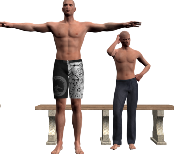

Hello, newbie lurker here. I was playing with some morphs for characters based on Genesis 2, and I ran into a bit of a problem...
I moved my G2M over to Hexagon, tweaked the mesh, and sent it back. When prompted, I chose to import as a morph and saved it. Then I spun the new dial and voila! My Genesis giant was born.
And then I tried to pose him, and his body did things no human body should ever do. :(
Can anyone tell me what I'm doing wrong? I did a quick and dirty render before and after the morph, posed and unposed, and with a regular old G2M for company.
Thanks!

I just love the guy scratching his head in puzzlement at the antics his buddy is getting up to:)

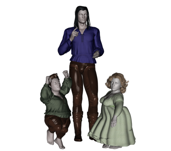

You are a rock star! That was the missing step! :D I was able to create new morphs that scale Genesis both up and down. WOOT! Behold, some hobbits and a Dunadan.
*happy dancing* Glad it worked for you as well. I was thrilled when I stumbled across it. :)
