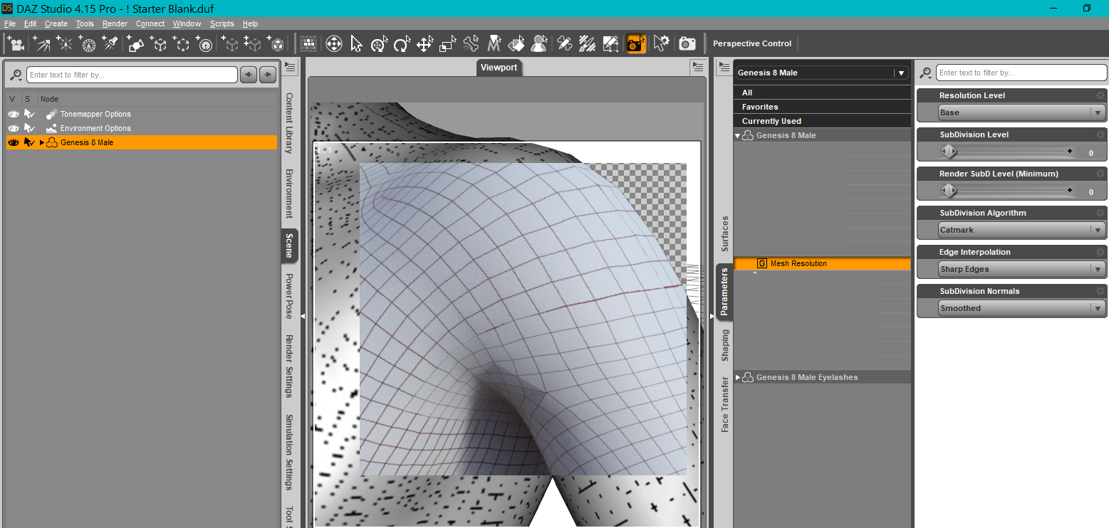

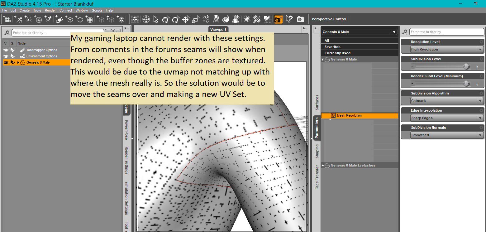

    This is where I'm at with this project atm. G8M.
    I have also attached the templates with a red background to facilitate the arrival of a render that I can use in the tutorial :-)

    Whipped together a little tutorial - it's in my proof-reading basket. Does illustrate how to make a new uvset. Does illustrate why one should use the bridge to get the figure to use [even if then going to export it out again from Hexagon to use it in certain other modelers]. While buffer zones are necessary to catch the seams, if the mesh is not with the template - the uvmap lines needed to be brought closer into the island. And there is a little bonus eye information too.
