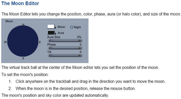

Moon editor - size of the moon? i don't see it
MistaraMistara Posts: 38,675
says here "The Moon Editor lets you change the position, color, phase, aura (or halo color), and size of the moon."
sounds kewl to make a sky dominating moon.
how to size it?
thanks!

    All you can do with the moon is adjust the position via the RSE or in the Assembly room. Using the RSE, you can only adjust the aura, tilt and phase. You can't adjust the size unfortunately.

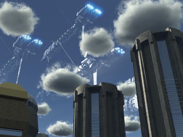

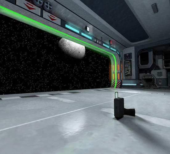

    If you place an image in the Scene's Backdrop, and also use a realistic sky, the image will appear behind the atmosphere. The same is true for an image in the scene's Background.
    Remember, the Background wraps completely around the "universe," so a spherical render looks best. The background will also be reflected in surfaces with reflection and anything in the Background will act as an IBL when the Skylight is enabled in the render room. HDRIs will work better for IBLs.
    The Backdrop is just that- a backdrop. It will not reflect and it cannot effect the scene's lighting. If you have an object in the scene with transparency and refraction, the backdrop will display correctly behind it. The Backdrop image should be the same aspect as the rendered image to avoid distortion for example, the image fills the entire production frame, so if you load a portrait in the Backdrop and render a horizontal image, the backdrop image will look distorted. using and image, movie, color, or color gradient in the Backdrop, will hide an image in the Background, although the Background image can still act as an IBL and be reflected in reflective objects.
    Again, both the Background and Backdrop will appear behind a realistic sky.
    Here's a video where I used a movie file as a Backdrop and a simple plane and replicated, animated grass blades, both with a shadow catcher applied:
    https://www.youtube.com/watch?v=_8puXTRXt7Y
    Here's an image with an image of starships placed in the Backdrop slot:
    2000 x 1500 - 1M

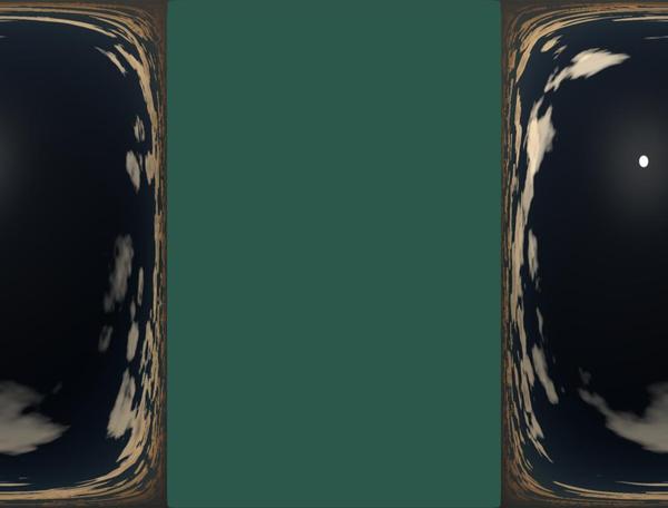

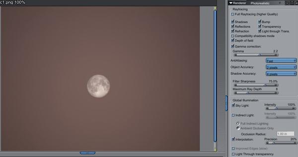

    well, i learned realistic sky disappears when making png or psd, it renders then disappears right away. i thought my graphics card was broken. works fine with jpg.
    made a nice jumbo sun. couldn't close-up on the moon.
    spherical camera made some funny renders. :lol:
    1053 x 800 - 45K
    1053 x 800 - 20K
    1053 x 800 - 15K
    1774 x 885 - 143K

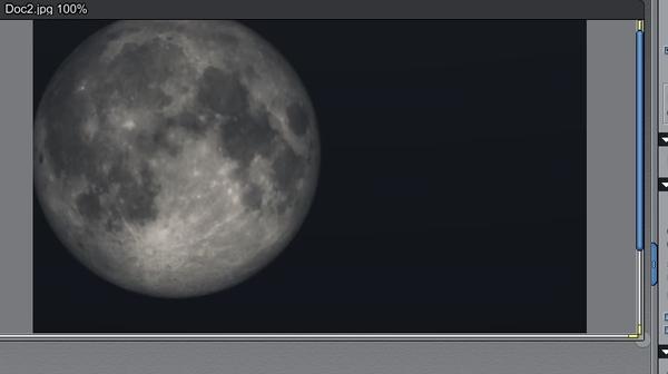

  • JoeMamma2000JoeMamma2000 Posts: 2,615
    You can do moon closeups n stuff if you use a real sphere with an image on it....that's why it's kewl.
    1200 x 1086 - 258K
    nice :)

    I'm thinking you have the Alpha channel option enabled in the Render room. png and psd both support alpha, and if you're using straight alpha in the render, then the sky would appear to disappear.

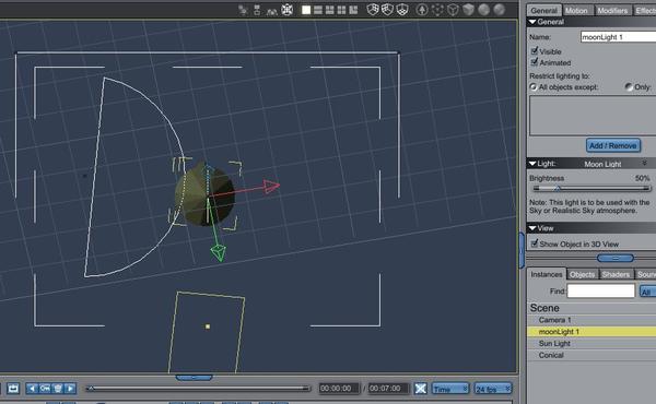

    there's no way to 'point at' a camera at the realsky moon or sun?
    or easy line up a spot or distance light with realsky moon and sun?
    there's something about lining up for rainbows and lens flares.
    for fun, i want to animate a sunrise to sunset with big puffy clouds drifting
    thanks :)
    thanks :)
    You can see a representation of the moon or sun disk, and manually point your camera at it.
    Here's a link to get you started:
    http://www.daz3d.com/forums/discussion/51389/#748190
    To see the wireframe, the sunlight or moonlight must be selected. Also, read down a few posts as there are tips and troubleshooting about using it.
    thanks!! helped make some progress. :)

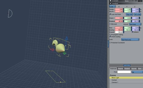

    selected the light to see the sun,moon wire frame.
    when i selected the camera to aim at it, wireframe disappeared.
    tried cam 'point at' to the light, it doesn't follow the wireframe

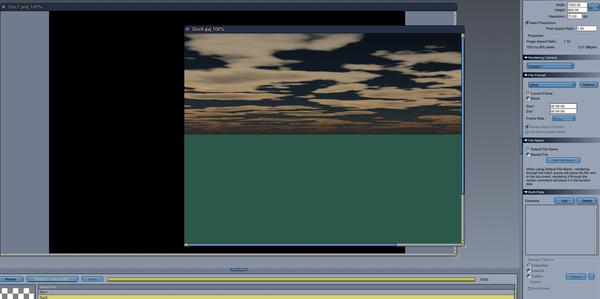

    saw the circle thingee in realsky editor to make the clouds blow around for an animation.

    To see the little wireframe, the light needs to be selected.
    The target helper is like a null object. Look for the target icon at the top of the Assembly room window. The Point at modifier won't point at the moon and sun wireframe as that is strictly a guide as to where the Realistic Sky's sun and moon disk is located. It's not like a light or object that can be pointed at.
    the light reorients at the wire frame, points from the top of the moon representation side, not the arrow side.

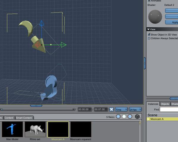

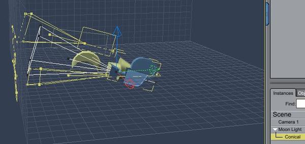

    sent a conical camera and the moonlight to origin,
    was thinking could line em up and parent the camera to the light
    or vice versa then the camera would track the moon.
    sorta works. maybe is a hotpoint thing, origin line up is close, don't know what the camera is thinking.

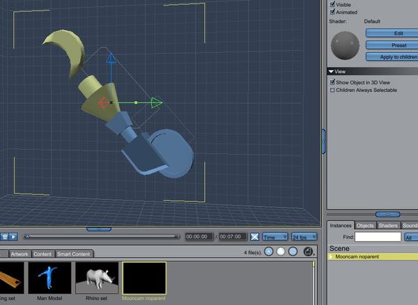

    and then if i group the light and camera, should be able to save them
    together as a group. testing this theory :) ...
    when i drop the saved group into the scene, camera and light aren't
    rotated together the way i saved it.
    maybe group without parenting? ... nope.
    3#mooncam group as dragged into tray.
    4#mooncam group dragged from tray to scene
