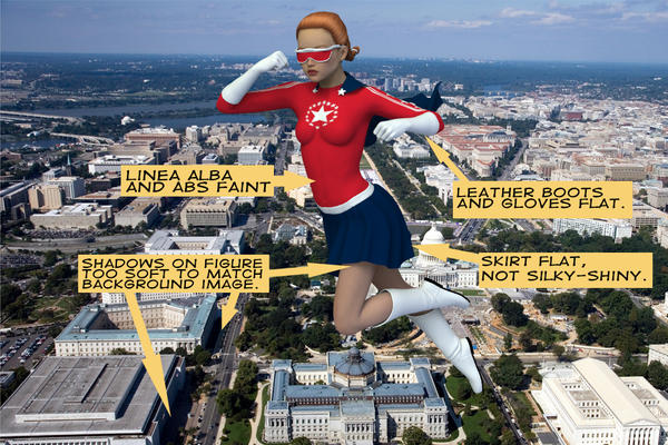

Let me provide an example. I have this patriotic stars-and-stripes heroine for a webcomic I am working on. Since she is a patriotic character, I am working on an image of her flying over Washington D.C. I found a nice daytime overhead shot in the public domain, and I'm trying to match the lighting to it. But the scene has some fairly strong shadows, which I don't seem to be able to get using HDRI lighting in UE2. Furthermore, I have noticed that a lot of the detail seems to "wash out" with UE2. Now, I know this is affected by both the intensity of the light and the gamma, and I have tried playing around with it. But I have to say, just using the default DAZ lights that everyone seems to think are so inferior, I have not had to play this much.
Here are two shots. In the first example, we have DAZ3D default distant lights. I used a simple 3 point setup. The intensity was something like 85% Key, 42% Fill, 100% Back. Key was placed to mimic the angle of the sun in the background shot behind the character. Notice some factors here. First, the character's not muscular, but still, her linea alba and other ab muscles are visible through her G2 suit. This is proper for superhero characters - their muscles, if any, should be visible through their costume. Second, the intensity of the shadows is a reasonable match to the background. Third, her skirt, which is the Kiriko one that I just recolored blue and white, looks silky and shiny, which is how that skirt comes "out of the box." And finally, the gloves and boots look shiny, as they should, because they came out of the box like that (think shiny, highly polished leather). Using standard beginners' 3-point-light techniques, I was able to quickly and easily match the background image.

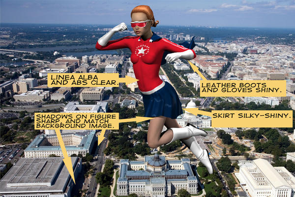

The second shot is with UE2 using the "park" HDR, which may not be the best, but it works better than the city one I found somewhere else online (that one has too much blue in it and screws up the colors, making it a poor match for the DC background image). I rotated the HDR image so the sun in the shot was coming from the same exact spot as the Key Light in the 3-point DAZ light setup above. Notice that all the things I mentioned above are reversed. The ab muscles are less clear. The shadows are too faint compared to the background image, which makes the figure blatantly mis-match the background. The skirt looks flat and textureless (I did not change anything but the lighting in this scene, so the texture should not have changed). And the gloves and boots look flat, no longer like shiny polished leather.
Now, I can see that there are some advantages to the HDR, because it handles indirect, bounce, etc style lighting without needing multiple lights. And I am sure I'd have achieved a better result using the DAZ lights if I had used the 7-point system (or 6, since I did not need a background light in this case), with bounce, ambient, etc, light sources. But my point here is that I find the second, HDR lighted character, to look very flat... more like a cartoon than a 3D character. And I think the overly-soft shadows are part of the problem.

Adding a sun/distance light may bring out your spectacular enough. If not you can add a specular only light to pop it even more. It really depends on what strengths you end up with for the uberlight and the directional light. It is very unlikely that they will both be full strength by the way.
Without a good directional sun the lighting your using is a bit more like a bright day when the sun has dipped behind a light cloud. Still plenty of reflected light but no clear sun to cast shadows.

One important thing to note with UE2 is that it doesn't handle specular lighting. You'll either want a dedicated specular light source or other light to handle the shine.

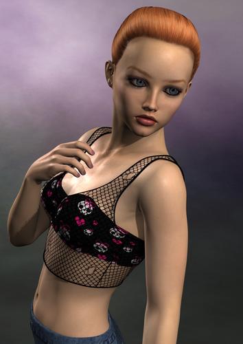

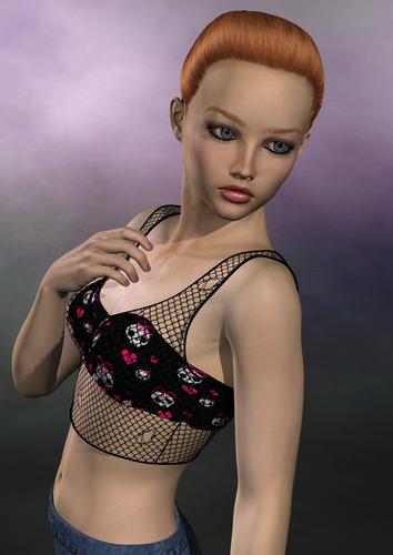

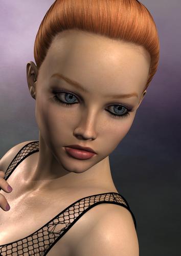

Regarding the skin of the figure I am using... here are some other tests. First one is just a 3 point light setup using standard DAZ spotlights. The second is a Key and Backlight with a softbox HDRI UE2 light as the "fill" (instead of a directional fill). Key and Back Lights are at 80% intensity in both cases. Fill is at 40% in the 3-point setup. Soft Box is at 100% intensity. There is a separate background light for the background (which is irrelevant but I mention it for completeness). I know that the lights are not set up in the perfect position, but I think this gives a good view of the skin texture. I agree that the skin still looks a little "flat" here (although better in than in the above shot).

My guess would actually be that she needed a bit stronger specularity no matter which lighting you use. Not loads, but enough to give her a bit more shine where the light is hitting her.

I've played around with it. Turned the Specular Glossiness (both) to 80%, and lightened up the Spec color from dark purple to a pale lavendar. I turned SSS on and set it to 10%. I think the result is looking better.
