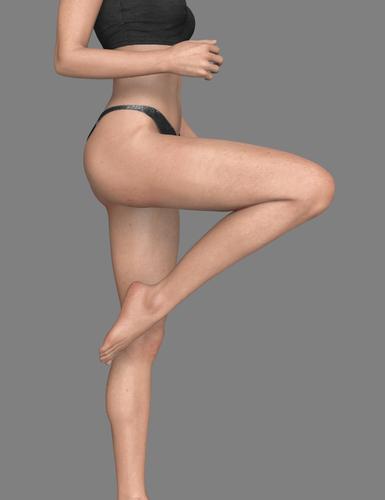

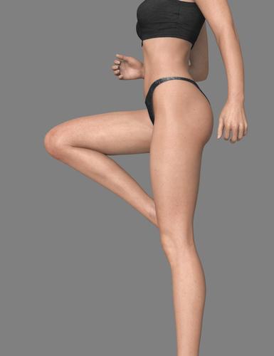

    This is with the current developer build. So it's not released yet. V6 with no additional morphs.
    jasonk said:
    The user says it works with any Genesis 2 Female. Which is what I'd expect of any Genesis 2-based pack like this...it'll work with any Genesis 2 Female, though it may only look good/best with one or a few of them.
    Looking back at that thread, I think he has to dial down the strength for G2F. Beautiful Bends is build on G2F first and foremost, taking into account how the corrective morphs look with other shapes. I try to avoid making FBM specific correctives whenever possible. Victoria 6 and Girl 6 didn't have FBM specific correctives. For Gia, I think the only FBM specific correctives were for the knee bend. There are corrective morphs for the feet, but those are not JCMs.

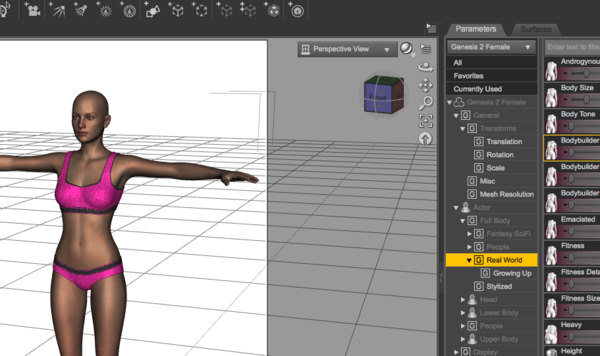

    I purchased and installed this product. I do not have a dial under this path...
    Actor/Full Body/People/Real World/Beautiful Bends
    There is no Beautiful Bends under...
  • wowiewowie Posts: 2,029
    edited April 2015
    Check if you have 'Show Sub Items' checked. If you have it checked and they still don't show up, try this.
    Open your morphs folder to check if the files used by the morphs are there.
    For the G2F version, the files location will be something like
    ...\My DAZ 3D Library\data\DAZ 3D\Genesis 2\Female\Morphs\wowie\Beautiful Bends G2F
    For the G2M version:
    ...\My DAZ 3D Library\data\DAZ 3D\Genesis 2\Male\Morphs\wowie\Beautiful Bends G2M
    If they're not there, then it's likely they're not installed yet.

    I installed the product with DIM. I checked that the files were located in the morph folder. "Show Sub Items" is checked. There is no dial here...

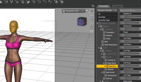

    Oh, I see it now. It's here...
    919 x 534 - 218K
  • JackReasonJackReason Posts: 144
    Wow, what a difference. Great product, thanks for your help.

  • kitakoredazkitakoredaz Posts: 3,526
    Though I may miss udnerstanding.
    Sorry but I do not think, your Disalbe (or Active) BB controllers work as you desigend.
    because
    1 I load default gen2female without tweaking BBDisableAll, (-100).
    that means your jcms is not active. is it right?
    2 Other BB jcm controllers as (-100) too.
    3 just bend gen2female Left thigs
    I suppose it should not change any actual jcm morphs (which change vertex positons)
    value of your products.
    but actually , many hidden BBjcms value have already changed. that means your jcm morphs are not disabled.
    then I think you may better make BB controllers without empty morphs.
    because when edit mode, many of your controllers are shown as morph. (M mark)
    but "BBcontrollers" under Fullbody/people/beautifulbends/Jcmcontrolls not include any morphs as you know.
    I think you create these controllelrs with empty morph opthons.(or you manually write code? I do not know)
    though daz seems not offer strict dsicription, about how to make controller ,
    usually most of controlelrs which not include actuall morphs are shown as "P"
    and actuall jcm or mcms FBMs which include morph defomation are shown as "m"
    so that user can easy check which morph(controller) actually deform figures mesh in edit mode.
    then they can remove or acjust the effect. or set auto follow etc.
    but if you add controller as "empty morph"
    it should be shown as morph"M" not controller "P"
    about your product controllers (they have only erc for other controller) not keep these rule I think.
    Check again. I think only the helper dials (needed for conditional JCMs) are active. If you're seeing an actual JCMs triggering (active), it's probably because I didn't enter the right value in the ERC code. I believe there's one or two in the current build, but that's already fixed in the dev build.
    Most of the ERC code were manually created (not using ERC Freeze), since there's a lot of conditional JCMs used.
