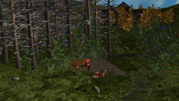

I am getting spots on the render. Do you know what do i need to change to fix the spots.
Are you using Deep Shadow Maps? Raytraced shadows will take longer to render, but don't have that problem.
Changing to Raytrace fixed the issue. Thanks for the response
