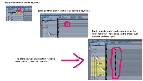

  • BC RiceBC Rice Posts: 591
    Here's a visual, in case that might help for what I'm trying to figure out.
    Thanks again.

  • JoeMamma2000JoeMamma2000 Posts: 2,615
    Y'know, there may be a way that I'm just not aware of...only because I recall having times when I notice that everything is keyframed and I didn't want it to be... :)
    But I'm not sure how that happened... :)

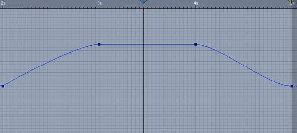

    Basically you memorize the figure pose, or selection tree pose, or whatever you want, at the time the "freeze" motion is to stop. Then at the end of the "freeze" time, you Restore Figure Pose, and that entire pose is moved to that new keyframe time.
    Again, you need to make sure your tweeners and tangents are good, or you may decide to manually make "freeze" time a little looser and more "organic" or natural and have some tiny motion.
    EDIT:
    Here's an image of the graph editor for a hip bone after a V4 pose has been Memorized and Restored at t=3 and t=4, and I did a little tweaking to the tangents to make it totally freeze in that interval, but also ease in and out to make it more natural.
    815 x 367 - 59K
