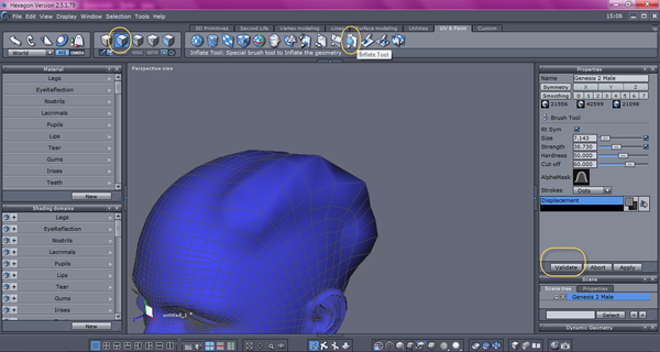

So I spent a few days working in Hex and am really liking it--now that I solved my original issue. Unfortunately, every time I try to use the UV/Paint tools, any of them, I get an "internal error" message, and the Validate button shows up in the dialog box. Doesn't matter how many times I click validate, the error pops up immediately.

Yes if you're morphing. Is that what you're doing?
Yep, I'm attempting when morphing. First was via importing V4 head only as an obj. Other times were through the Daz bridge with M6. Do those tools not work when morphing?
Yes they work, but as you've noticed, the process is touchy.

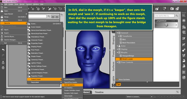

M6 is a morph of G2M so let's start with sending G2M base over the bridge to Hexagon ...
I'll fire up D/S ...

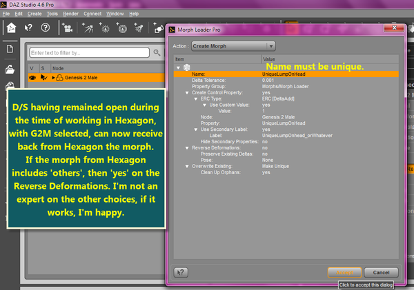

Fire up D/S, set affinity down some [free up some computer for other programs], load G2M, strip off all textures, base resolution, send over the bridge to Hexagon.
Now, to Make a Morph, learning the process ... pick something simple to start with. Like a lump on the head or whatever.
Okay ... made some images.

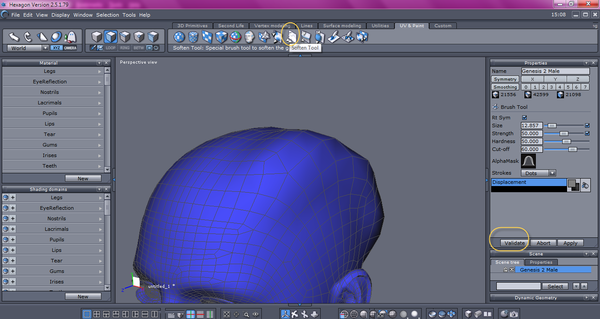

For morphing, I tend to use the 3 main brushes, smoothing, pinching and inflate.
Any of them can pose the error messages.
Since we were here figured might as well show the rest of the trip.
I'm using D/S4.6
