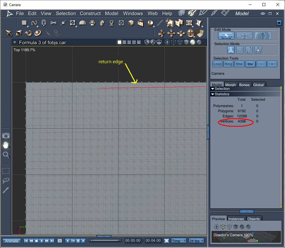

    Experiment #6 - Duplicate Verts
    Since your formula can define any x,y,z given the u,v i wanted to see what Carrara would do with duplicate vertices.  This formula does a modulas 5 to the result which basically will limit the range of the x and y values from 0 - 5 and cause them to overlap once.
    The resulting vertice count is 4096, which is expected if Carrara welds duplicates.
    Also notice that when the overlap happens there is a return edge generated when the x/y coords return back to 0 to start the second pass. (this is my assumption...)
    x=mod(u * 10.0, 5);y=mod(v * 10.0, 5);z=0;
    941 x 820 - 174K
    Post edited by mschack on

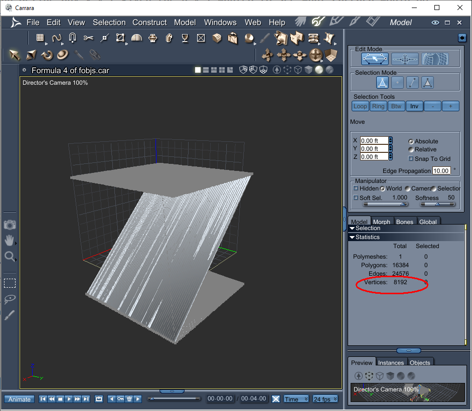

    Experiment #7 - Multiple z values
    So far we have only done a plane which more or less maps each u,v directly to x,y at a fixed z.  The result will always be a single plane, but if you look at some of the default objects provided with Carrara, you will notice that they all have multiple z planes, or said differently, there is more than one z value at each u,v.  This was a mystery for me until i understood that the x,y values don't necessarily have to map directly to the uv's given.  I partially showed this in the last experiment by overlapping the x,y values once,  Given this let's try to make the second plane from Exp#6 be at a different z.
    Here we will change the z value using the conditional statement.  When u < 0.5, z = 0.0, and when u >= 0.5, z = 5.0.
    The result is expected, we have now two planes of 4096 vertices.  Notice both planes are joined which means Carrara always trys to join subsequent vertices.
    x=mod(u * 10.0, 5);y=mod(v * 10.0, 5);z=( (u &lt; 0.5) ? 0.0 : 5.0 );
    941 x 820 - 193K

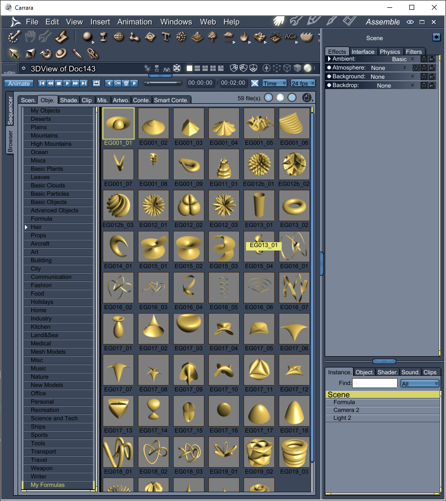

    I went through the french site (that Diomede mentioned above) and created some of the formulas,  some i added slider parameters.  Attached is a folder that contains all the .car files in a zip.
    Unzip the folder wherever you wish, then in the browser add that folder (see attached image "addfolder.png")
    zip
    zip
    My Formulas.zip
    430K
    941 x 820 - 355K
    912 x 1024 - 349K
