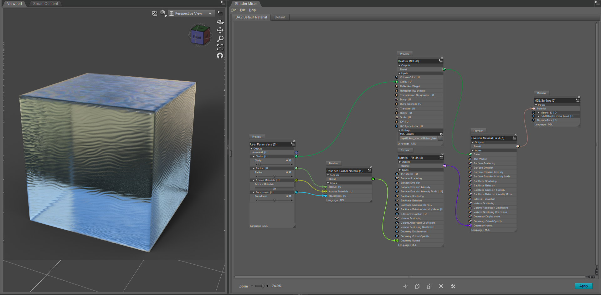

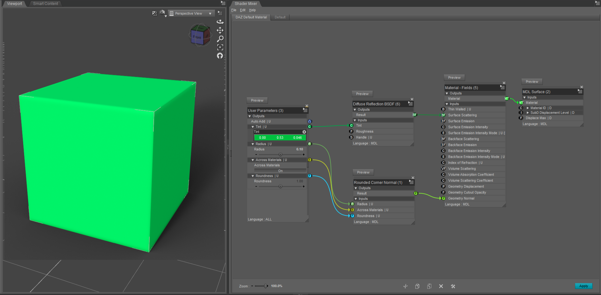

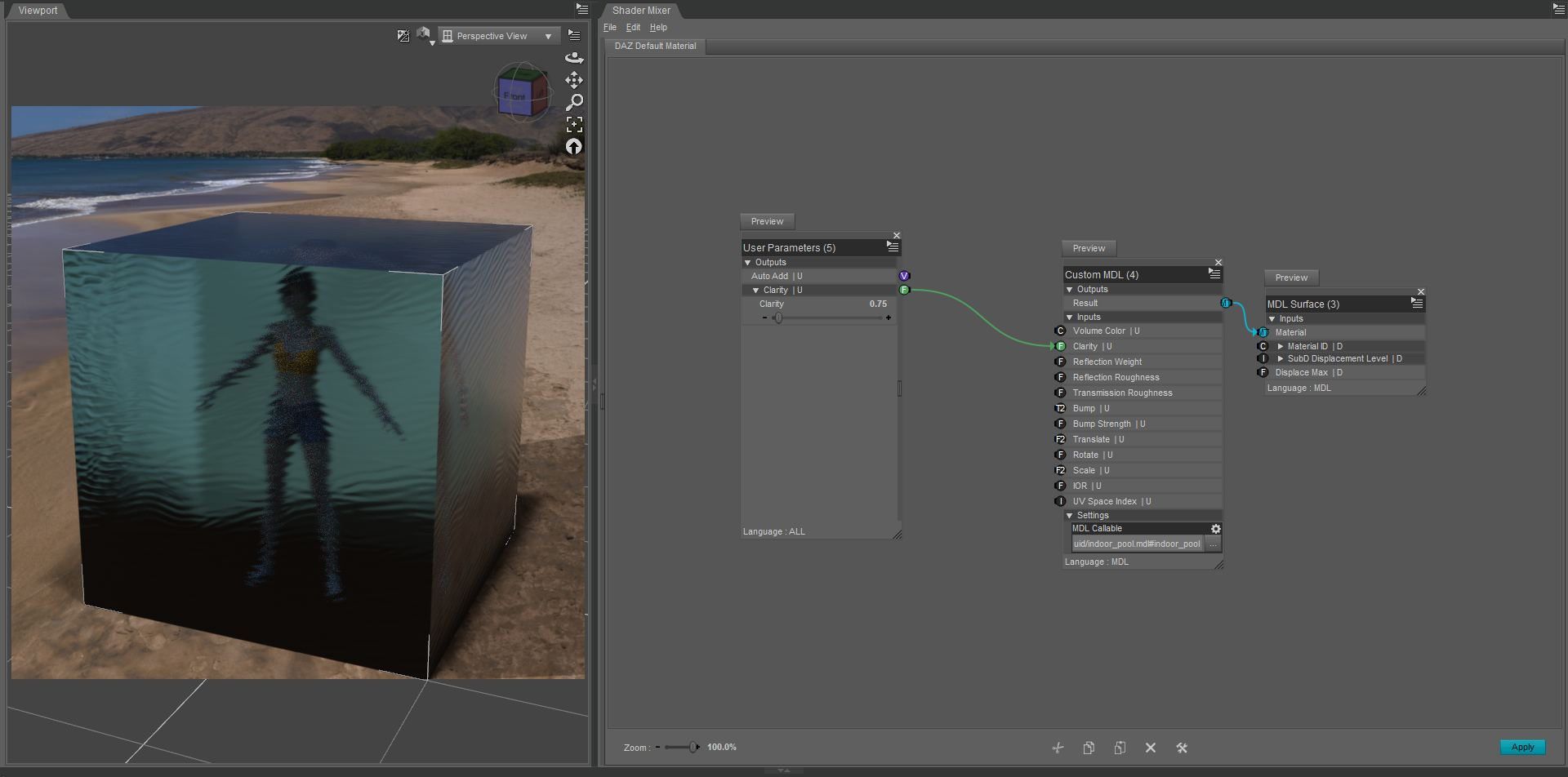

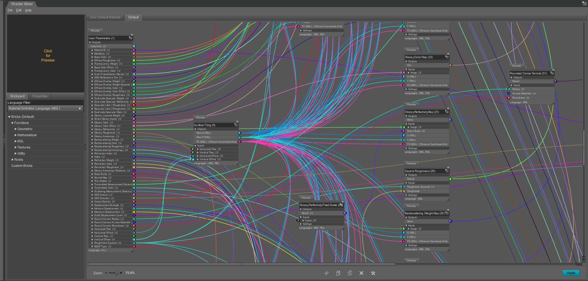

  • margravemargrave Posts: 1,822
    July 2021 edited July 2021
    I didn't manage to replicate your setup yet, but I was playing around with the nodes in Functions -> MDL -> Material Editors alongside the Add Thin Film node, and I found out how to mix materials together. "Weighting" seems to be Daz's equivalent of Blender's "factor", the float/black and white map that determines which areas of a surface should be masked. By feeding two materials into the "Add Weighted Layer" node, I was able to successfully (?) mix them. This should be excellent for adding grunge.
    1920 x 945 - 434K
    Post edited by margrave on July 2021

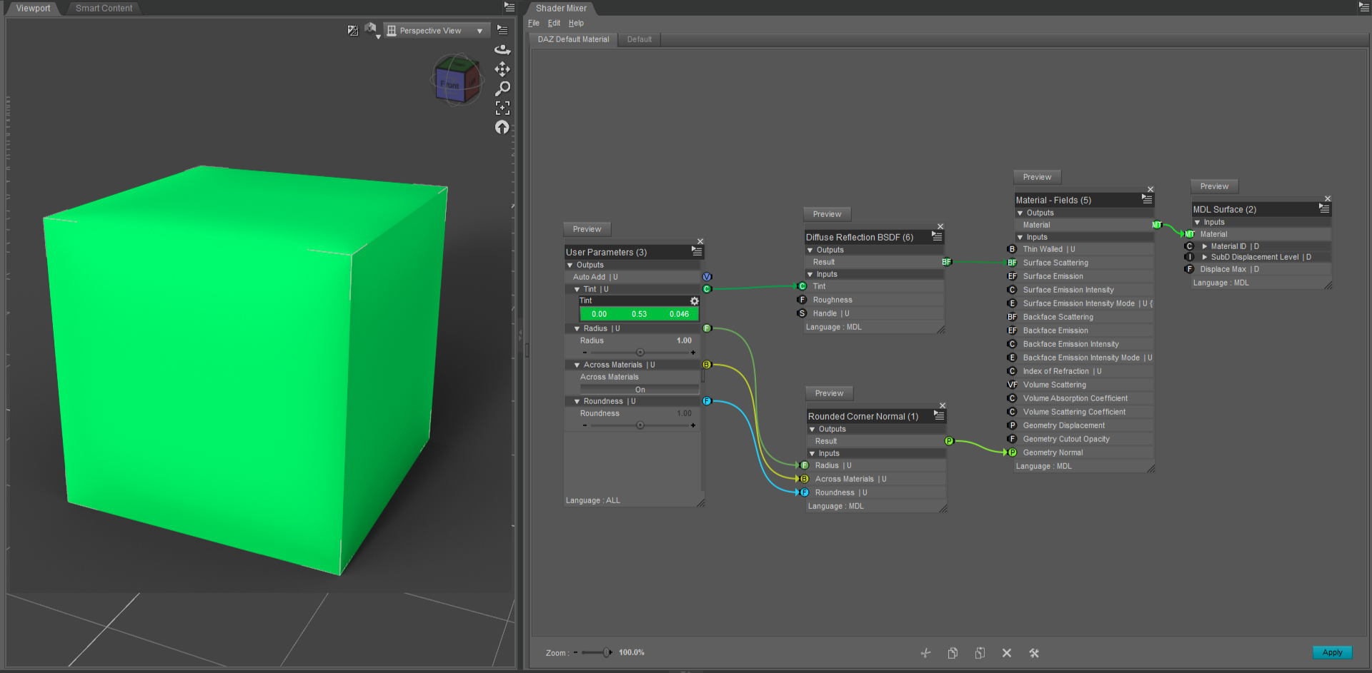

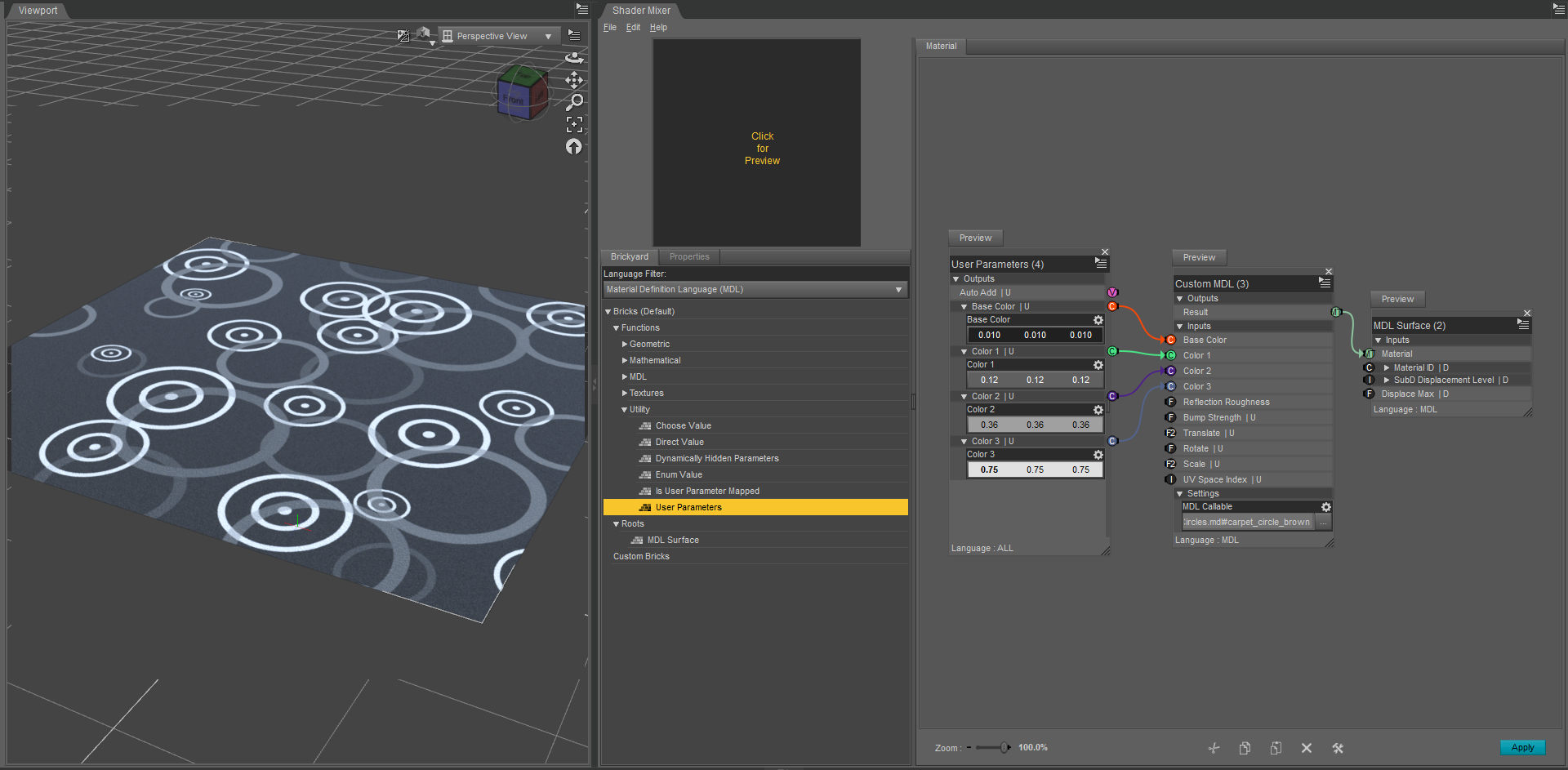

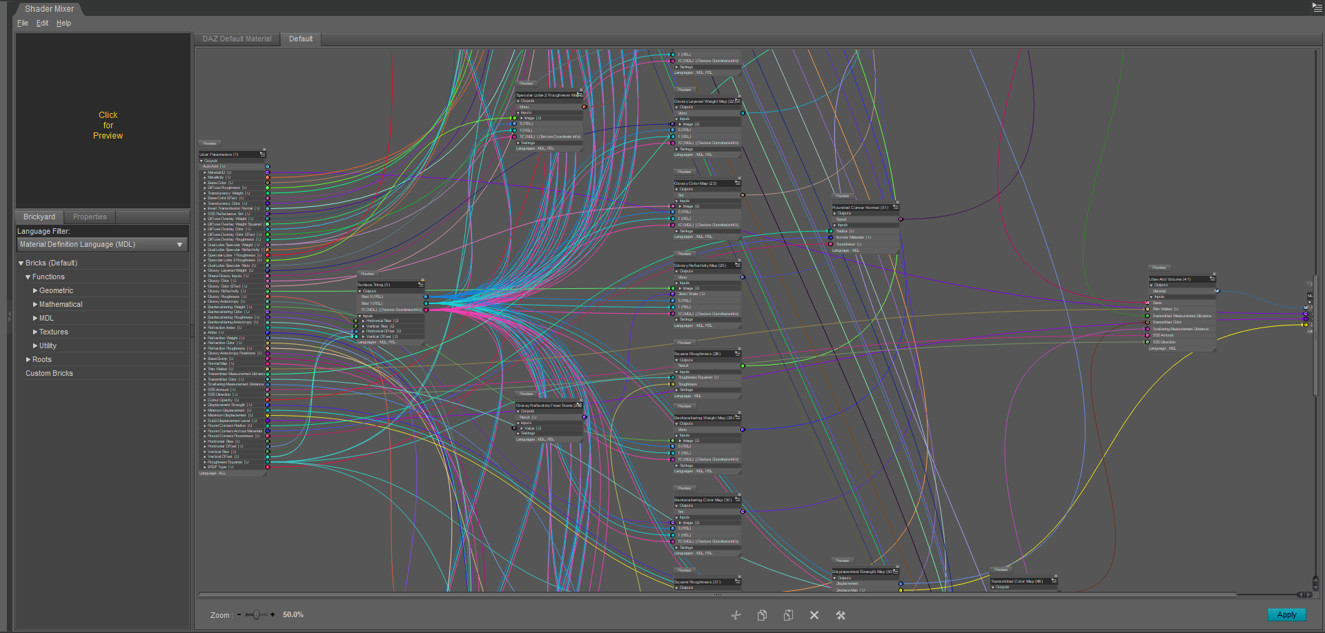

    Due to the paucity of Daz Shader Mixer tutorials, I decided to check out one for Substance Designer (Basics of creating an MDL in Substance Designer - YouTube). Since they both implement MDL, there's a lot of overlap in the two node systems.
    Here's a quick shader to blend between materials based on the fresnel value (i.e. the glare of sunlight striking a surface at an angle).
    In reality you'd use an IOR of 1.4 or something, but I jacked it up to 3.0 to make it more noticable.
    In Blender, you would just feed the fresnel value into a Mix Shader (which is an "Add Weighted Shader" in MDL terms), but it seems like MDL really leans on this "layering" workflow where materials are laid atop each other. They're mainly found in Functions -> MDL -> Material Editors. You can add dust layers, thin film layers, etc, and it seems like each one has its own specialized layering node instead of one multipurpose blending node like Blender.
    1920 x 942 - 388K

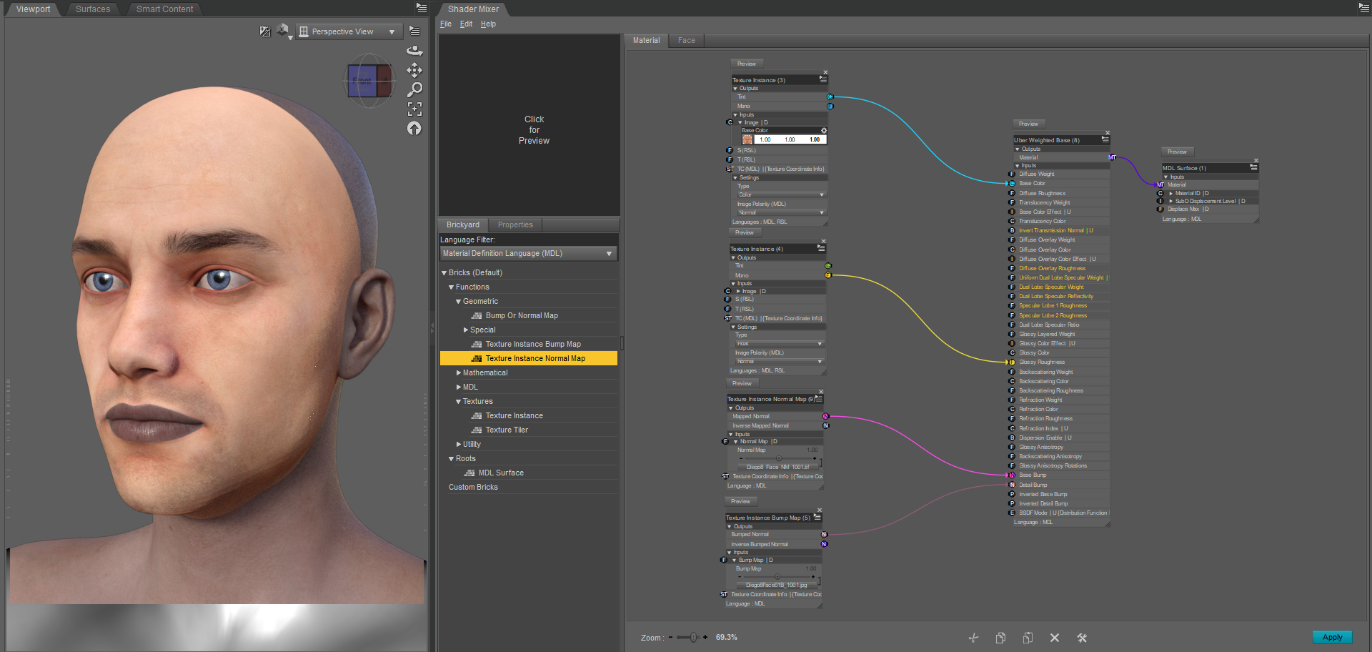

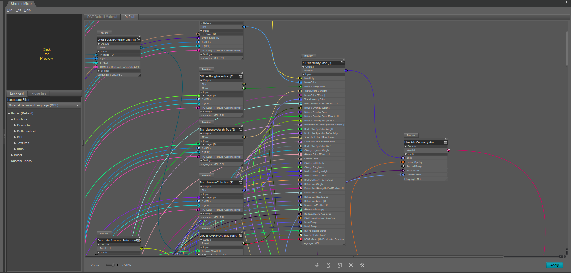

    Yep. In blender I like to set up my fake dispersion with IOR and spread inputs: You have your base IOR value and the Spread value gets added and subtracted from it in the red and blue chanels. You can do the same thing with with a color input but I find it less intuitive, and DS isn't all that good at handling color values that go above 1. on the other hand using IOR and spread doesn't allow the values to be asymetrical, which doesn't matter in blender as the entire set up in blender is much hackier (and vry liable to completely break physics)
    I did find an RGB combine equivalent in DS afer searching built ins>types>color>color 3 inputs
    1893 x 795 - 701K

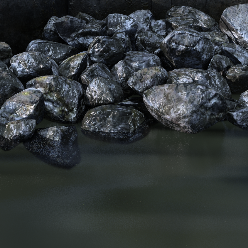

  • j cadej cade Posts: 2,310
    and some more renders of my experiments with chromatic IOR
    The blue one also has some volume, but the red one all the color is coming from the IOR
    I also didnt save anything for the first one and then crashed DS, so I need to add volume back in. But on tthe recreation I added a duplicate microfacet refraction shader - mostly so I can control the strength of the reflection slightly seperately from the refraction

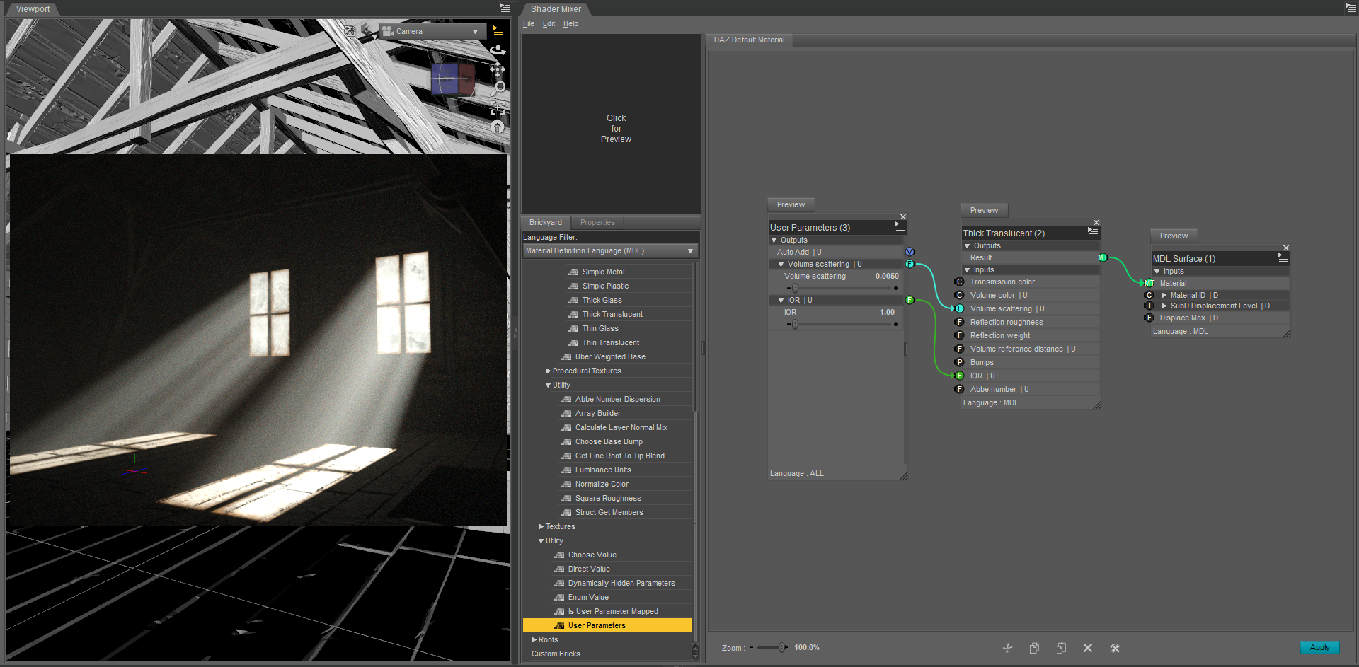

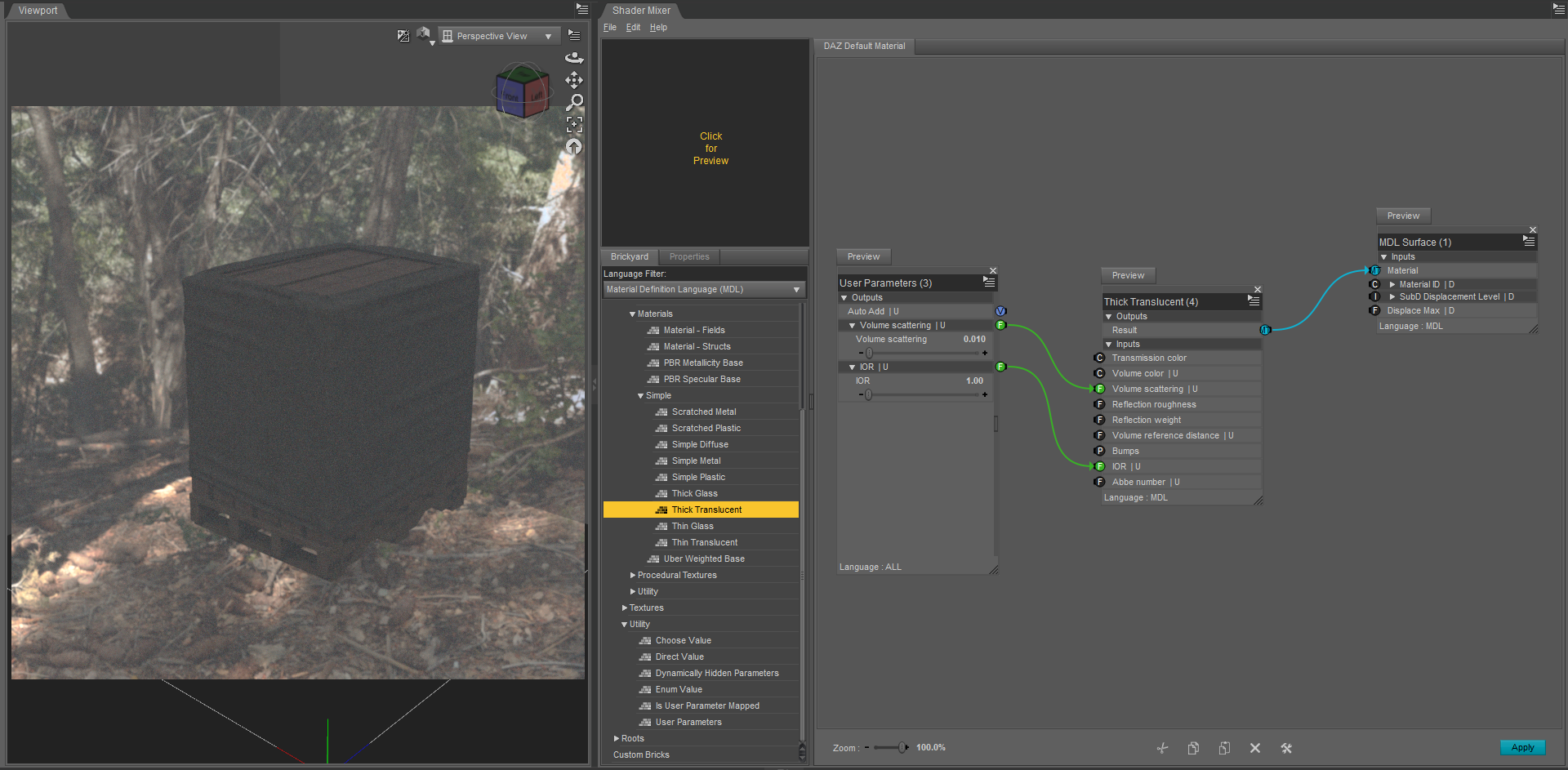

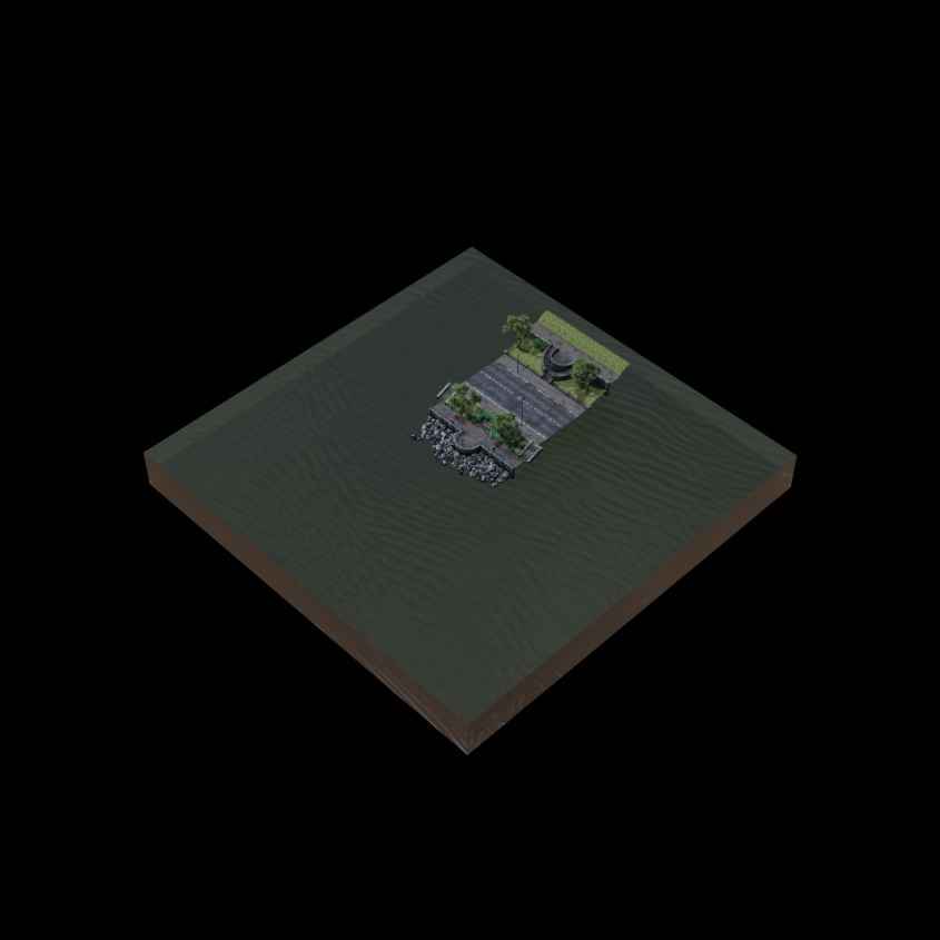

    July 2021

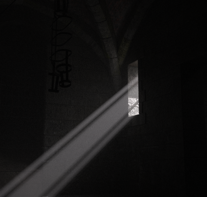

    Here's a render I did using the Thick Translucency block as a volume scatter node. I wish Daz had a smoke sim, so I could add some texture to it, but I still think it looks pretty good.
    It's entitled "In Search of Documentation: The Daz Experience".

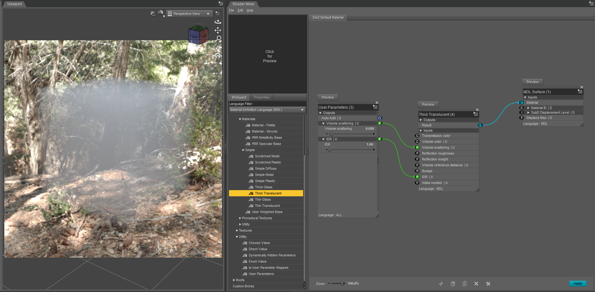

  • TirickTirick Posts: 236
    July 2021
    With this method does the camera still need to be outside the volume?
    July 2021
    Tirick said:
    No. You can have the camera inside the volume and it will still work.
    One caveat: if you make the volume larger than a default primitive cube, you will have to fiddle with the "Volume Reference Distance" as well as the "Volume Scattering". If it's too large, it'll be pitch black inside no matter what. "Reference Distance" seems to be a scalar that goes up as the scale of your cube goes up.
    July 2021
    Oh awesome! I should add Reference Distance then as a user parameter.
    July 2021
    Here's the doc page: 2.1.9 - Thick translucent (nvidia.com)
    You need to set the IOR to 1.0, which will make light rays pass through it without refraction. That's why the cube seems like it doesn't have any walls. Other than that, I haven't had a chance to look too deep into this node, specifically.
    I put together a simple shader using your guidelines. I added user parameters for color and volume distance. I might tweak it for the other settings. I'm quite curious how bump can effect it.
    This is seriously a game changer for my renders. I've strugged to with Godrays using other methods and this just... works. The fact that it is a true volume and not just a surface scatter makes all the difference.
    Thank you for sharing this process!
    717 x 682 - 608K
    Post edited by Tirick on July 2021

    It took me a while to figure this one out. The biggest stumbling block is that, for some odd reason, this does not work with Material - Fields. Even though they should be functionally identical, you must use Material - Structs to create a mesh light. I don't know if that's a bug or what.
    As it stands, the light needs an extremely high value in the "Intensity" socket. This one has about 10,000,000,000. I think there's a way to use the Luminance Units as a scalar, but I haven't found it yet. Looking at the emissive files from vMaterials, they seem to be determining emissive brightness based on calculations with Blackbody nodes and things like that. Haven't got my head around that part yet.
    Speaking of MDL, I located the MDL files implementing the Uber shader and the PBR Skin shader. They're in your main Daz installation folder, under shaders/iray/daz_3d. Be warned, they're big boys.
    1920 x 944 - 763K

    yeah. the only thing you can do is model complex shapes - there are some products in the store that do that for explosions and they doo look pretty good but proper heterogenous volumes will make stuff so much easier

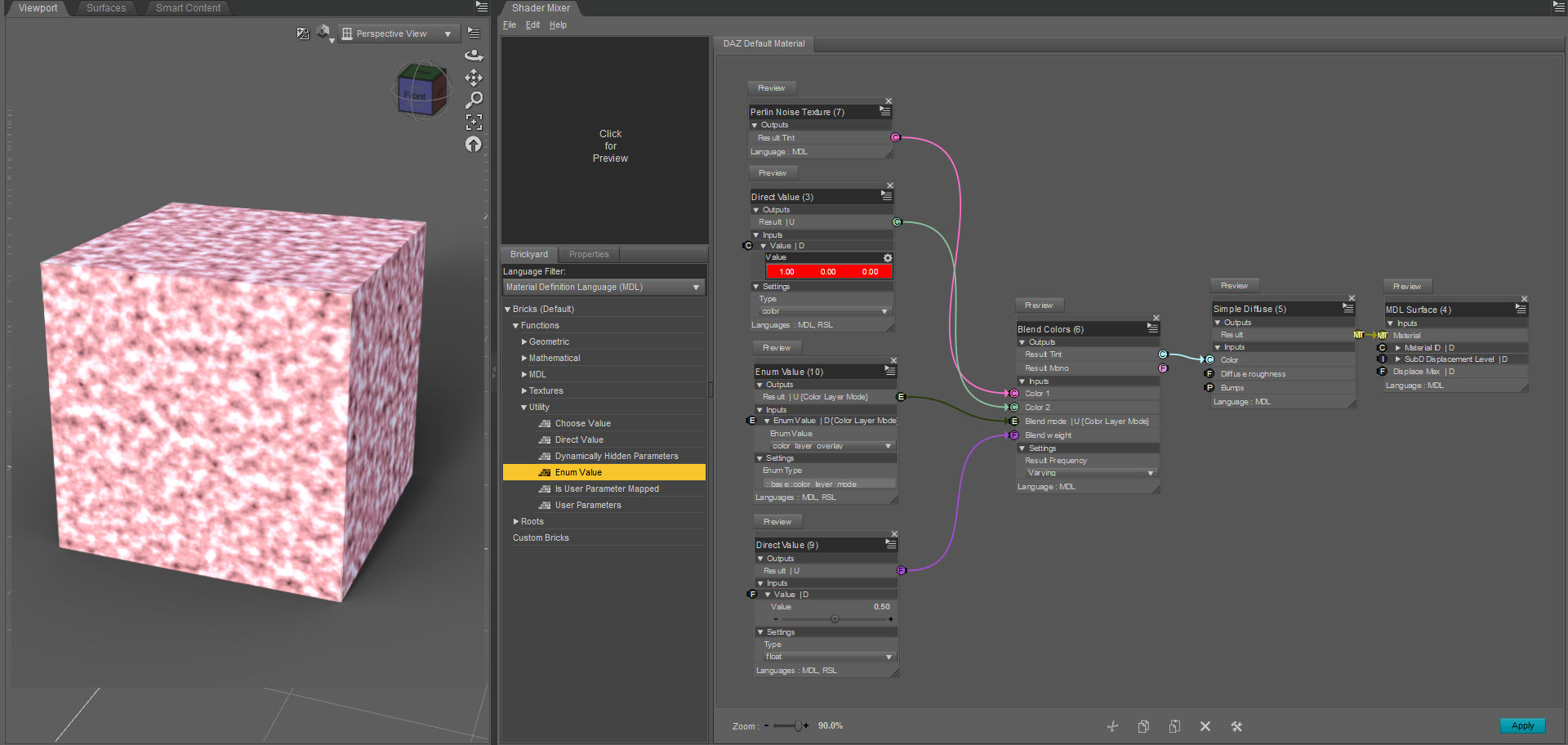

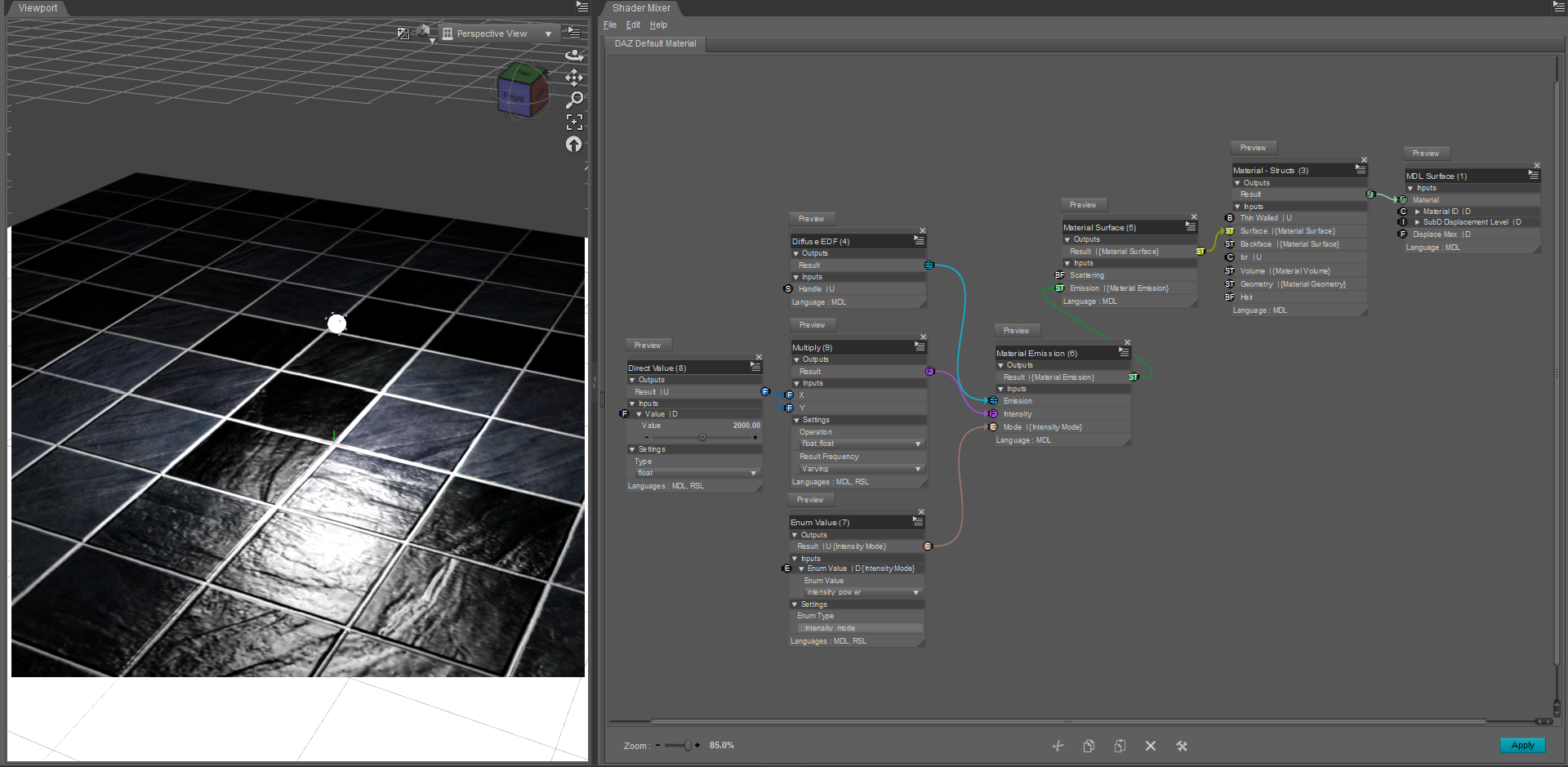

    Aaaaaalright, I'm stubborn and an old cheater :) Found out it's possible to connect a noise generator to the transmission colour output (the volume colour won't even take! smart design move on the DAZ part), so that then when you render the cube from the outside, you get this "overlay". It's basically equivalent to doing this in postwork, but it saves the hassle of saving out a render, opening gimp, yadda yadda.
    1000 x 1000 - 1M

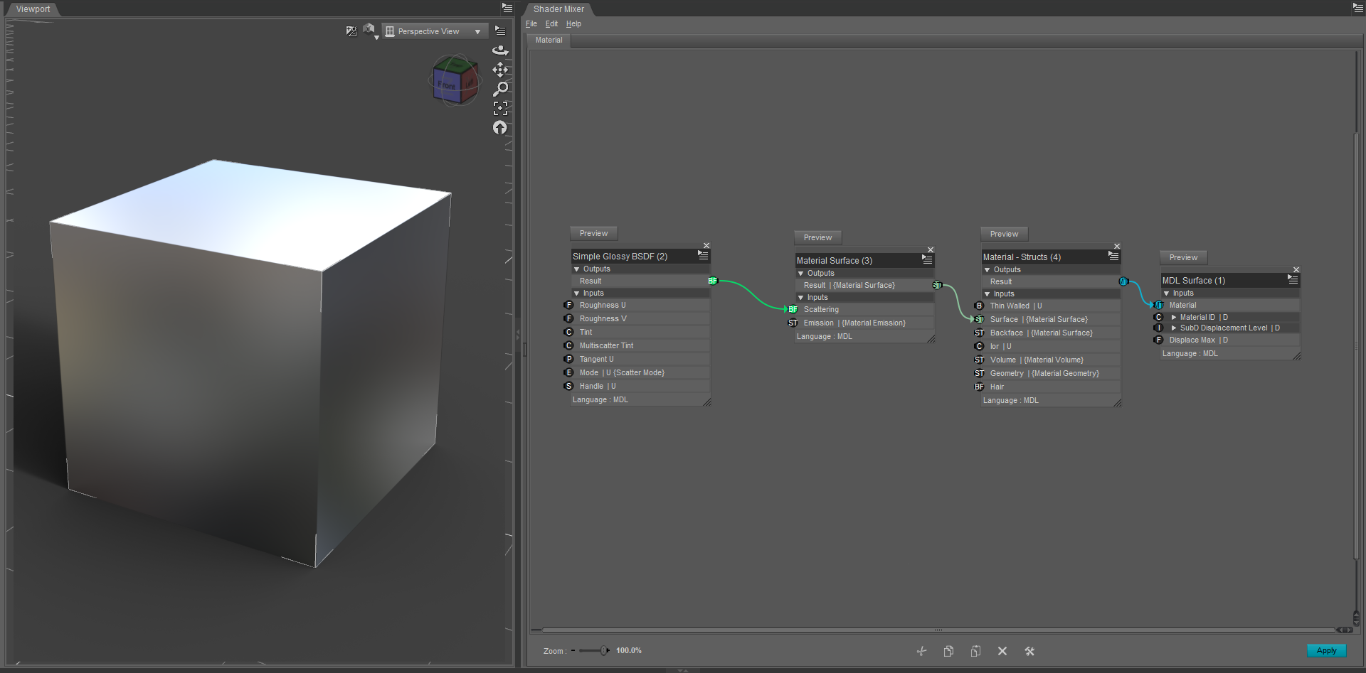

    And now emissive surfaces don't work at all, even though I have literally the exact same setup as last time?
    I seriously think emissives are bugged. I can't even load emissive shaders from vMaterials into a Custom MDL node.
    EDIT:
    Thanks to this post, Scene Only lights not working properly (SOLVED) - Daz 3D Forums, I discovered the culpit. My Draw Settings had defaulted to "Interactive (Biased)". While I did change it briefly yesterday, I definitely changed it back. So I'm not sure why Daz decided to use that as its new default, but...whatever. Emissives are working again.
    This time, I squared the intensity with a Multiply node, and now the lights are much easier to wrangle.
    1920 x 942 - 99K
    1920 x 939 - 700K

    Mesh smoke but I haven't tried playing with the shader mixer yet but could be used to improve it a lot I think. This is an interesting thread.
    1080 x 1440 - 2M
    1080 x 1440 - 913K
    Post edited by charles on July 2021

    margrave said:
    Godrays.
    Tonemapper's set to a Shutter Speed of 1, an f-Stop of 8, and an ISO of 800. Render Settings are set to "Scene Only", with a single yellowish Distant Light outside at 200,000 lumens. The fog shader was applied to a single primitive cube scaled up so it envelops the entire attic room.
    I'd love to know how/where you found the bricks (inputs) diagramed above (went through all the resources,but found nothing) ... could you maybe attach a file so we can play with this?
