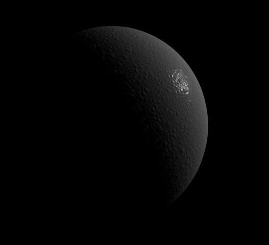

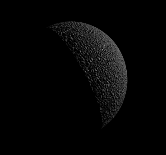

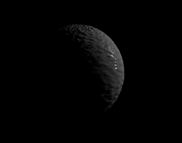

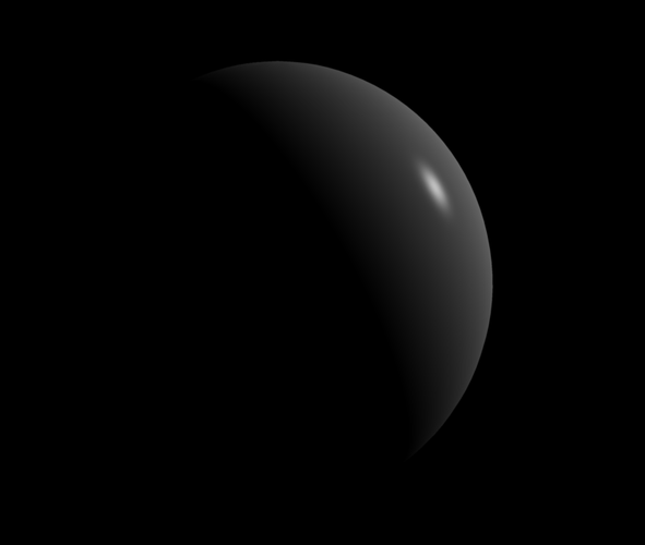

    I'm not sure what you're seeing Rashad, and you aren't to clear on whether you mean a concave surface, a curved wall or a sphere, so in my test it was easier to just insert a vertex sphere.
    With no bump, the surface has a nice graduated terminus. With a high amplitude bump, the graduation does indeed seem to disappear. With a low amplitude bum, the graduation is back as well as the bump.
    I know with your experience that you know how bump maps or bump functions generally work, but I'll give the crib notes version for people new to 3D and texturing.
    A bump function is an illusion. It is a grayscale function that tells the render that lighter areas of the texture are higher, and darker areas are lower. It does not actually change the underlying geometry of the object. Look at my reference images and you will see that even the sphere with the high amplitude bump has a smooth outer edge. It is a CG optical illusion.
    Displacement works in many ways like the bump function, except that it actually displaces the geometry and makes brighter areas of the displacement texture physically higher and darker areas physically lower. A higher density mesh or one that uses smoothing will work better if the displacement map/texture is highly detailed. It can take linger to render as well.
    The final image uses displacement. I copied the bump shader and pasted it into the displacement. I then had to reduce the intensity to around 5% as Carrara's displacement is pretty strong.

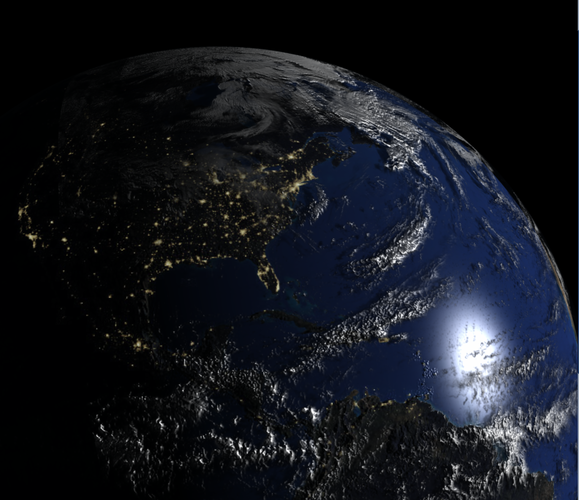

    So, going back to the bumps, I have an earth model that I built that uses maps by NASA. This uses the mid-resolution maps. The ocean has no bump, but the continents do. I have the level set at 100%. The same for the cloud layer. I have that set at 100%
    I see graduation of the terminus across the even the continents. I think that as the article that Cris linked to suggests, there are limitations and advantages for each method. An overly exaggerated bump will cause issues with the terminus not having a smoothly graduated surface. The earth image has a high bump value, but the resolution of the map, coupled with a well designed bump map produces a look that suggests mountains and other elevations without being overly strong in areas where there is less elevation.
    Edited to add that the cloud layer does have the sudden terminus, but that is probably because I didn't have a proper bump map and used the color map in the bump channel. I could probably lower it and have a smoother transition and maybe some more subtle cloud bumps.
    2000 x 1500 - 620K

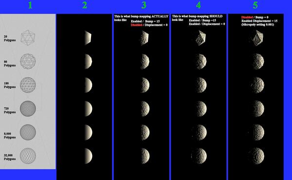

    Below is the file I thought I uploaded last night. There are five columns. On the far left is the wireframe and on the right are various renders. I should state that in Bryce 7 there is a bug with displacement mapping being off centered, which is why it doesnt get used very often in Bryce, still, it works fine for these examples.
    Column 2
    Show the models with smoothing but no bump or displacement. **Keep in mind as well, that the very bottom sphere of 32,000 polygons does not have smoothing applied at all.
    Column 3
    Shows the way bump mapping actually works right now. Sharp terminus line. The exact location of the line seems to depend somewhat on the resolution of the underlying mesh.
    Column 4
    This is what bump should look like to my view. While there are some issues such as with the bottom two spheres allowing light from the illuminated side to penetrate all the way to the dark side of the sphere, still it avoids the harsh terminus line. In order to pull this off in Bryce, I had to enable Displacement, but to prevent it from showing I kept the power setting at 0. I have tricked Bryce into calculating the bump more accurately simply by introducing displacement to the material. In this case the micropolygons were created but they were given no height, so in theory , they should be as dark as the bump only renders on the unlit side of the spheres. But indeed, that is not the case and somehow the mere introduction of displacement has fixed the bump
    Column 5
    This is what displacement alone looks like. Notice that in this case smoothing actually has been corrupted along the entire surface of the model (this is true in column 4 as well) but still there is no harsh terminus. I never expected there to be a harsh terminus with displacement, but it is interesting to note that the displacement did corrupt smoothing in order for it to function at all. But with a decent resolution source mesh of 720 polygons, the displacement alone looks quite good aside from the mapping issues.
    Anyhow, this is an exhaustive study. Conducting these experiments in each of the various applications of Daz forums such as Bryce, Carrara, DS, Octane, LuxRender will provide different results, but all the results will be similar. This is an industry wide problem.
    I conclude from this test that in those renders (regardless of software) where we see bump looking the way it should it is probably only looking correct because displacement is also enabled...even if only to the slightest degree. If the same surface was rendered with displacement fully disabled it would likely show the harsh terminus caused by the bump.
    Being the nitpicker that I am, these tiny details tend to be the things I notice and that give away cg art compared to real photos. Even the big boys haven't quite figured this one out. I feel good at least knowing that displacement can help to solve it.
