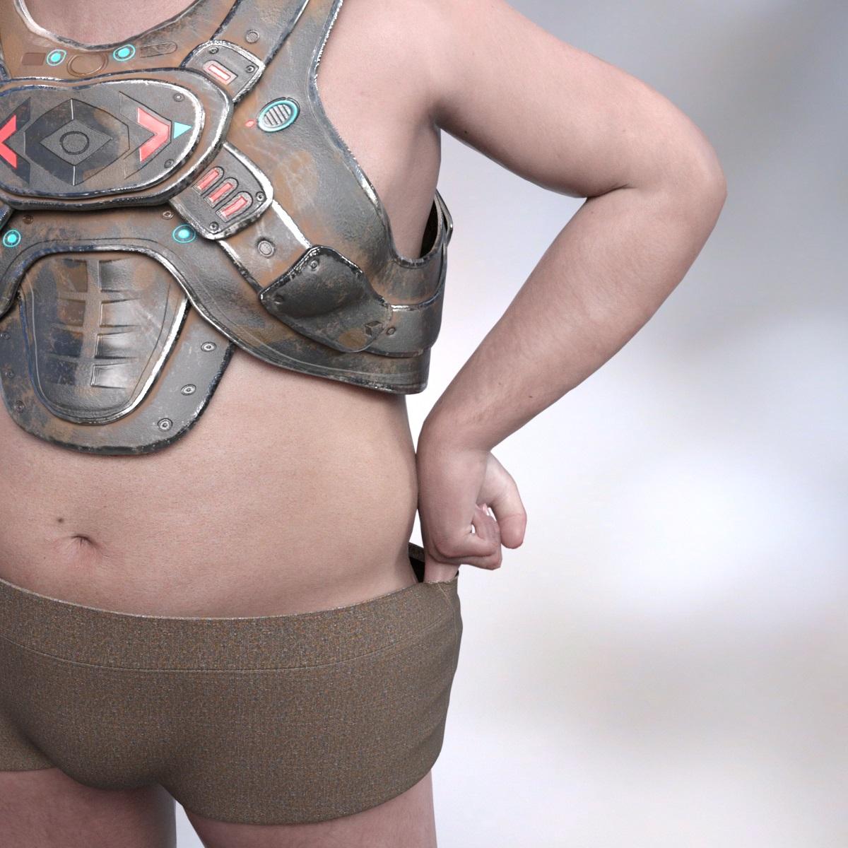

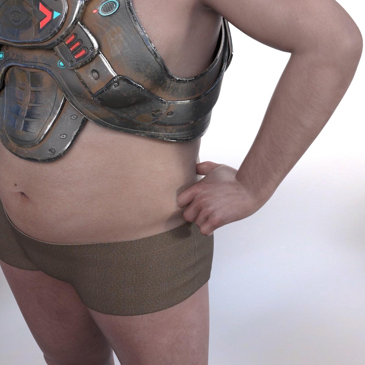

  • WillowRavenWillowRaven Posts: 3,787
    iwave said:
    WillowRaven said:
    What about other areas of the body that need to be affected by an object? Like the indent on the fore arm that resting it on a chair would make? Or the butt and thighs when sitting?
     Hi,
    To get the results you mentioned above, you just need to add smoothing modifier to your character. No additional tools are required.
    Thanks ... what if the body has to react to multiple elements?

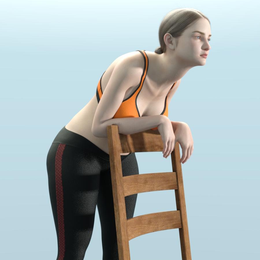

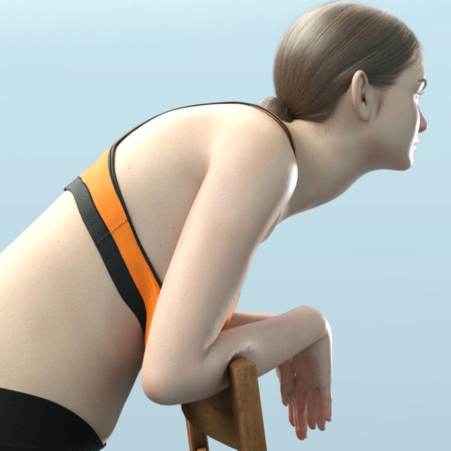

  • ArtiniArtini Posts: 10,903
    iwave said:
    Artini said:
    Ensley grasping Lovey Bear
    https://www.daz3d.com/ensley-hd--expressions-hd-for-genesis-8-female
    https://www.daz3d.com/the-lovey-bear-re-energized
    Hi Artini,
    Thank you very much for all the imaginative renderings, some of which I didn't even think ofyes
    Thanks a lot for the comments. The helper have just made possible to create a scenes with the subtle details, that was not possible for me
    to achieve by using different items only by itself.
