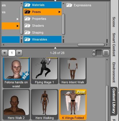

    Thanks. I saved the pose using the same settings (pic 1). Tried to load it and no luck.
    I think my problem may be the way I am loading the pose.
    1. Loaded Character.
    2. Added wings in neutral position. These wings are already saved as a Wearable Preset and sized, adjusted and parented to the character. Selected the wings in Scene.
    3. Went to Content Library / DAZ Studio Formats / My Library / Presets / Poses, and loaded the pose (pic 2).
    Is this where I'm going wrong? I wasn't able to read the details from your second screen print.
    412 x 421 - 30K
