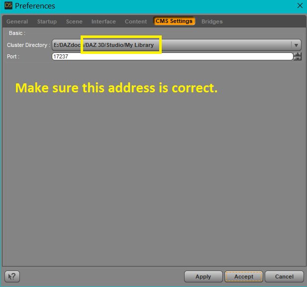

So Just downloaded the DAZ 4.15, but when I go to open it, I get a message saying it cannot connect to the CMS.  It also tells me to check my network (which is good,) my firewall and anti-virus (which I have on as allow apps.)  I even tried to login to DAZ through the Studio, and I get the same message again.  What am I doing wrong and could you please help me with this?
  • Messages I am recieving.
    Message when launching DAZ3D:
    A valid PostgreSQL CMS connection could not be established.  Several DAZ Studio feeatures that require a valid PostgreSQL CMS connection, such as context aware content views and loading content installed using DAZ connect service, will not be available.  Check your network, firewall, and anti-virus settings for conflicts.
    Message when I try to login:
    Connecting to DAZ 3D requires a valid connection to a PostgreSQL CMS database. A database connection could not be established.  Check for the following potential causes:
     PostgreSQL application files are not instaled, or not installed correctly.
     Anti-virus has quarantined  PostgreSQL application files.
     Firewall software/hardware is blocking the connection to PostgreSQL CMS.
     The Current user does not have permission to execute PostgreSQL application files.
    I don't log in via D/S however I know this address has to be correct for the connection to work.
    In Daz Studio:
    617 x 575 - 20K
    Post edited by Catherine3678ab on
  • Thank you, that did work!!  for some reason it was in my roaming app folder.

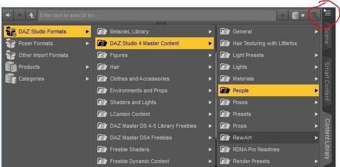

  • Is there a reason I have to reinstall all my product on to 4.15, is there a way to auto-import them from My Library folder?
    As installing a program does not affect the content, it should be wherever you saved it to in the first place. If the pathways telling D/S where to look for content are set properly then it should be finding it. [Content manager/director from the hamburger menu on the Content Tab]
    That being said, apparently there's something of a confusion with regards to installations being made via DIM and Daz Connect so if you used one of those methods then somebody else has to guide you through the process.
  • Hamburger menu?  I have no idea what that means.
  • MelanieLMelanieL Posts: 7,867
    edited June 2021
    This thing at the top corner:
    692 x 340 - 47K
